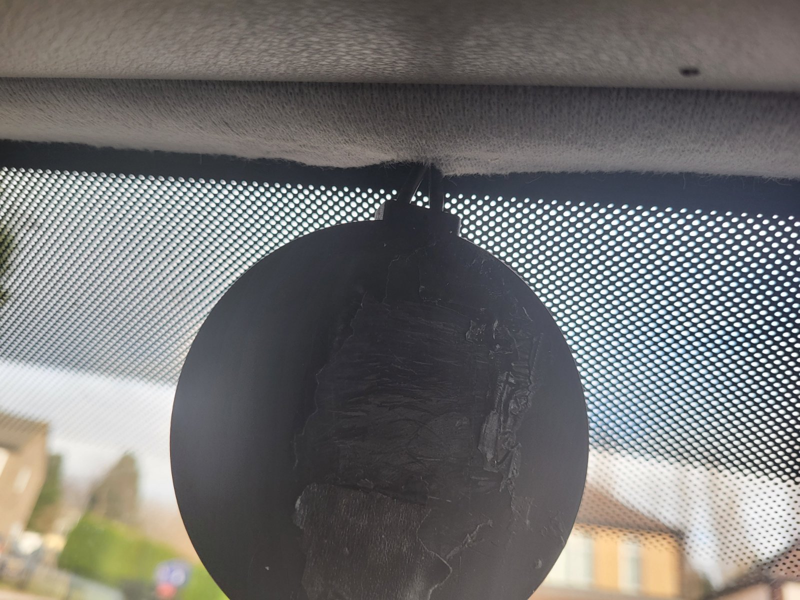

While I'm on does anyone know what the round black thing is at top of windscreen
Is that related to mic/bluetooth slipped my mind earlier
Cheers

@shawstvs: Which is another thing that black disc may be - have a look at the other side and see if you can find any holes which may indicate some body has wired in an aftermarket mic before.
