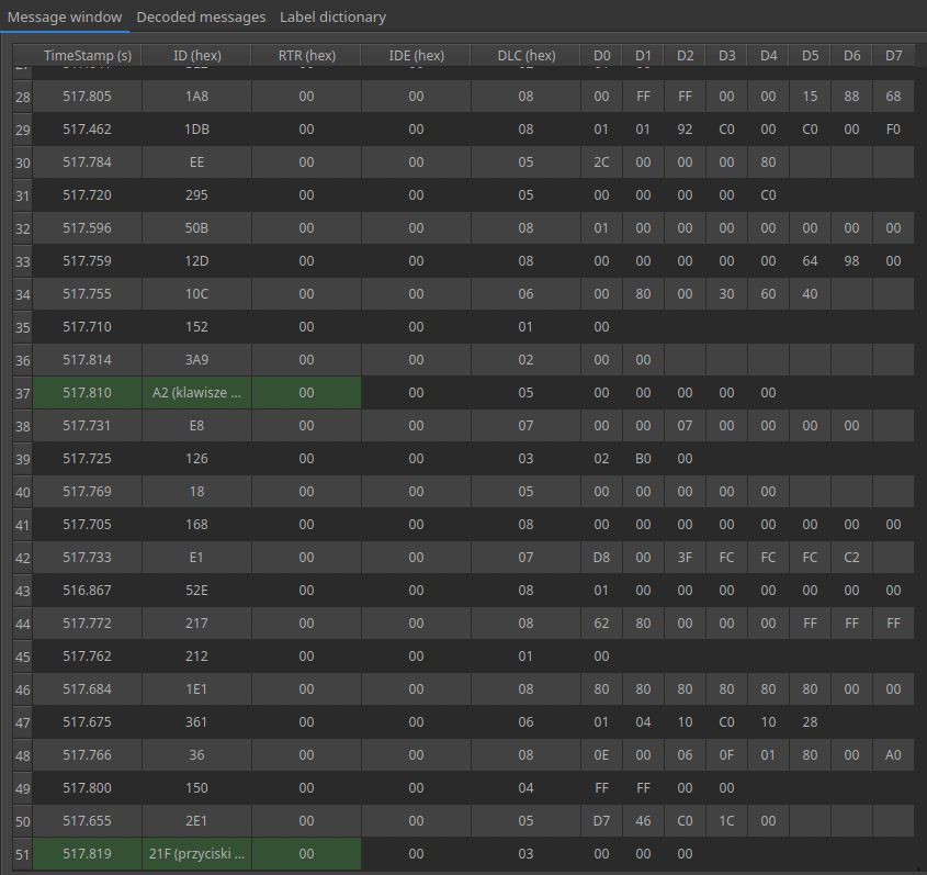

In OBD2 connector are no CAN 125kbps pins, so I connected to the FAKRA connector of the NG4 radio (pin 10 and 13). Now I'm starting to decode the IDs. I need it to start writing code for the ESP32.
If anyone is interested in details and a list of decoded IDs, I will be happy to help! When I finish the project, I will post information here.
Thank you for your invaluable help!
Here is a small sample (ID description in Polish, later will be in English):
