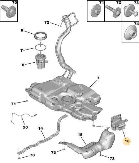

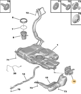

Re: Picasso II 2015 (B78) Adblue fault after refill
You do have a DPF with additive system, shown at (16):
Eolys additive system is entirely separate with different functions from the SCR system:
DPF and Eolys additive to trap & burn off particulate matter via regeneration,
SCR (Selective Catalytic Reduction) system to further treat NOx emissions.
I think it's only some specific later vehicles that have a DPF without the Eolys additive system. My Aircross has a DPF but uses no additive system. It does have separately the SCR system with Adblue as well.
Yes, the above is the fuel tank shown with the additive reservoir next to it at (16).
My own vehicle is a 2020 and has the 1.5 HDi engine and this particular variant has no additive system for the DPF. I cant advise of models with and without the additive reservoir without knowing the VIN for a check, but I suspect that it will not be 2.0-engined versions.
