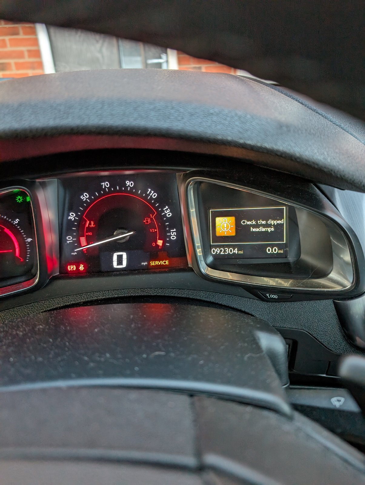

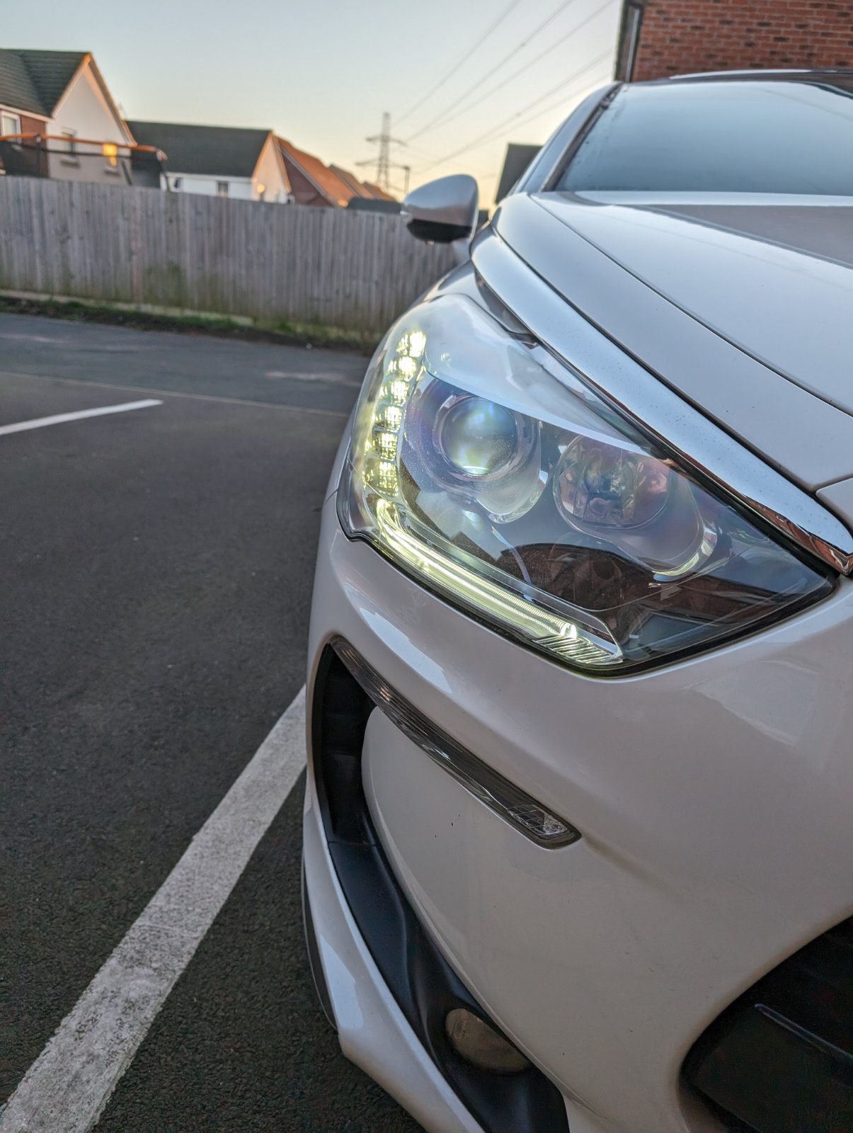

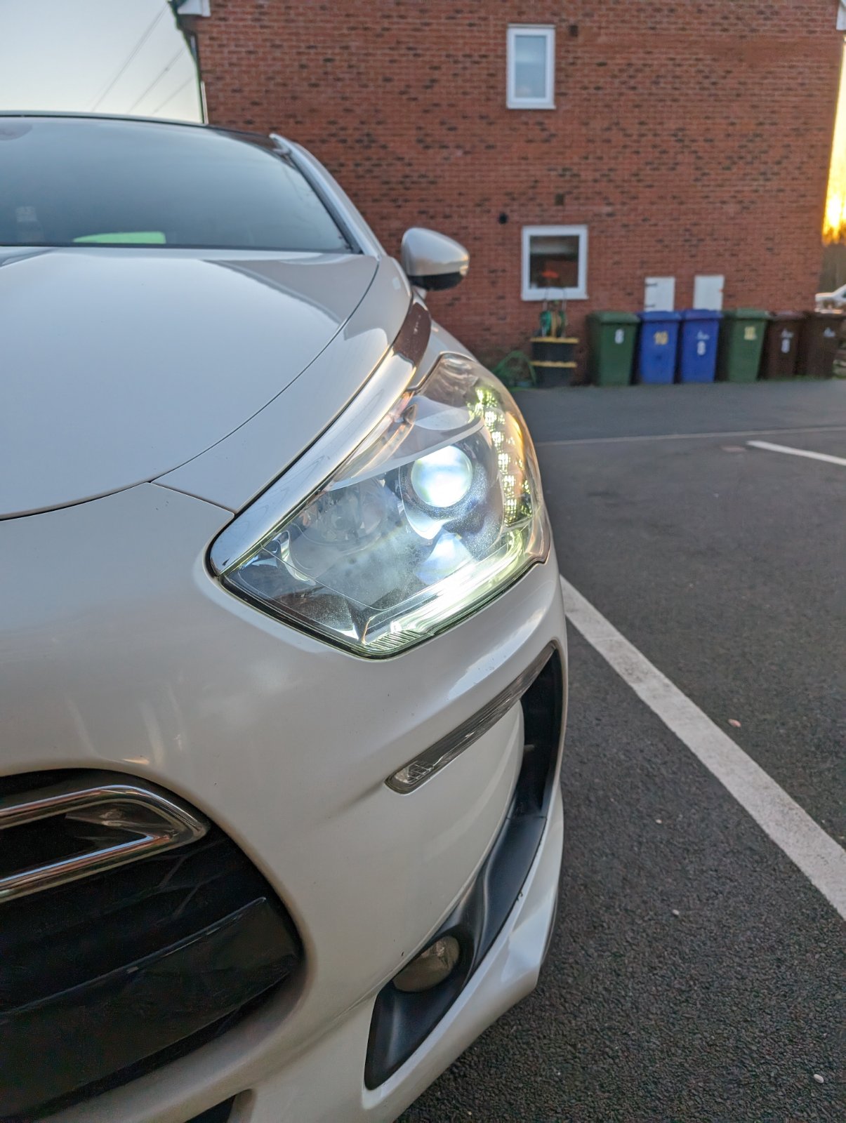

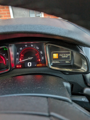

Hi guys. Hoping you can help. Have a ds5 2015 plate 1.6.
Had an orange service light come up on my dash this morning and stay on. There was a notification in the panel to the right saying 'check dipped headlamps' Got home checked my lights and it seems drivers side headlamp is out. Passenger side still working.
I've checked the handbook and it gives mes different lights to use based on if I've got Xenon headlamps or halogen ones.
How do I know which headlamps I actually have? As I'm not great with cars?
Is this something that could be done myself? Or does it need to be taken to a qualified dealer? Not sure how difficult it is to change one of these dipped headlamps?
Also with the orange service light being is that the only fault just that one of my headlamps is out? It couldn't be anything else could it?
I've attached pics hoping you can help. Thanks

Pretty sure that's an HID (Xenon) lamp, but stick up the vin (it will hide itself) and we can check.
Most likely the service light is only associated with the bulb, but you will only know for sure once the bulb is changed.

Yes, those are Xenon’s but there are several variations, but they are recommended to be changed in pairs.

Ok, I stand corrected - I was going to ask if that was your actual car as it is showing a projector lens type which are generally only used with Xenon-equipped vehicles, which after confirming with the VIN you do not have.
It seems the bulbs they are using is a "Premium xenon Style" bulb behind a projector lens, so they are in fact halogens fitted to your vehicle.

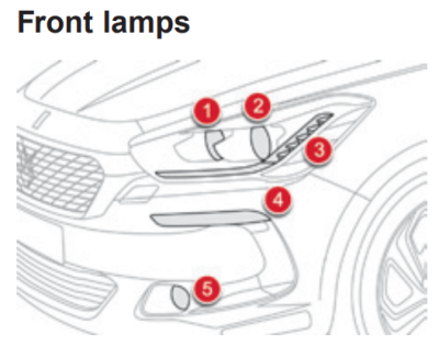

What is my main beam? I have my daytime running lights (the ones that run down the side of the main headlight) which are fine, the notice on my dash said 'check dipped headlamps' so I don't actually know if it's just the dipped headlamps that have gone or the main beam too? Is the main beam the one where you flick it in case of fog and the light on dash turns blue?GiveMeABreak wrote: 09 Jan 2024, 23:00 Your Dipped Beam Headlamp bulbs are H7 and your Main Beam bulbs are H1 - so don't mix them up.
The H7 ones linked above are ok, but they won't be very bright - because the emphasis is on lifespan rather than improved lighting. Again, your choice, so depends on what you are trying to achieve - a basic replacement or an equivalent or improvement on your existing bulbs.
If your H1 Main bean is working, there's not need to change them unless you want an upgrade, but those H1s are also fine for your Main Beam bulbs if you need them.
Remember, whichever bulbs you buy, NEVER touch the bulb with your bare skin when fitting. Always wear latex gloves or similar to avoid getting oil from your skin on the bulbs, as this can shortlen the life of the bulb.
Sorry buddy I feel like an idiot I've not got a clue, I'm not sure if you can tell from the pics I uploaded of which bulb is actually out, the dash info is telling me its the dipped lamps so I can only guess it's those.

I think you need to have a read through your owner's manual - all the info is there.
1. Main beam headlamps (H1).
2. Dipped beam headlamps (H7).
3. Daytime running lamps / sidelamps
(LEDs).
4. Direction indicators (HY21).
5. Directional foglamps (H11).
I can't advise as to which bulb you need if you don't know which one has gone.
Just switch the headlamps on and activate main beam, then get out and take a look at which bulb is not working - that will tell you as per the diagram.
No, the mainbeam is switched on for distance lighting (never when there is fog). Main bean is switched on when you pull the lighting stalk forwards and switched off when you repeat, but are indicated when the blue lamp is on in the dash. You use Fog Lamps for the fog.Is the main beam the one where you flick it in case of fog and the light on dash turns blue?
