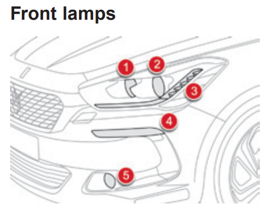

What is my main beam? I have my daytime running lights (the ones that run down the side of the main headlight) which are fine, the notice on my dash said 'check dipped headlamps' so I don't actually know if it's just the dipped headlamps that have gone or the main beam too? Is the main beam the one where you flick it in case of fog and the light on dash turns blue?GiveMeABreak wrote: 09 Jan 2024, 23:00 Your Dipped Beam Headlamp bulbs are H7 and your Main Beam bulbs are H1 - so don't mix them up.
The H7 ones linked above are ok, but they won't be very bright - because the emphasis is on lifespan rather than improved lighting. Again, your choice, so depends on what you are trying to achieve - a basic replacement or an equivalent or improvement on your existing bulbs.
If your H1 Main bean is working, there's not need to change them unless you want an upgrade, but those H1s are also fine for your Main Beam bulbs if you need them.
Remember, whichever bulbs you buy, NEVER touch the bulb with your bare skin when fitting. Always wear latex gloves or similar to avoid getting oil from your skin on the bulbs, as this can shortlen the life of the bulb.
Sorry buddy I feel like an idiot I've not got a clue, I'm not sure if you can tell from the pics I uploaded of which bulb is actually out, the dash info is telling me its the dipped lamps so I can only guess it's those.

I think you need to have a read through your owner's manual - all the info is there.
1. Main beam headlamps (H1).
2. Dipped beam headlamps (H7).
3. Daytime running lamps / sidelamps
(LEDs).
4. Direction indicators (HY21).
5. Directional foglamps (H11).
I can't advise as to which bulb you need if you don't know which one has gone.
Just switch the headlamps on and activate main beam, then get out and take a look at which bulb is not working - that will tell you as per the diagram.
No, the mainbeam is switched on for distance lighting (never when there is fog). Main bean is switched on when you pull the lighting stalk forwards and switched off when you repeat, but are indicated when the blue lamp is on in the dash. You use Fog Lamps for the fog.Is the main beam the one where you flick it in case of fog and the light on dash turns blue?
