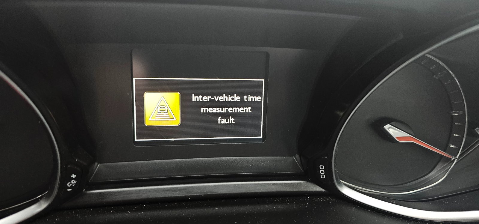

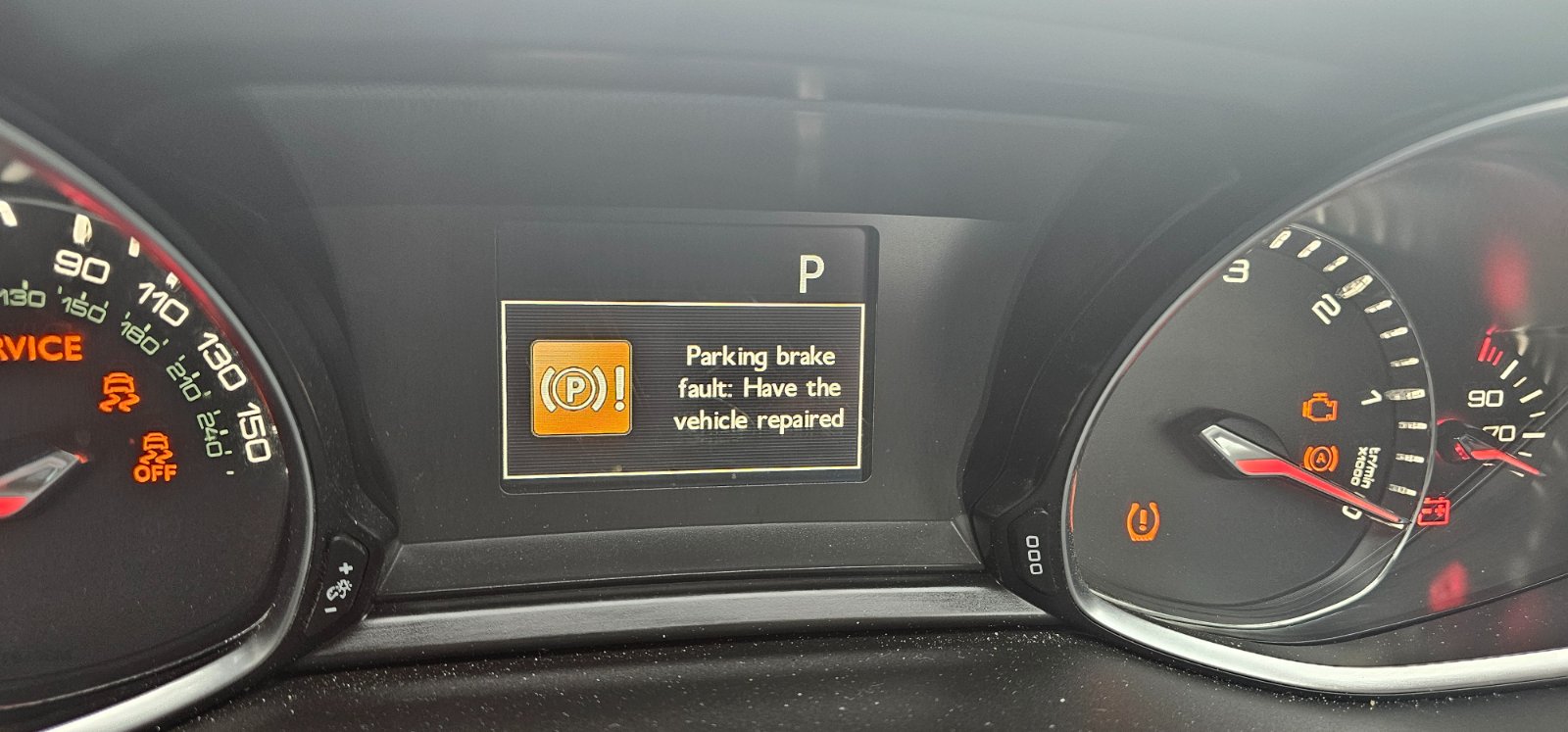

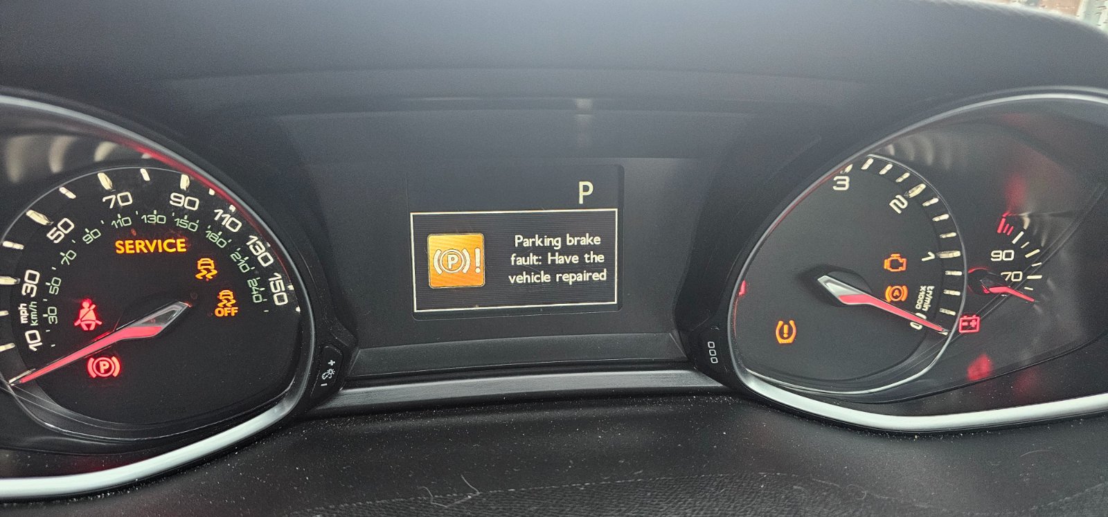

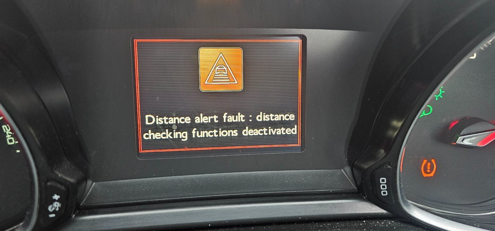

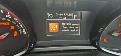

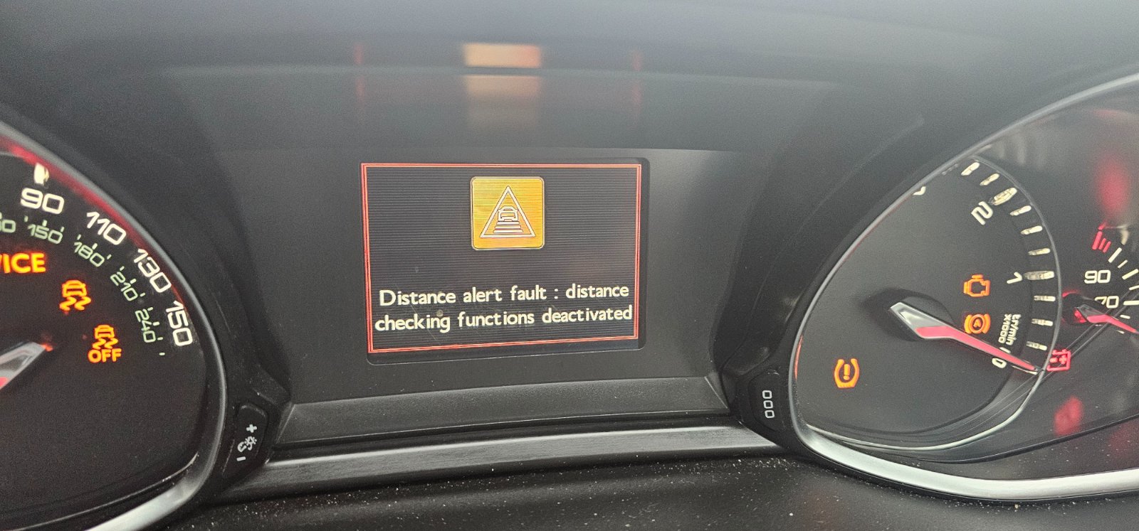

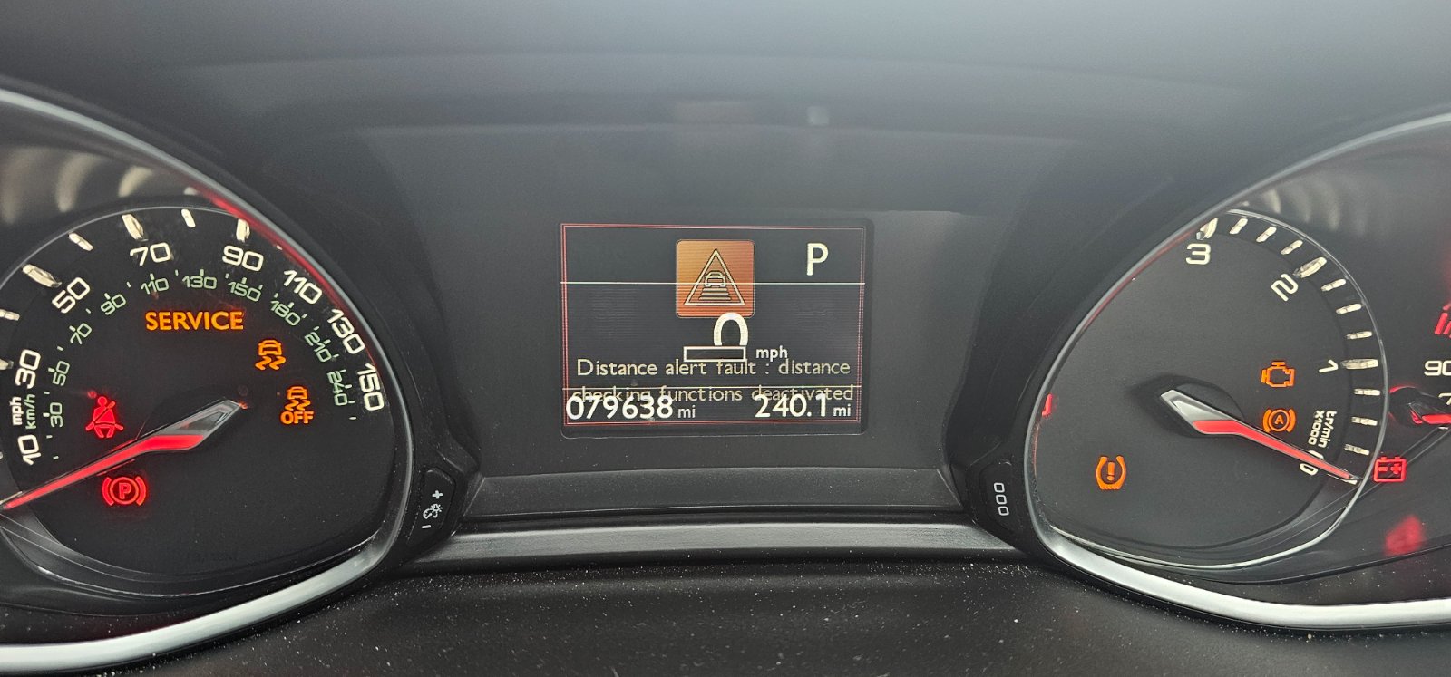

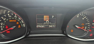

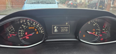

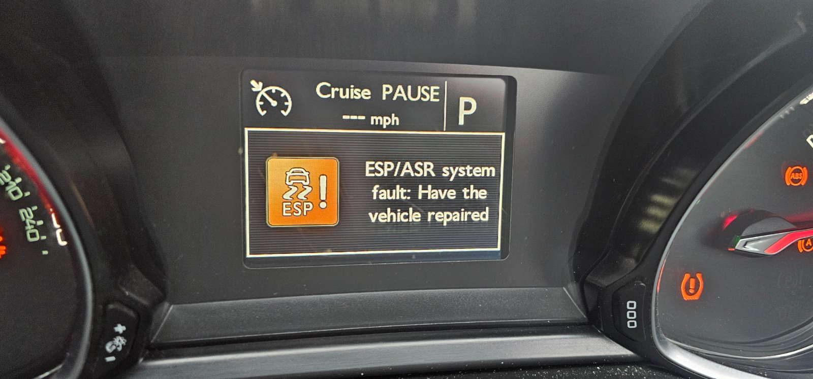

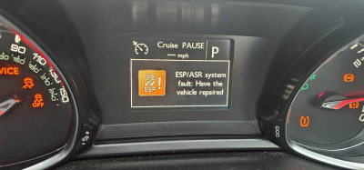

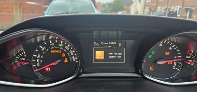

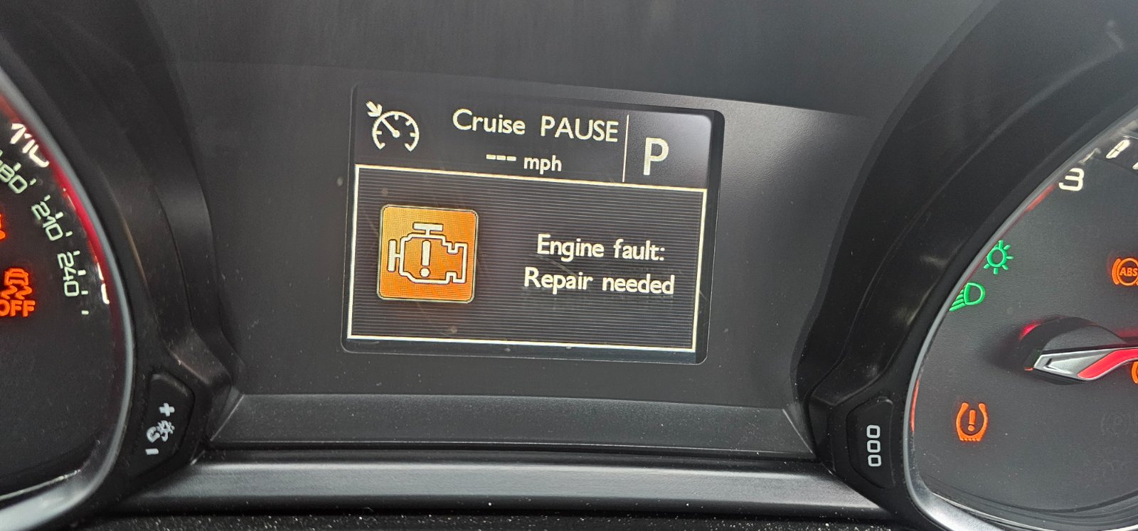

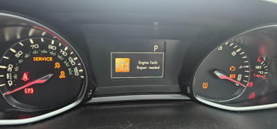

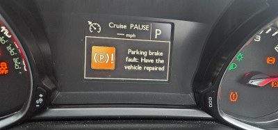

Hi I have a 2016 308 gtline sw

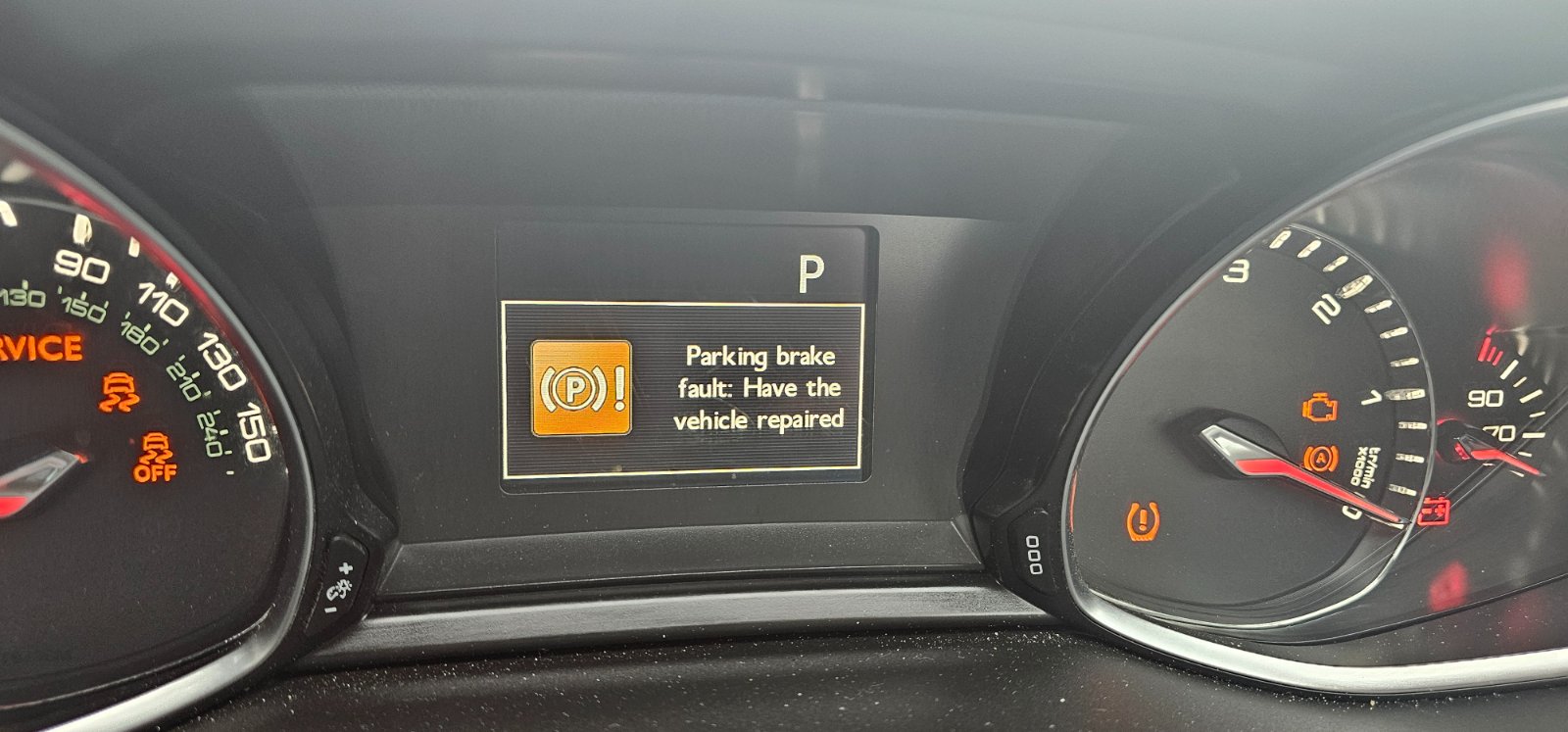

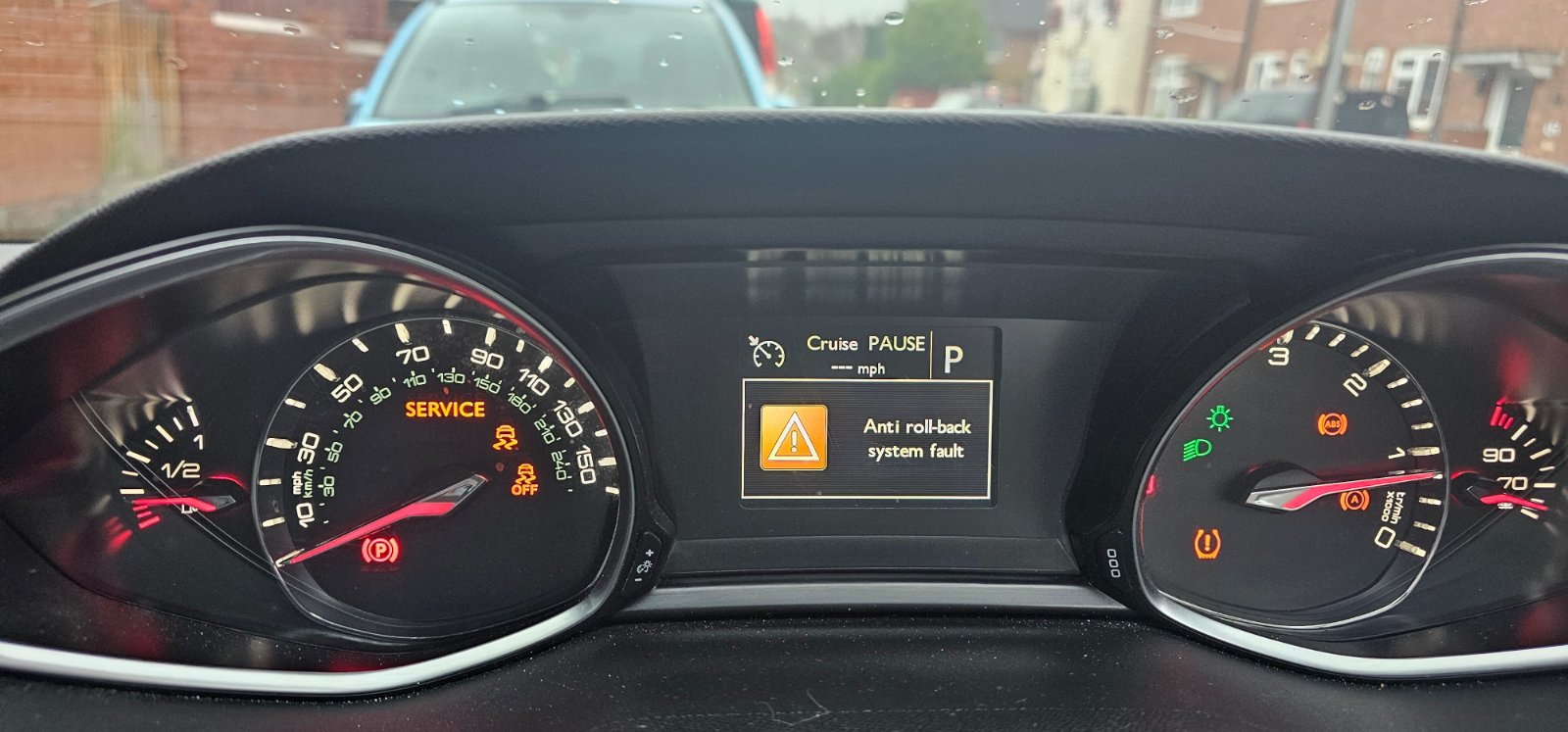

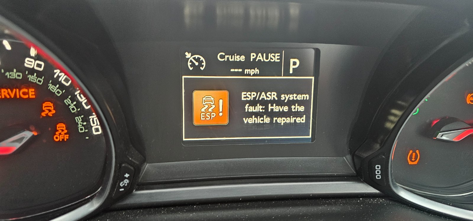

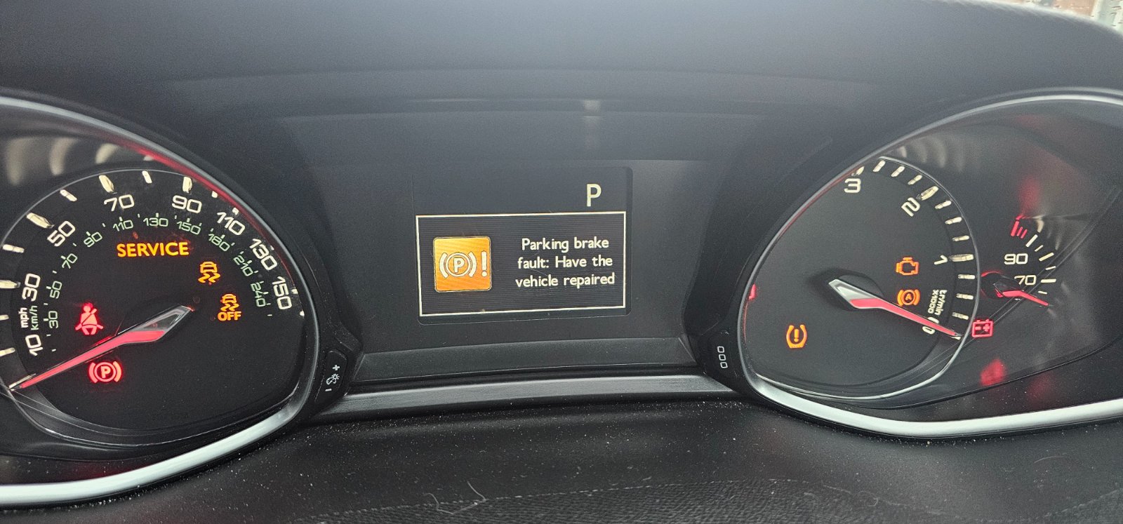

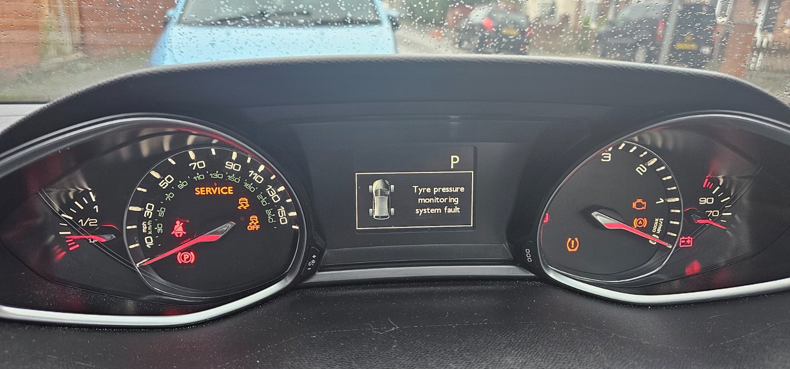

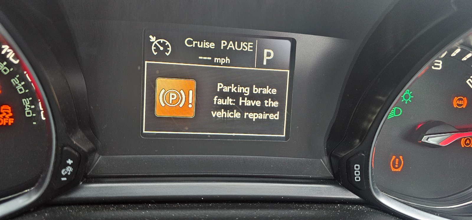

My question to the group is my dashboard is like a Christmas tree atm due to abs speed sensor that was diagnosed with rac. (New battery fitted )
Does the loom for rear right abs sensor go through the whole car then plug into the wheel abs sensor. I've confused as some come with a loom connected to them and some don't. My understanding is that due to this error on my dash it's abs sensor fault
Abs speed sensor fault

All these faults can be related to to the ESP system as they are all reliant on the vehicle wheel speed sensors. I had a similar issue recently on my Aircross with similar messages.
As for the harness, all these models except the 2021 P5 have the wheel speed sensor on a smaller cable that plugs into the main loom.

Thank you for yoir swift replay and appreciated very much OK. I was confused as some show with additional cable and some don't. So was not sure if front needed additional cable or that rear was the same. Mine does not have park assist but does have cruise control. I'm not very good with cars and don't suppose you could point me in the right direction for parts. How did you go about resolving it.

IT's almost certainly as I've mentioned in my post above - all these faults are related to the ESP system - but specifically one or more wheel speed sensors are faulty.
The dealer will be able to replace the correct one and reset the fault codes - probably quicker and less faffing about.
