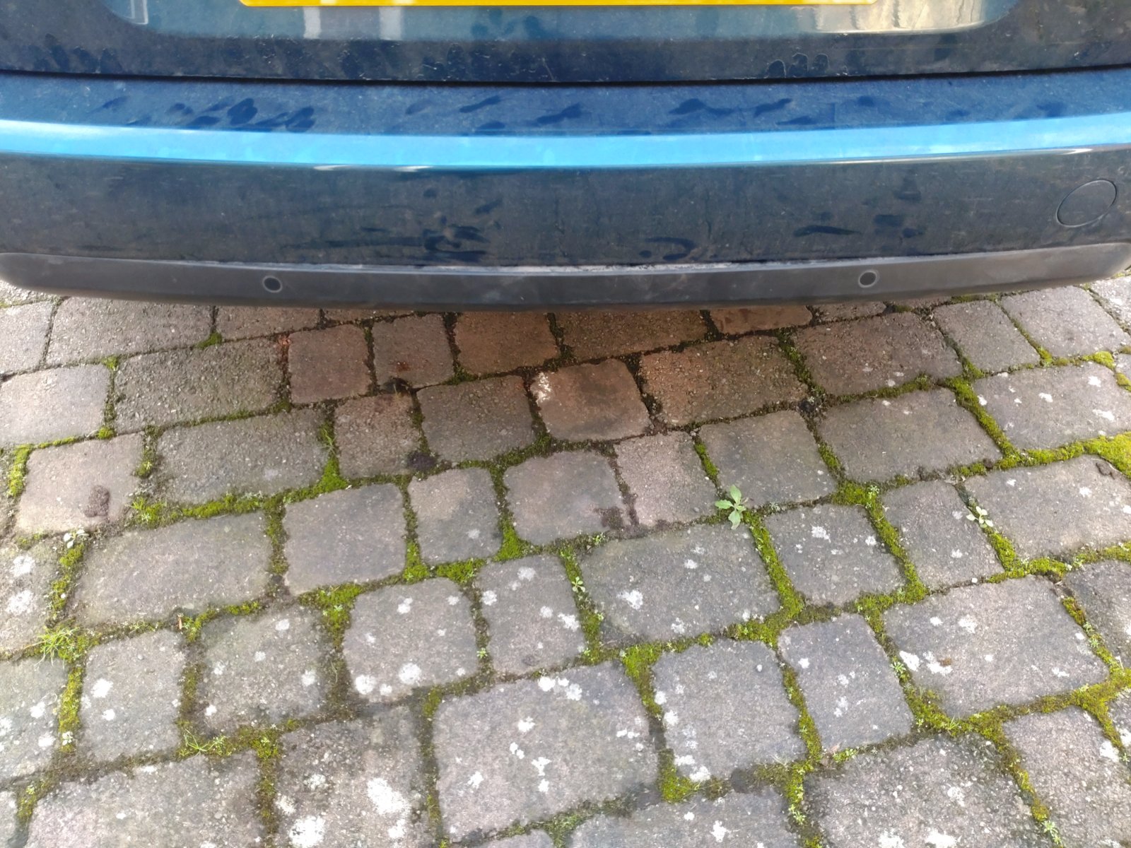

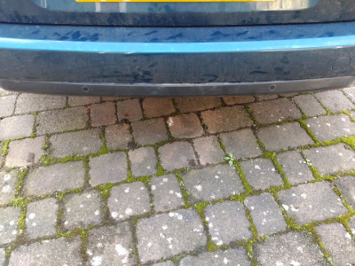

Attached a pic (excuse the dirt)
It is where the parking sensors are so it was the electrics holding it up so I'm not sure it will fly off but it may come loose again.

Re: Advice on 22 C4 Spacetourer
In this case, the obstacle sensor support called the rear bumper skirt (the lower part in your picture that holds the sensors) is held in by 2 bolts from the underside. These screw into the bumper angleplates. So either the screw (s) are missing or the surrounds of the trim are cracked and therefore not being secured.

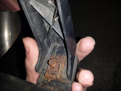

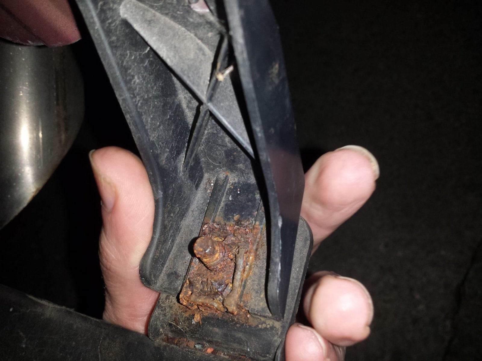

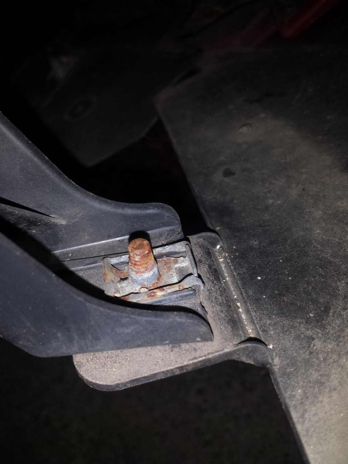

I can help here, I was checking the bumper brackets a few months ago and took photos. (2018 c4 grand spacetourer)
I was considering replacing the bolts as they seem to be rust prone parts.
But basically a bracket is attached to the chassis and bolt onto the bumper. In that picture the black plastic tab the bold goes through is the inside bottom edge of the bumper.
Not sure what the part number is or where to order them from.
I assume yours may have either come loose or rusted off or the tabs have snapped.
This was a more rusted one. This is looking down at the bracket as if I was inside the bumper while reaching underneath with my other hand.
They can take an impact though, I had an audi drive into the back of me a few weeks ago. Cracked his front bumper/grill and just left scratches on my bumper.
