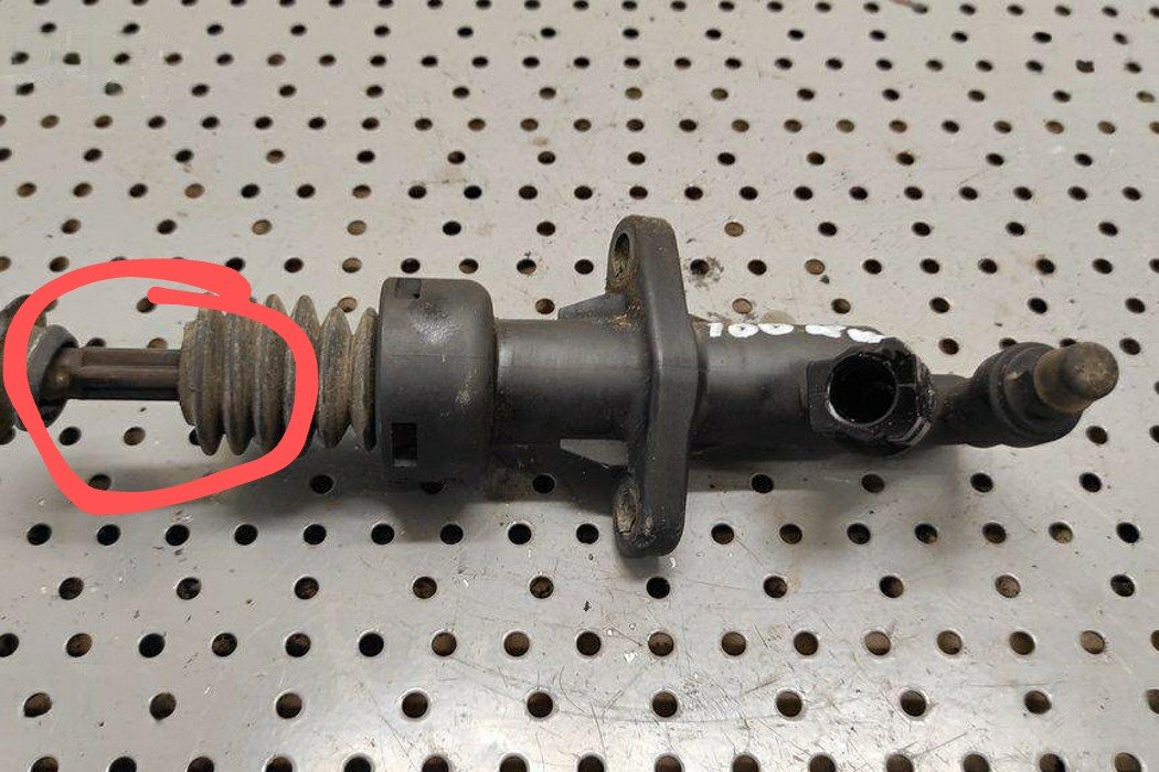

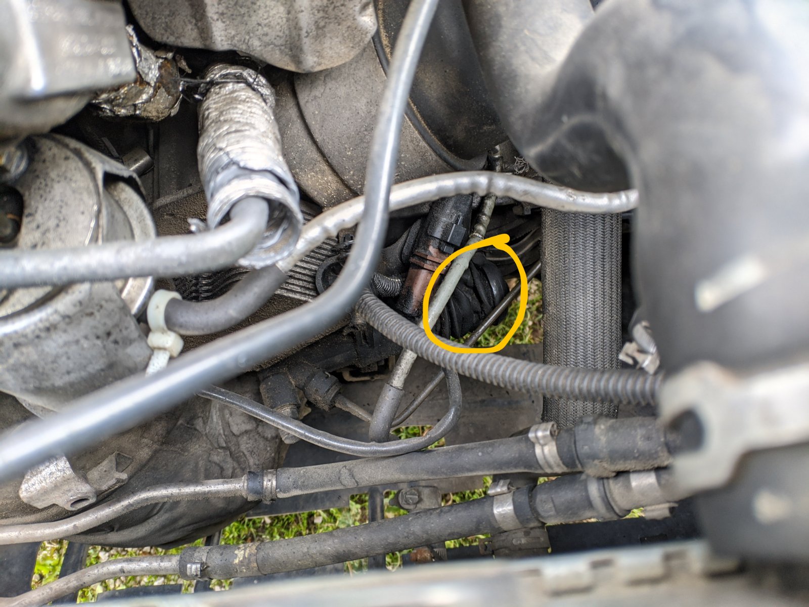

Vibration stops when you move this cylinder by hand..?

Check your bellhousing (engine to gearbox) bolts are tight...
Posts: 21255
x 8134
Re: 307 clutch pedal vibration..?
You shouldn't be able to move that by hand I don't think. Check its mounting bolts and Jim advises checking the bellhousing bolts too. :)

Not entire cylinder,I can move by hand just this part behind rubber.

Does the clutch operating arm move with the cylinder rod or just the rod?

mickthemaverick wrote: 03 Dec 2023, 07:48 Does the clutch operating arm move with the cylinder rod or just the rod?
Yes,everything is working as it should,no car vibrations shaking,nothing at all..
Posts: 21255
x 8134
I meant when you move it by hand?
