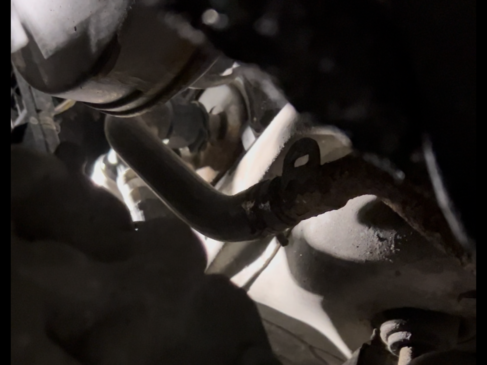

Does anyone have the parts number for this rusty coolant pipe?
In the left wheel well of a 2012 Peugeot 508 GT 2.2.
VIN VF3**************[VIN obfuscated, can be read by forum staff]
Parts number coolant pipe? Ruuuusty.

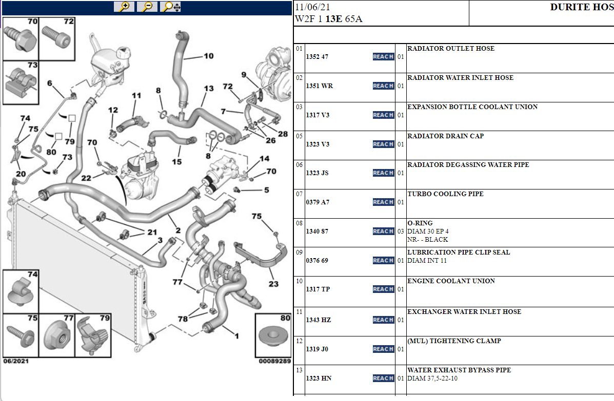

Re: Parts number coolant pipe? Ruuuusty.

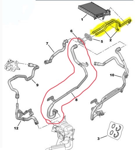

Here's the cooling system diagram:
Item 1, which is the bottom 'hose' seems to be the only near the LH wing. This is £160.06

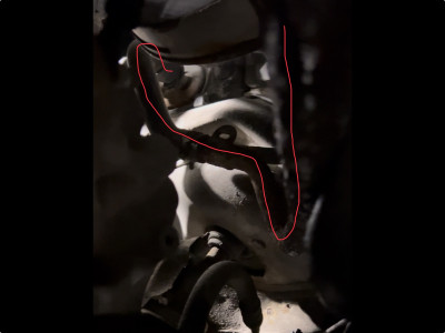

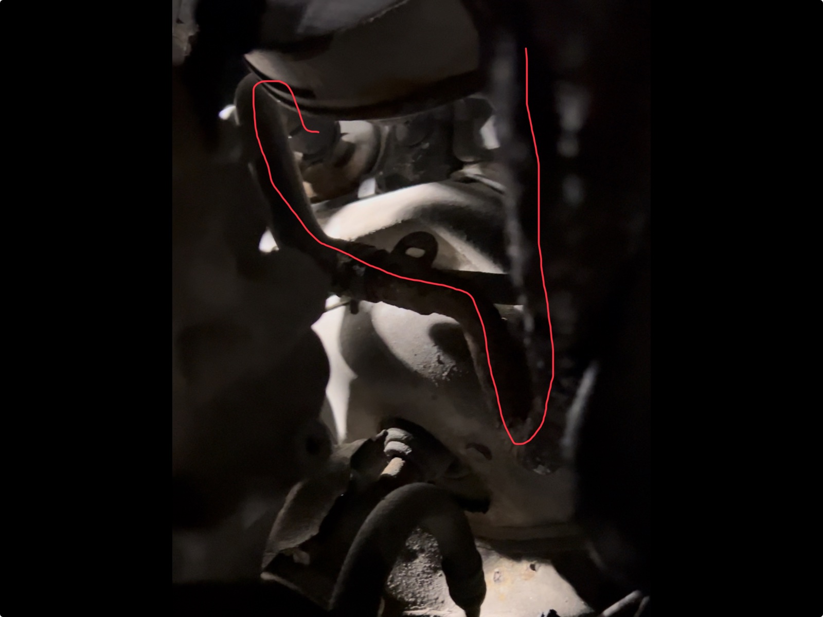

Although, it appears to have a webasto unit under the wing? it might be part of that. Need a better picture...
- x 6955
Yes, this one is fitted with additional heating Richard:

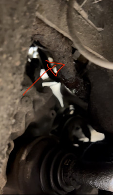

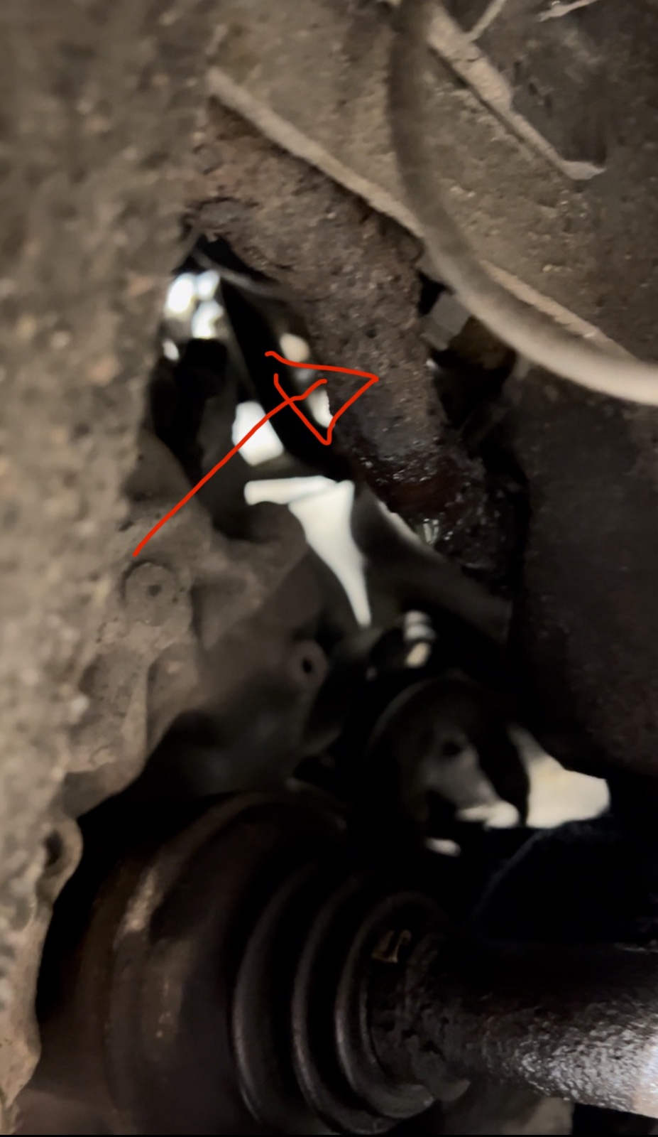

Looking back from the wheel well. Looks correct that it’s coming from the webasto and in to the heater core (?).

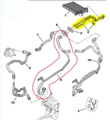

Number 8 here maybe?
I’m driving the car daily so I would like to get the pipe before I’ll take it apart..

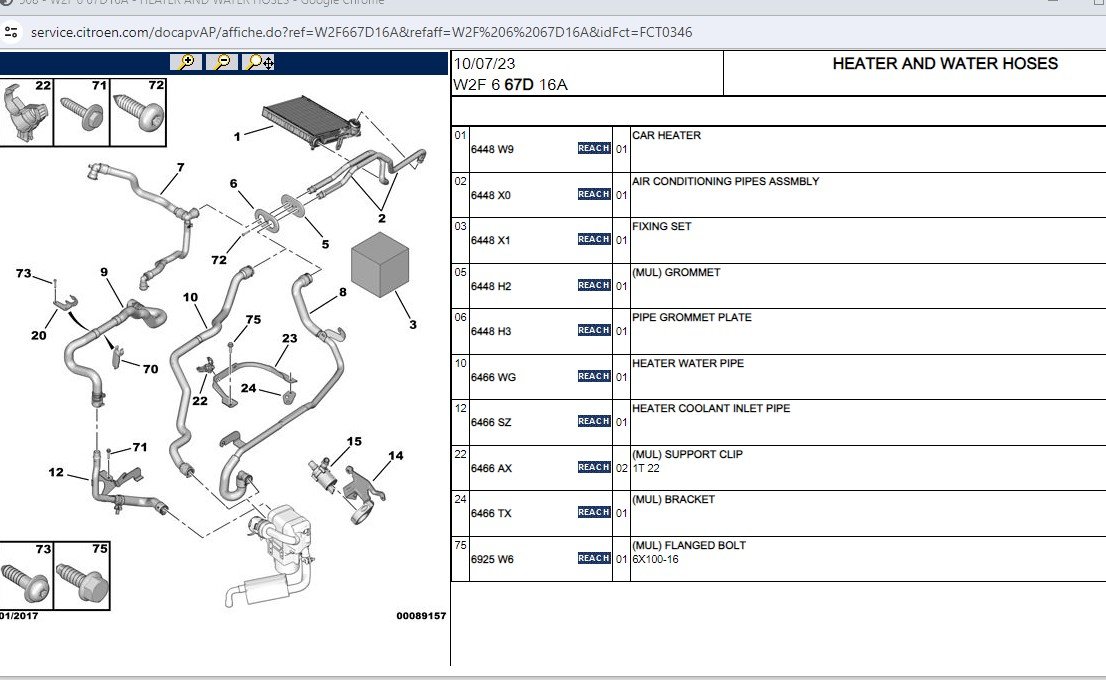

Forgot there was a separate diagram for heater hoses...
Only 10 is fitted on yours 6466WG @ £80.98
But it looks like it might be 12 which appears to be part metal? 6466 SZ @ £242.28
Strange. The shape and the brackets of mine looks like “8” (6466SL ?), but I read somewhere that it was discontinued, could “10” be the replacement? Looks like a all rubber hose.. would be nice not to have a metal pipe in the wheel well…
Oddly, item 8 says:
08
6466 SL
01
HEATER WATER PIPE
- REPLACEMENT PRECOND HEATING UNTIL RPO 17042 OR DW12C FAP TURBO DIESEL AND PROGRAMMABLE AUTOMATIC ADDITIONAL UNTIL RPO 17042
Whereas 10 says:
10
6466 WG
01
HEATER WATER PIPE
- REPLACEMENT PRECOND HEATING OR DW10CTED4 FAP TURBO DIESEL AND BVM6 AND PROGRAMMABLE AUTOMATIC ADDITIONAL
01
- DW10BTED4 TURBO DIESEL WITHOUT FAP AND BVM6 AND PROGRAMMABLE AUTOMATIC ADDITIONAL
01
- DIESEL TURBO DW10BTED4 FAP AND BVM6 AND PROGRAMMABLE AUTOMATIC ADDITIONAL
01
- PASS COMP PROGRAMMABLE ADDITIONAL HEATING OR DW10C FAP 103KW DIESEL AND AUTOMATIC ADDITIONAL HEATING
Yours is DW12C and RP date 12945, so it looks like part 8 is correct, but doesn't show up on the database for some reason against your VIN. £95.30 in the UK. Sounds like it might a nightmare back and forwards to the dealer to get the right part!
