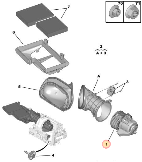

Hi! would it be possible to get any instructions and part number to replace the blower motor in our ds3? Thank you
x 6945
Re: DS3 blower motor replacement

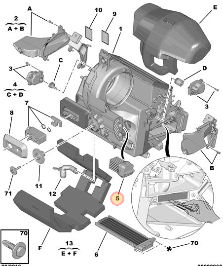

Blower Motor or Blower Motor Control Module?
Here's both in case.
(1) Blower Motor, part: 6441CS, £473.08
(5) Heater Motor Control Module, part: 6441S7, £201.25

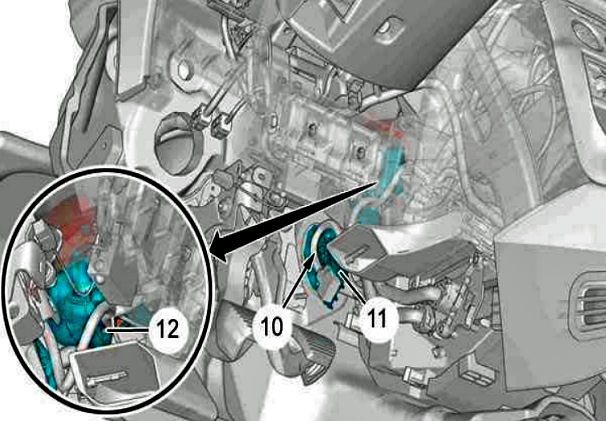

6441cs , the motor itself. Is there any directions to replace it? Thank you
x 6945
Info on replacing this is limited
Info is for left hand drive, so should be easier on a RHD from the passenger compartment, but essentially after you have removed the passenger right side trim panel in the footwell:
Remove:
  • The (10) bolt
  • The heater matrix pipes retaining plate (11)
  • The air blower (Turn a quarter of a turn)
You may need to remove the air ducting if in the way, but there's nothing else on this I have.
Make sure you disconnect the battery following the BSI Reset / Battery Disconnect / Reconnect Procedure

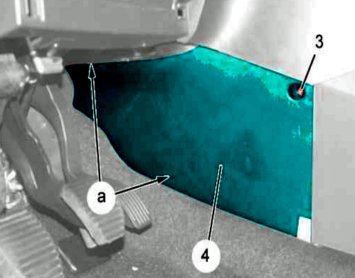

Can't even get the side panels off! What's the knack here 😭
x 6945
Undo the bold at (3) then unclip the trim at (a) to remove the panel (4). This is LHD, but RHD will be the same.
