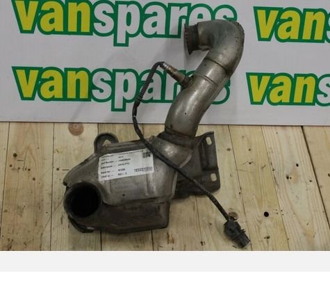

Edit------the pic shows a part described as a dpf online that my van has. so how can it be missing a dpf? should there be another? or is this thing the cat? this part on my van has a standard flange that the exhaust bolts to.

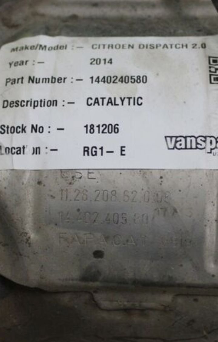

The other thing is, the cat currently on my van (see pic) might be a combined dpf/cat..but its clearly not working if it is.I'll try to add a pic of the cat currently fitted (added pics. they are screenshots of an identical cat online).
Someone appeared to have sawn thru one of the exhaust mounts (previous owner fitted a stainless steel exhaust), which caused the exhaust to tear the flange off the cat. I got it welded but I could see a mesh inside the cat i thought might be dpf.

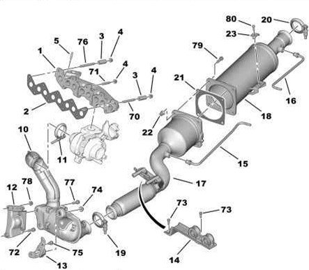

The pic you posted above looks like the pre cat (no 10), The DPF is number 18.
There is also the main cat (no 17), is this missing too?
The other issue you may have is if the DPF has been removed 'properly' The ECU will also have been re mapped so it doesn't detect that the DPF is missing so that no warning lights/messages come up on the dash, this means if you re instate the exhaust back to the way it was the DPF wont re generate & will not be long before it becomes blocked.

Hi Wheeler thanks for reply and your time. Very informative, yes looks like I have precat 10, though mine has a two bolt flange that a single silencer exhaust is bolted to. Possibly a modified flange had been welded to it when the bodger removed the dpf. thinking about it, thats going to make fitting another dpf /cat assembly tricky.
