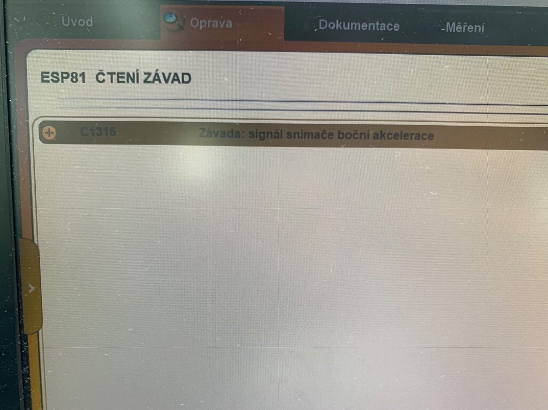

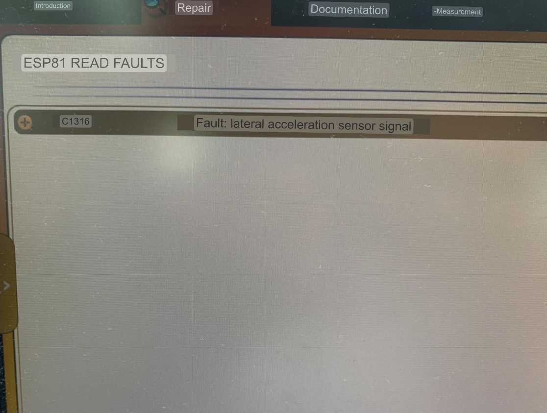

Hello, for about 2 years, yes, you read correctly, 2 years... What bothers me is the malfunctioning ESP or Semi-functional. It works until I pass a corner at a minimum speed of 60 km/h until then everything behaves fine and ESP works. Then when I turn off the car and start it again the error is gone and it repeats itself every time I drive. Lexia 3 shows error C1316. I don't know what to do next replaced gyroscope (also configured angle sensor, etc.) esp shows live values such as turning the steering wheel, position of the gas pedal, that's all in order, I just don't really know where to look anymore and everything I thought of didn't work. I did not find a single solution to this problem on the Internet. If necessary, I can also send photos of live values. Any answer will be helpful ;))

Fault Code: C1316
Description of Fault: Transverse acceleration sensor signal fault:Coherence.

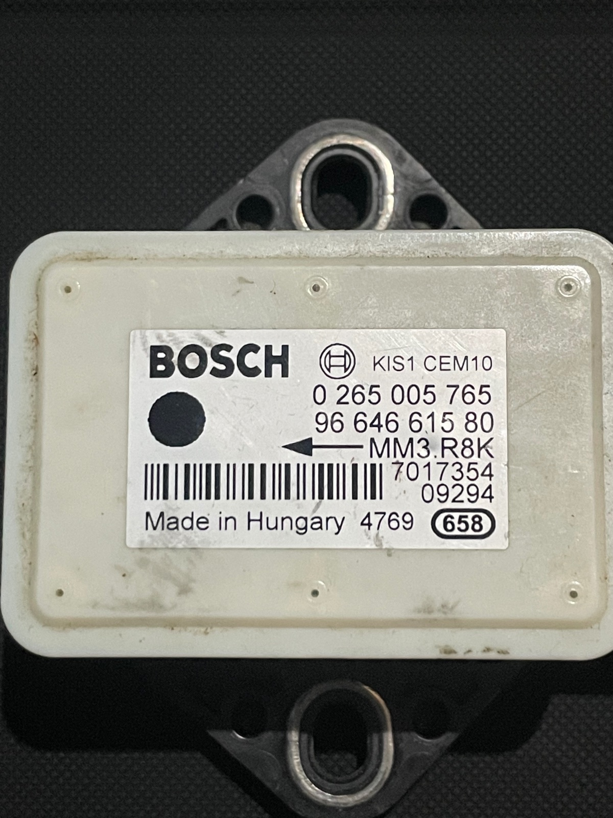

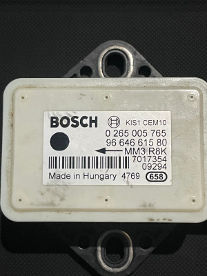

I replaced the gyroscope with the same part number only different date of manufacture,it was used from
308sw 2009 (same as my car).By gyroscope i mean the box with is in the middle of the car.

Photo above is the gyroscope i installed this one is from my car.(old)

A couple of points:
1) The sensor must be fitted the correct way around with the connector of the sensor facing the rear of the vehicle.
2) Any sensor that has has suffered an impact must be replaced.
3) When refitted, battery must of first been disconnected following the BSI Reset / Battery Disconnect / Reconnect Procedure, the fault codes must be cleared.
So you are unlikely to know the condition or situation of a used second hand sensor and personally speaking, I would never use second hand sensors , but I know they are not cheap to replace.

Hello! So few updates i tried to make a calibration BUT lexia wrote that the calibration is not possible.

Update the sensor was incorrectly fitted (turned around)
