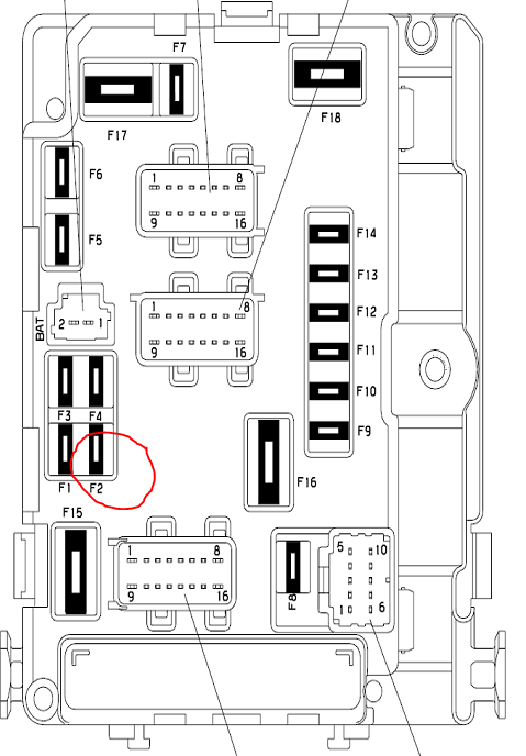

Re: 2.2 hdi LPFP sensor?
Fuse F2 (15A) in the engine compartment Fuse Box controls the fuel gauge pump.

Fuse is ok, but I'm getting 1volt at it, and 1 volt back at the tank pump. I don't see a 16-way connector under it, there's just an array of 50A big fuses.
EDIT: Oh, you meant the one on top. I'll try that now.
