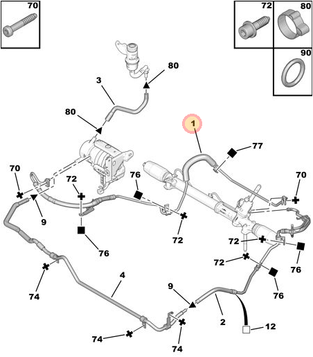

@508c5: Be advised that there is no belt linked to the power steering on this model, it has the electro pump, so operated directly from the battery.
The only thing I can suggest is one of the power steering pipes at the steering rack near the pinion. Check to see if there is any fluid leaking from this area from under the car (but don't get underneath without supporting the vehicle independently as suspension can drop suddenly and crush) and see of there is a puddle on the ground or a slow leak from the high pressure pipe.
(1) is the High pressure pipe, (2) is the low pressure pipe.
If it was the accessories belt, I would expect this to squeal a little regardless of turning the steering wheel.

Re: Citroen c5x7 squeaky noises while turning left
HiGiveMeABreak wrote: 19 Nov 2023, 21:33 @508c5: Be advised that there is no belt linked to the power steering on this model, it has the electro pump, so operated directly from the battery.
Do you have the part number for pipe number 3 in the sketch?
Thanks
- x 6962
It was 4014NT, but no longer available from Citroen.
508c5
- Posts: 214
- Joined: 15 Oct 2020, 11:37
- x 4
thanks, that's NO.1 i think...anyway...i found no. 3 (4012p3) but also not available (at least not at reasonable prices) - do you know the inner diameter (ID) size? is it 13mm?
