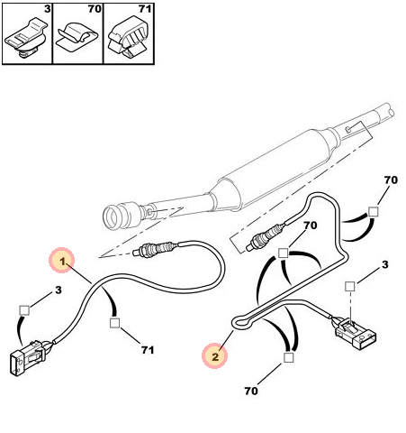

Here you go, any future parts requests, just request them in the Official Parts thread here:
viewtopic.php?t=69962
(1) OEM Original Emission Control Oxygen Sensor (10W Long 565), Part: 1628KN, £264.97
(1) Cheaper Universal Alternative, part: E144003, £52.91
(2) OEM Original Emission Control Oxygen Sensor (7W Long 1850), Part: 1628TH, £264.97
