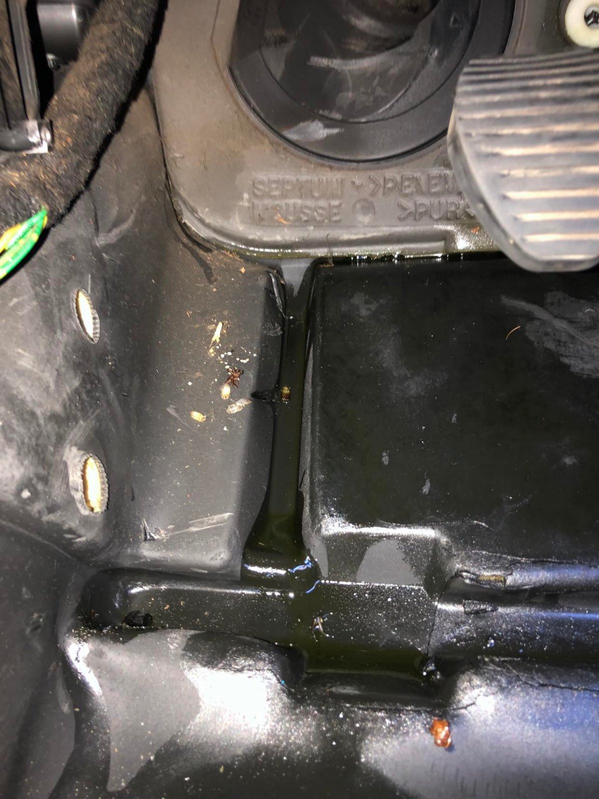

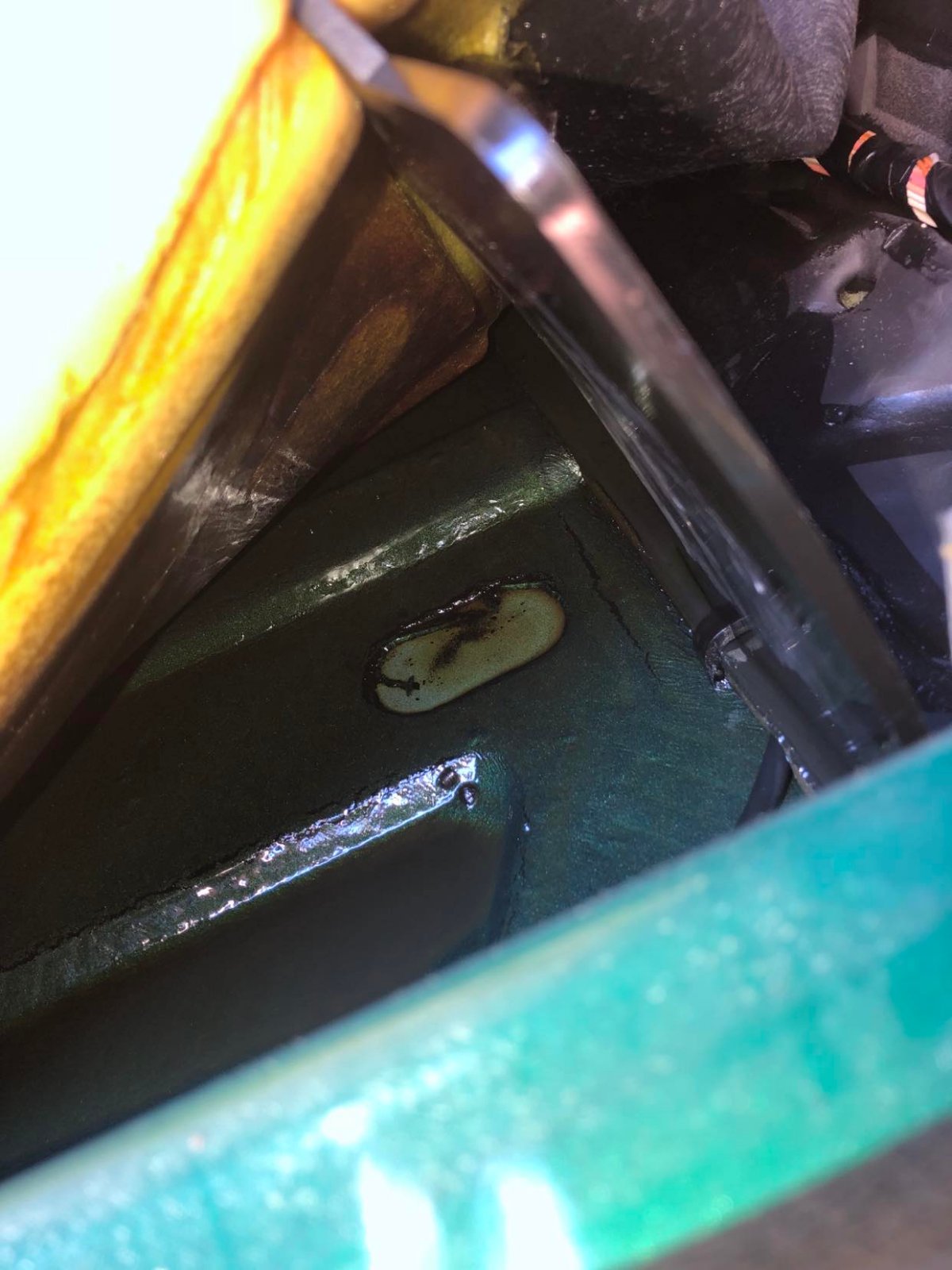

Signs - Remove the lower driver's door seal to allow the carpet and foam underlay to be partially lifted, if you can see or feel LHM+ fluid, you have found your leaking fluid.
LHM+ UNDER CARPET / FOAM
This senario indicates a leaking protective cap on the Doseur Valve (Citroens super brake servo), which needs to be replaced urgently. To minimise further fluid loss I used a bungee to lift the brake pedal up a couple of inches towards the steering wheel and after parking the car in your repair area, not too close to the wall (!) as you will need to bleed the system later, I supported the front of the car so the front wheels could be removed for brake bleeding. Set the vehicle height to low, once the car is settled, release the remaining pressure in the system by undoing (half a turn MAX) the pressure release bolt on the regulator body (12mm hex bolt). Remove the handbrake cables from the brake calipers is recomended, if you're planning on removing the driver's carpet for cleaning up the footwell area.

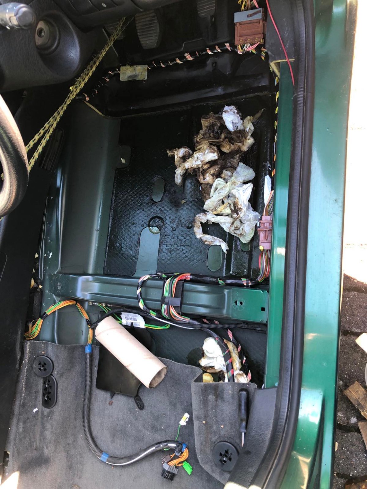

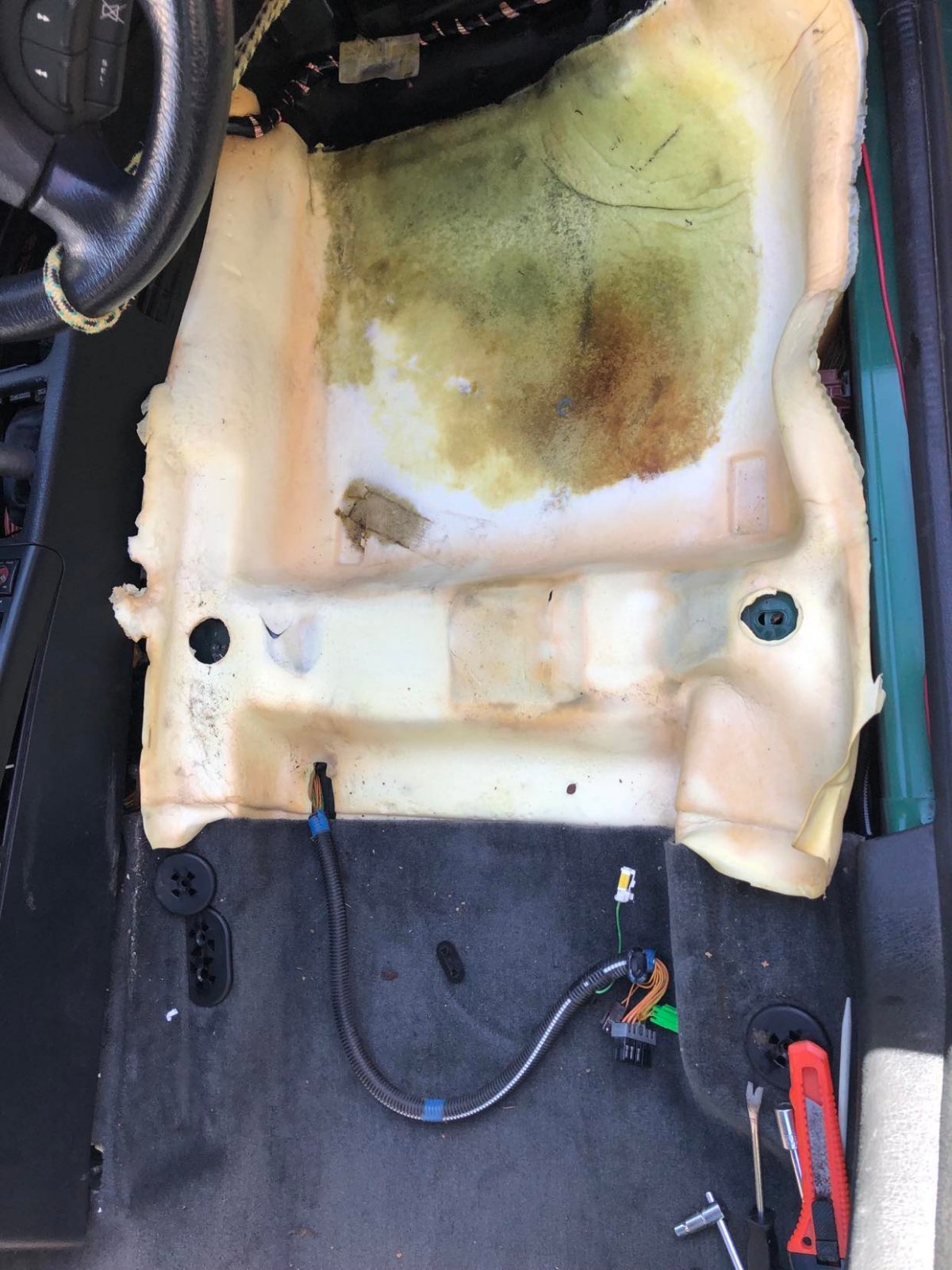

I decided to remove the carpet as I had plenty of time for the job so ...
I disconnected the vehicle 12 volt battery, to remove the drivers seat, (if you're NOT removing the seat from the car completly LEAVE the trim fitted) remove the seat plastic side trim if removing the seat from the car (pulls up and forward - mine broke), rear bolts first, then fronts (40 Torx bolts) tilt the seat back once the 5 bolts are removed and under the seat is the wiring harness for the airbags (make sure you've isolated the car battery and allow 10 minutes before continuing to allow the sensitive ElecTrickery to become safe) remove the 4 wiring connectors clips and a harness clip (you might have extra wiring for seat adjustment/heater) and the seat belt anchor if you're removing the seat out of the car.
To remove the carpet you need to remove the fixings for the centre consul, I managed to remove the carpet by just loosening the consul, the airbag ECU and a plastic 'clip' that unscrews near the thottle pedal. This was mainly because I hadn't left much room (that wall again) to remove the handbrake cables from the brake calipers, necessary to lift the handbrake lever fully to release the centre consul. Lever out the oddment tray to reveal the airbag ECU (3 10mm hex bolts) and 2 10mm bolts for the consul. Lever out the gear lever gaitor. Remove any switches you have on the rear of the consul and near the height selector (levers out) is a single 10mm hex nut, a further 2 10mm hex nuts are accessable after the rear ashtray is removed. Once all those nuts (5+3) are removed you can wiggle the carpet out from under the consul.
SOGGY FOAM
SOGGY FOAM
Then the foam can be removed for cleaning/drying (small cut near handbrake required). I used washing powder in a hot water solution once most of the LHM+ was drained then rung out of the foam. My carpet was fairly free of LHM+ but I still wish I'd given it a freshen up whilst it was out of the car.
FOOTWELL EXPOSED
FOOTWELL EXPOSED

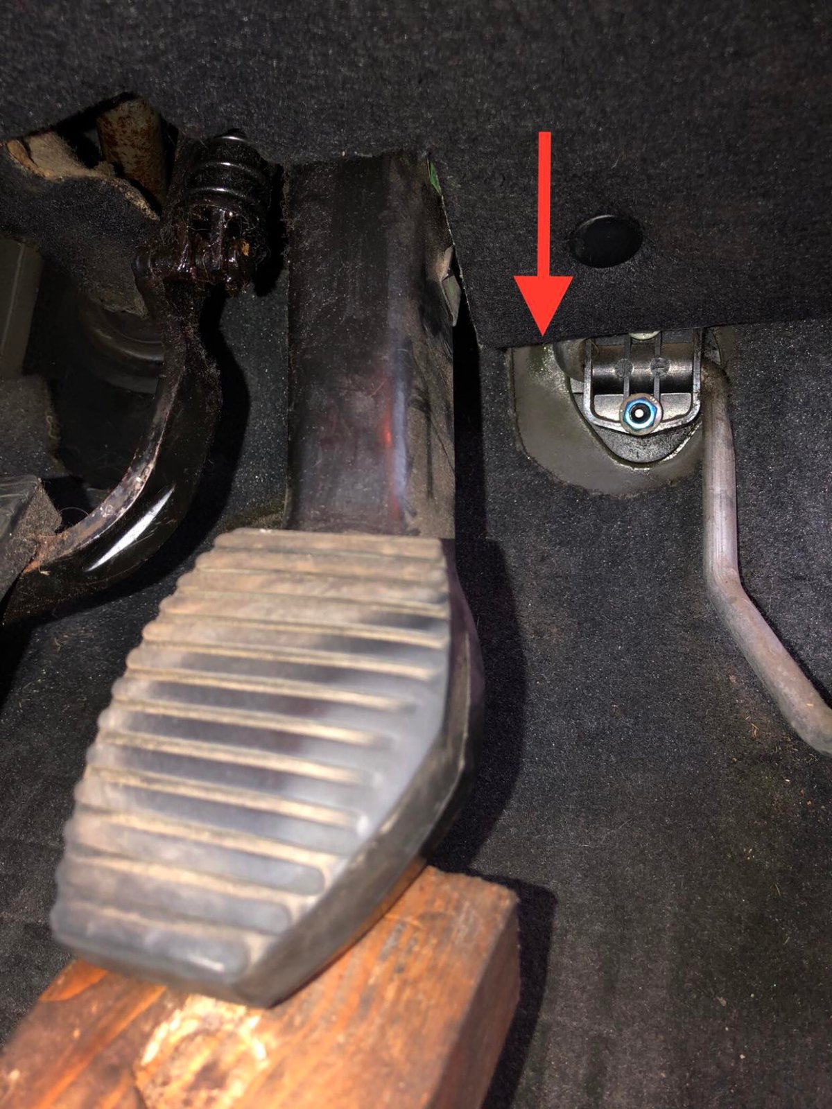

RUBBER PEDAL MAT
RUBBER PEDAL MAT

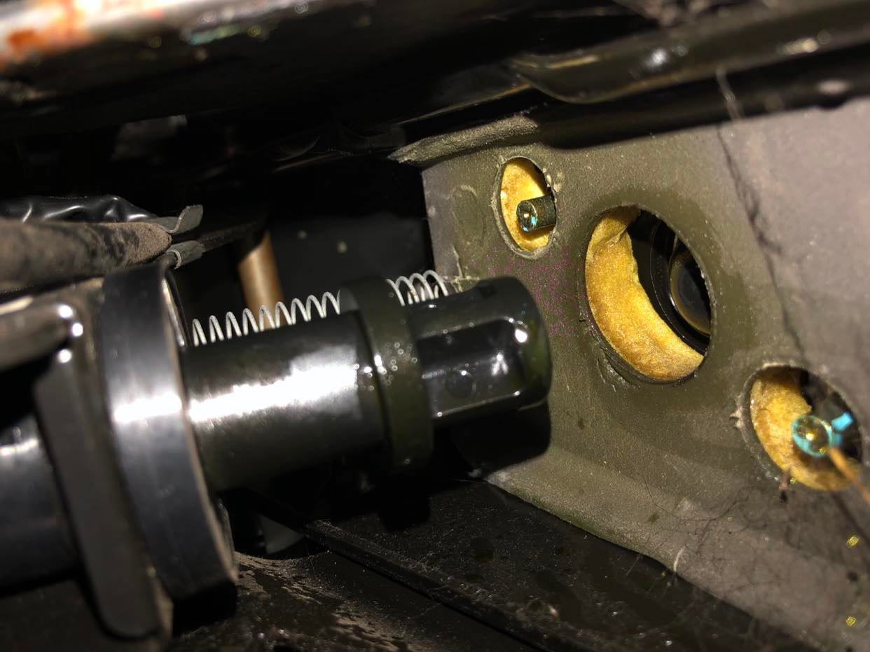

REAR OF DOSEUR VALVE
DOSEUR VALVE LOCATION

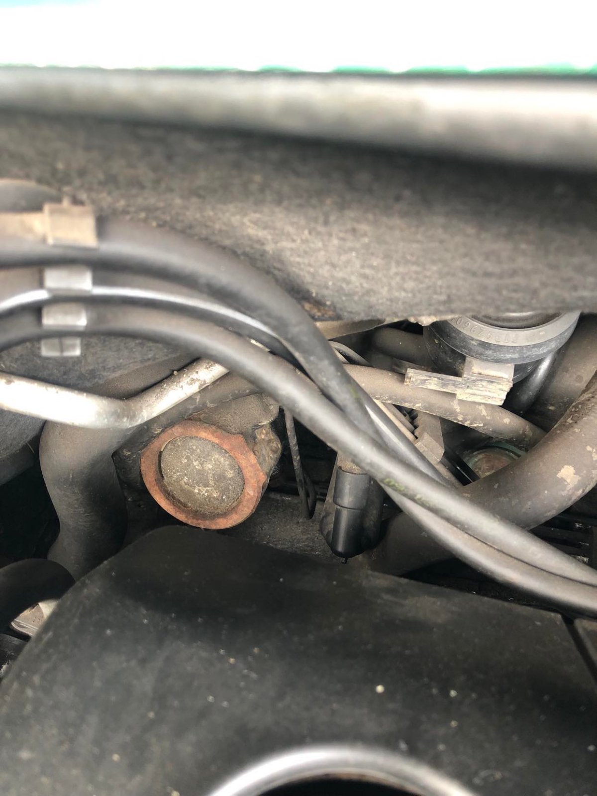

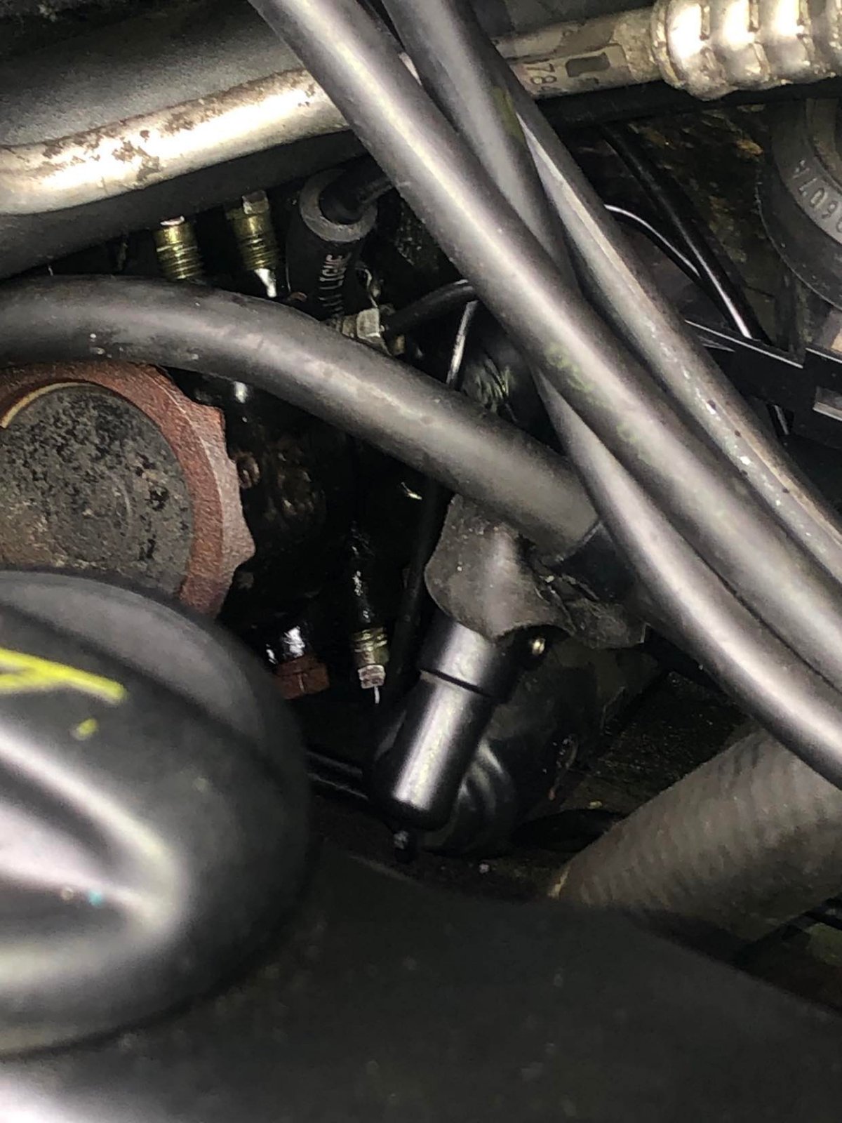

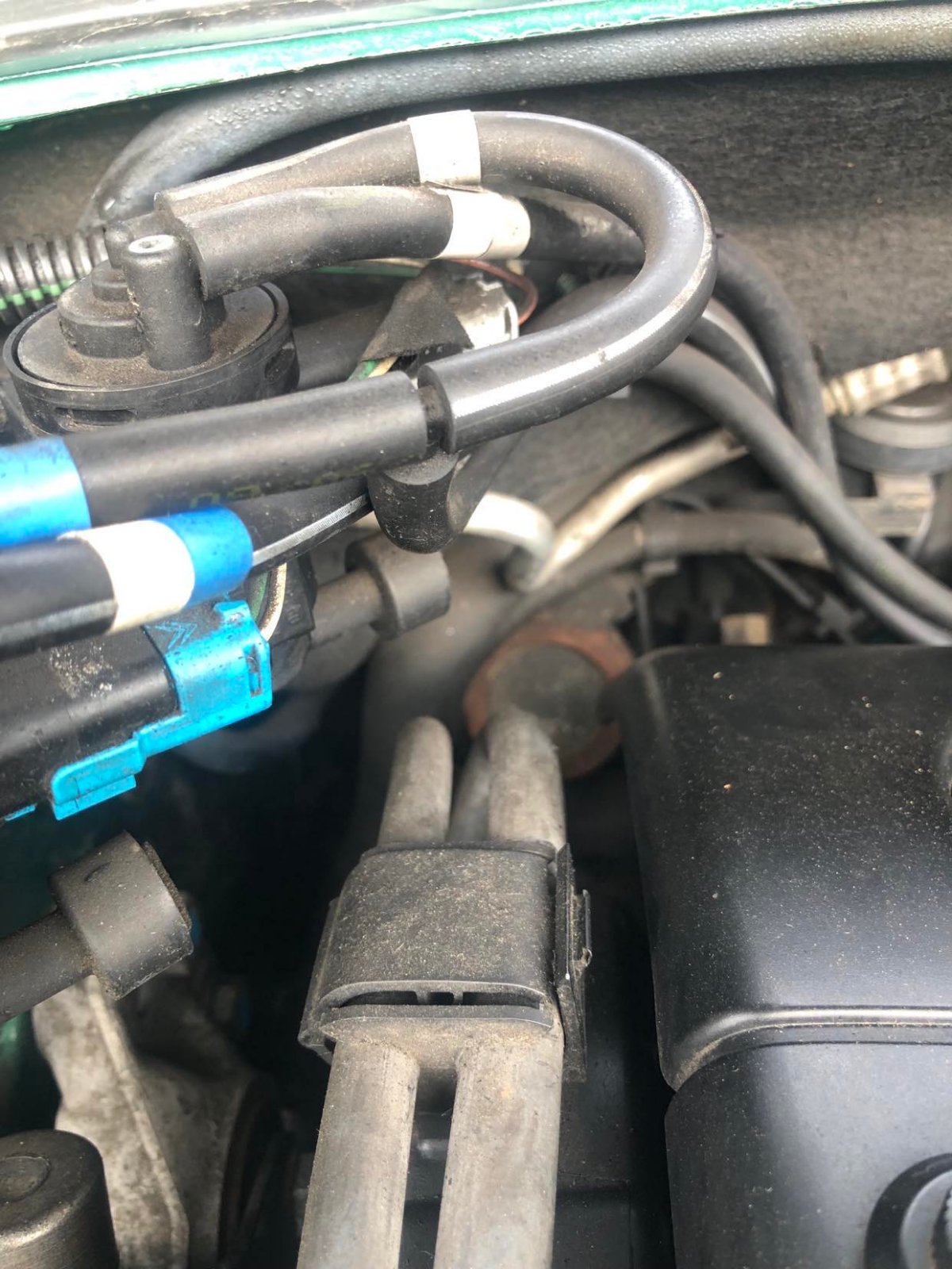

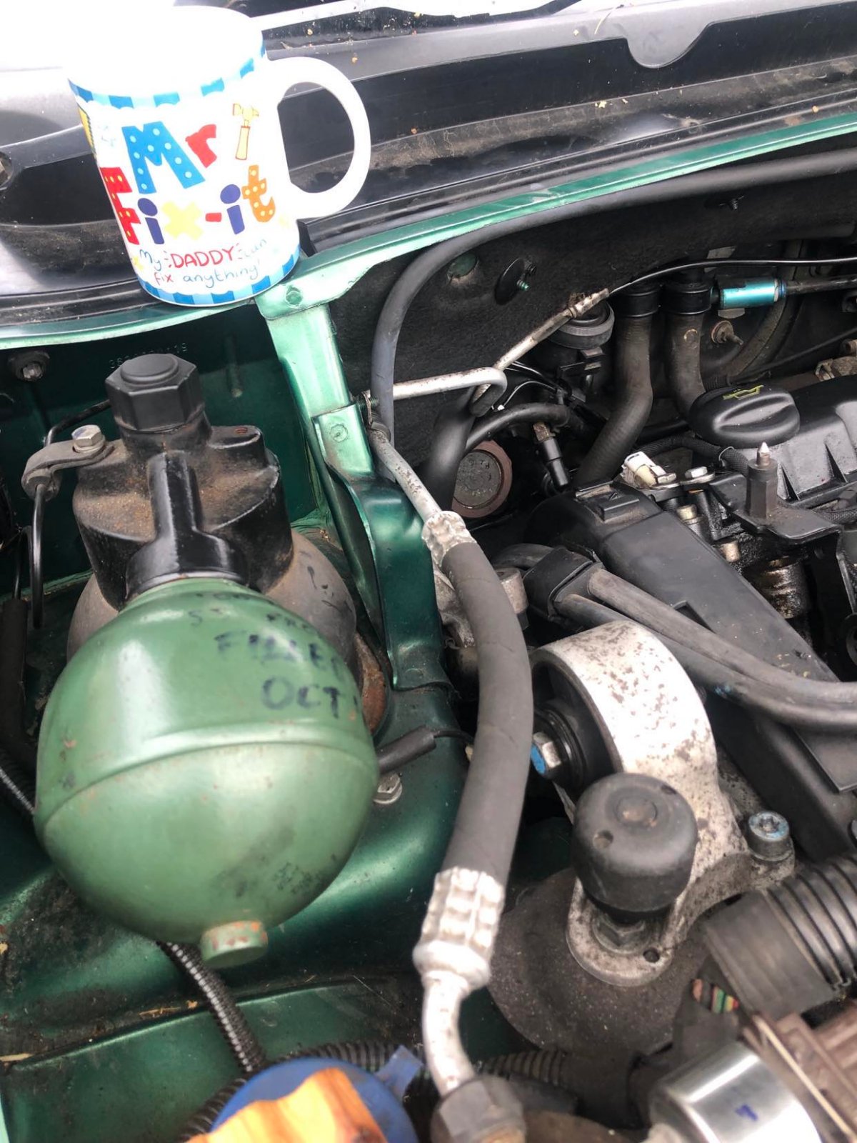

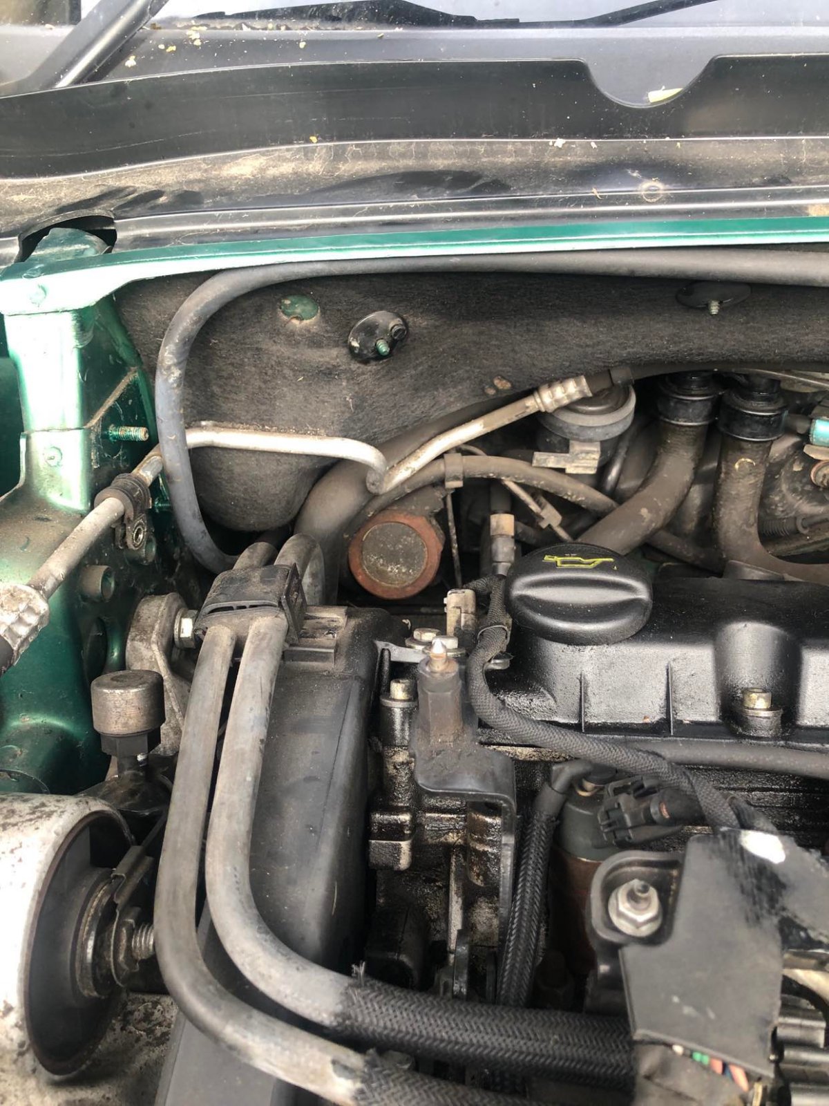

The engine bay on the HDi allows just enough room to pivot the valve, so I didn't need to tilt the engine at all but you still have to remove a few parts in the engine bay:
Engine cover, mount for exhaust emmision valves, cable plugs detached, also allows one of the air-con pipes to be manouvered out of the engine bay, fuel lines uncliped from securing points also allows better access. The other air-con pipe was left in situ.
EMMISION VALVES
EMMISION VALVES
AIRCON PIPE RELEASED
AIRCON PIPE RELOCATED

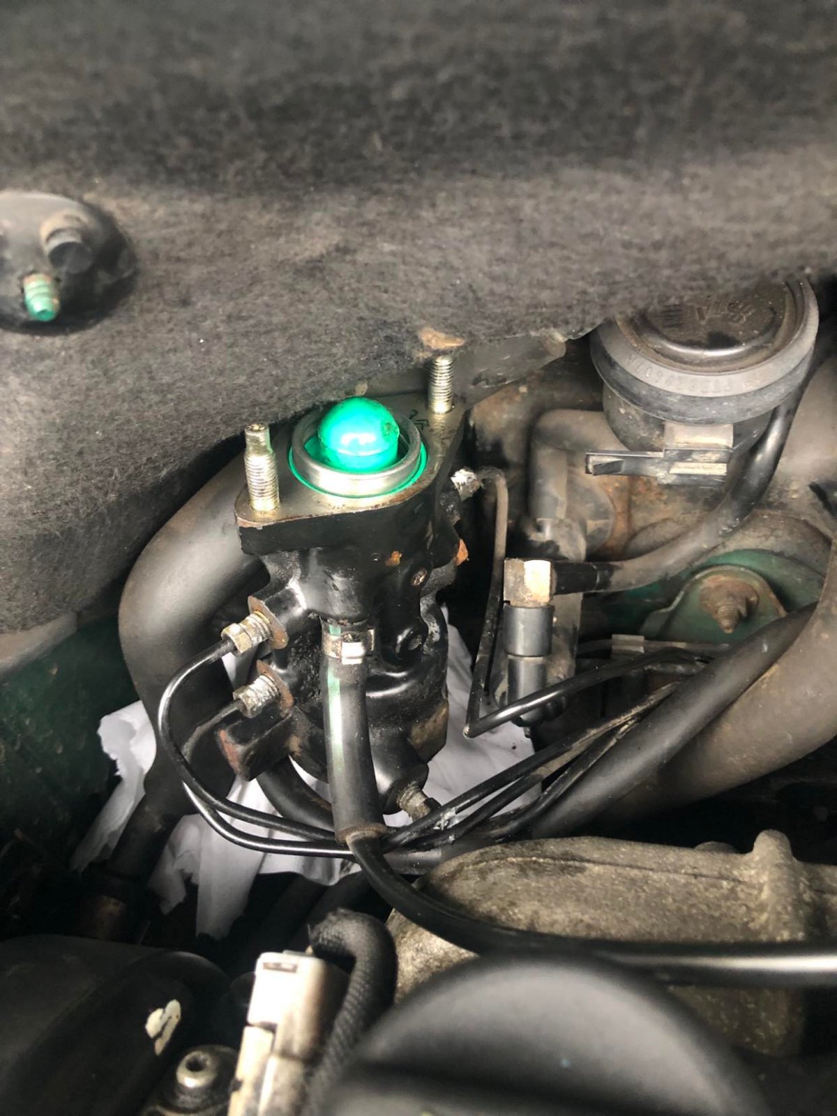

Once you've done that, working inside the drivers footwell, remove the carpet trim above the brake pedal, held in place by 4 plugs and one screw, that removed you'll need a good quality 11mm socket on a narrow 1/4” extension bar and knuckle (my long sockets were too long and my short sockets wouldn’t go through the locating / guide horns of the valve body with the brake pedal still attached (still bungied up to avoid constant LHM+ leaking out of the valve.

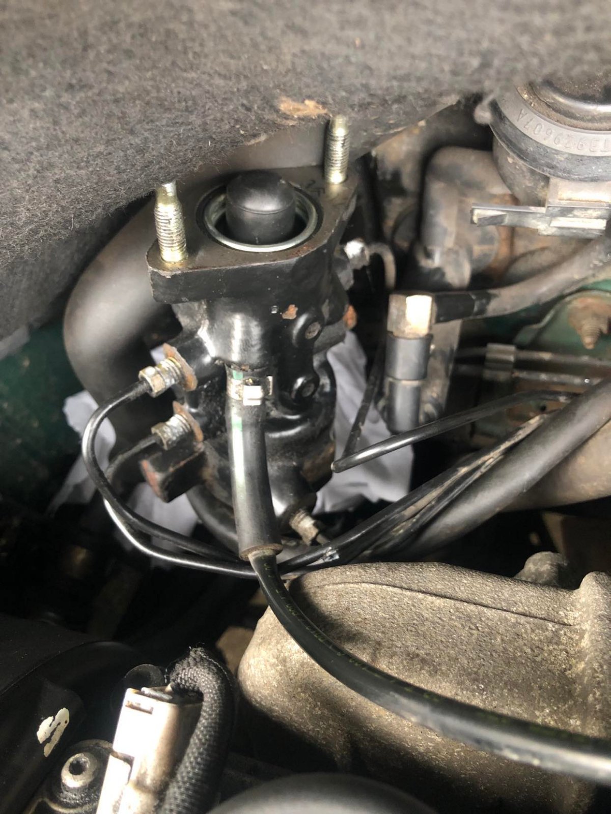

Undo both nuts that secure the valve to the engine bay bulkhead. I also uncliped the pipe clip on the bulkhead to allow a bit more flexibility in the pipes. Now the valve needs to be rotated forward towards the engine, roughly 90 degrees, this will expose the cap that is the likely culprit for the leak inside the car.
DOSEUR VALVE ROTATED

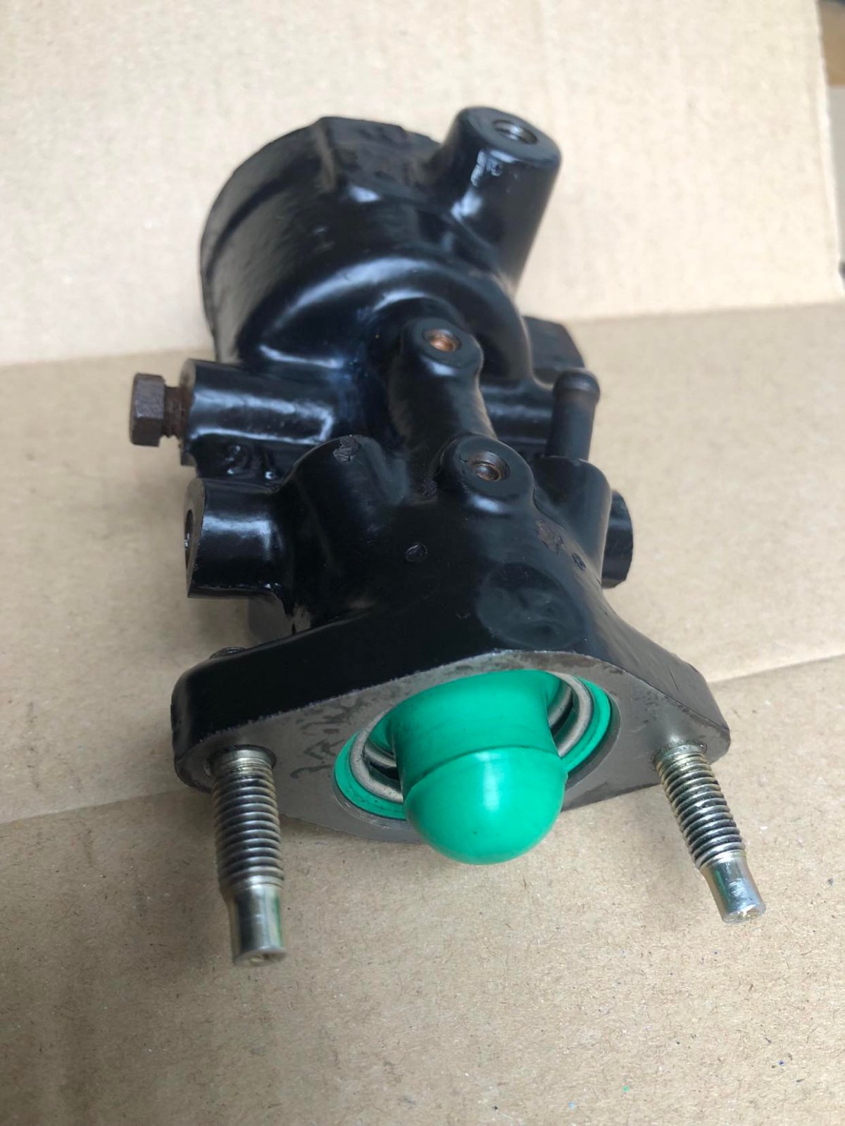

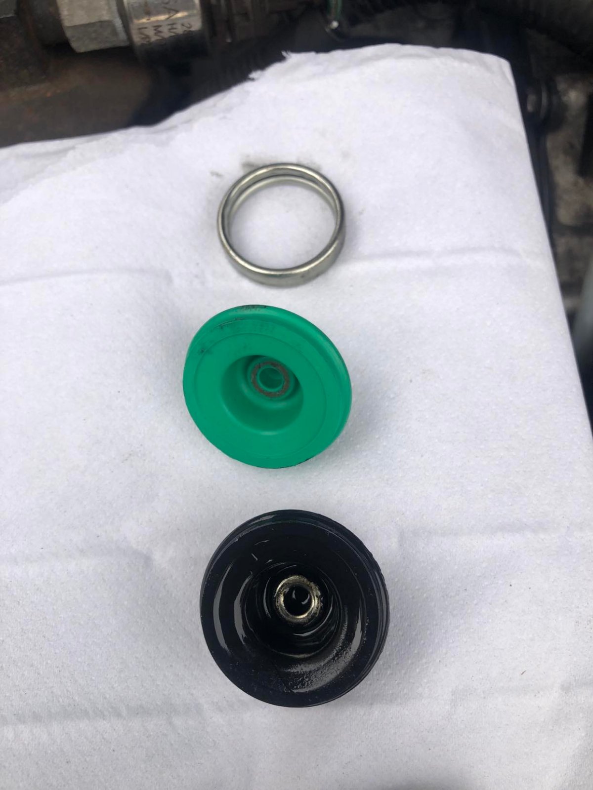

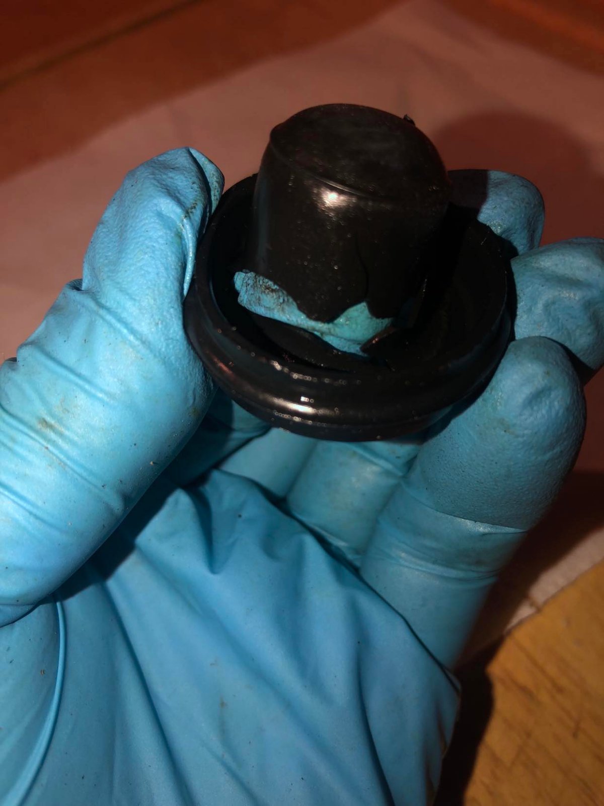

I prised out the alloy ring that secures the cap, mine came out in good condition, (luckily because I never had a new one), once the ring is out the rubber cap needs prying out.
ALLOY RING - NEW RUBBER CAP - OLD RUBBER CAP
DOSEUR VALVE WITH REAR RUBBER CAP REMOVED
DAMAGED RUBBER CAP
DAMAGED RUBBER CAP
NEW RUBBER CAP FITTED - ALLOY RING NOT FITTED

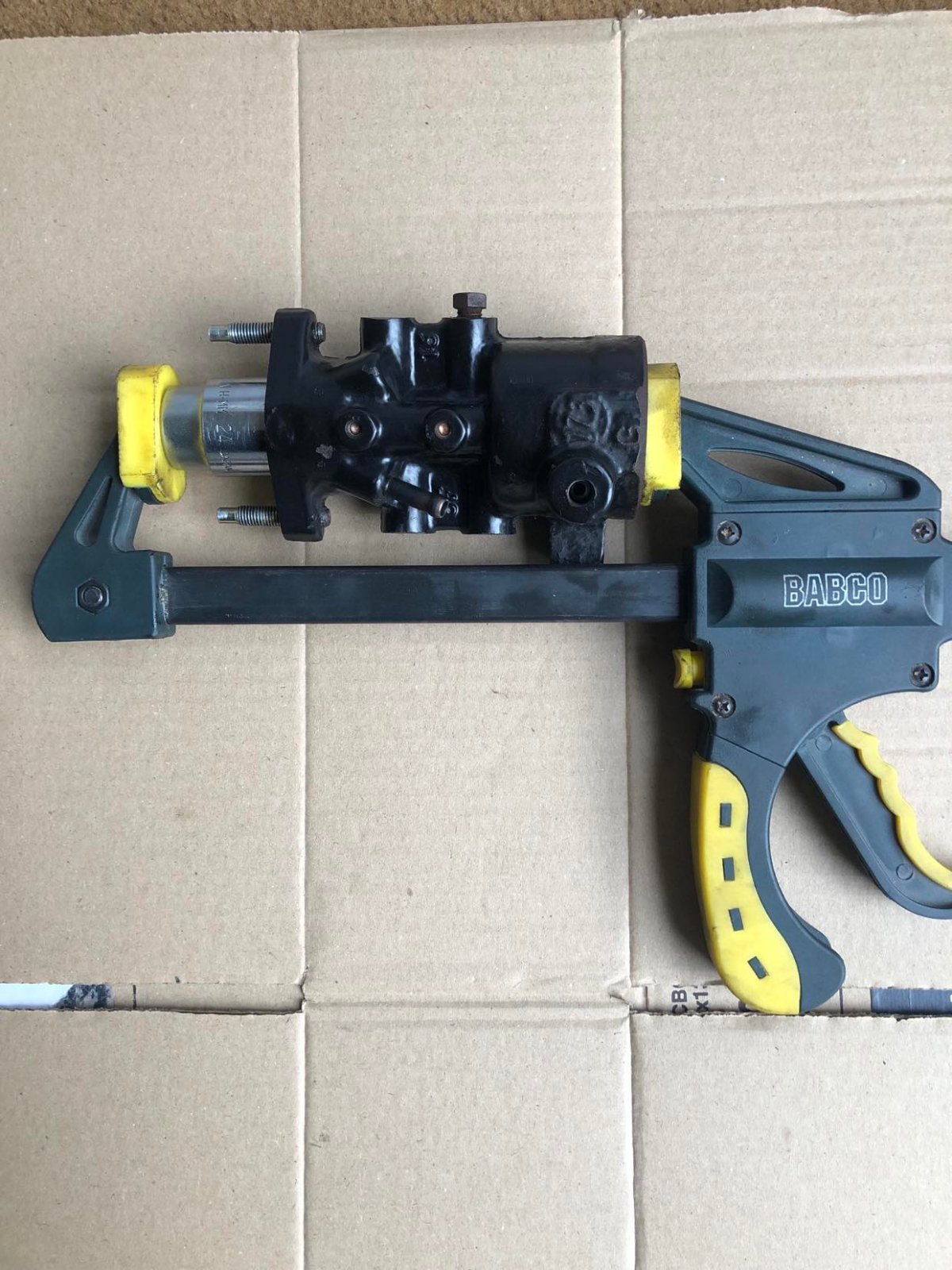

If you want to try and just replace these two parts without further dismantling, feel free to try, my thumbs weren't up to the job and a week later I still have dents in them from trying to press the alloy ring back onto the rubber cap in the valve body, I also tried with a clamp and socket but on the car the ring just wouldn't go in deep enough or square enough, partly because of the 4 pipes and 2 tubes going into the Doseur Valve. Maybe my replacement part is stronger than the previous parts :roll:
So unless you have thumbs like superman you'll need to take the Doseur Valve off the car: Remove the 4 metal unions (8mm) and wiggle the pipes out (they'll be stiff to remove because you've twisted them a bit) this will allow the valve to be twisted more to get asccess to the remaining two rubber hoses, be gentle here as they will be delicate, remove the securing clips, slide off the hoses and bung as many of the holes as you can to prevent dirt getting into the system.
CLAMP TO FIT ALLOY RING
Even with the Doseur Valve off the car, I struggled with the clamp tool, to push the ring in square with a socket and it had to be persuaded with a soft mallet on the socket and bar, now assuming there was no other signs of a leak from the other end of the valve you can remove the 4x old seals from the valve body and re-assemble with new seals.
