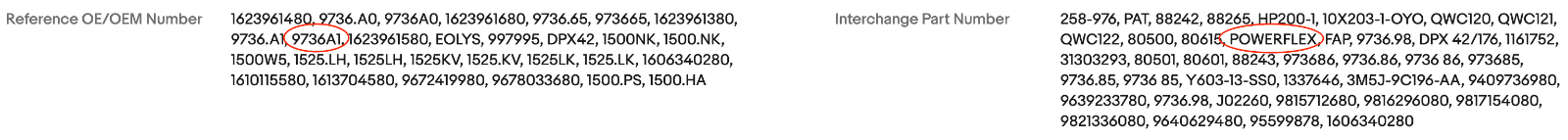

I found the right genuine type as "9736A0 Diesel Fuel Additive DPF" on amazon, but it costs 3 times the alternative on ebay. There is also a PAT Fluid PDF, but not sure if this is suitable.
My question is, does it matter using the alternative additive vs the genuine one?
How can I know the tank capacity so I can buy 1 litre or 3 litres?

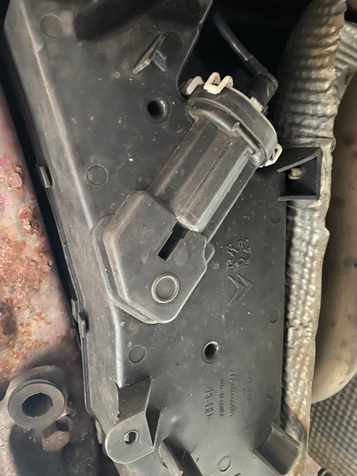

I managed to take a photo of the tank

Peugeot 5008 1.6 HDi Eolys tank capacity

Yes, the additive type does matter and is specific to the vehicle's system and build date.
If you provide your VIN - please post your VIN in full without spaces - it will be automatically masked from public view after submitting your post & will only be visible to staff, then I will be able to advise if you have a pouch or reservoir based system and the correct additive type.

Refillable reservoir; almost certainly Powerflex, but Marc should be able to confirm. A litre will be plenty.
Three are a number of generic additives that say suitable for all systems - I've got some of the stuff that DPF doctor use to refill mine when the time comes (did my Sister's car with it last year). You do need a diag computer to reset the level once you have done it. I've got diagbox, and not that far away (Lanark) if you need it re-set.

Yes tank-based and model & build date indicate Powerflex additive to be used.

I am inclined to get Neo Brothers Fuel Additive Refill Kit EOLYS unless you advise against it. It is about one-third of the cost of the PSA one. It mentions that it is compatible with my car with POWERFLEX, and the specific part number (9736A0) in the description.
