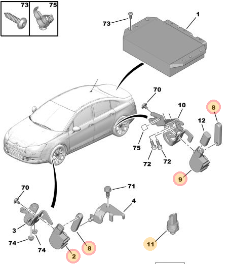

How long have you been away? Normally suspension height is usually maintained.
1) Are there any suspension messages when the engine is started or warnings?
2) Is the battery in a good state of charge?
3) I can't see the height sensors being the cause at this stage,
4) It is possible that either the front and / or the rear stiffness regulators have a leak, which can result in the hydraulic fluid returning to the reservoir.
I won't put all the stiffness regulator check stuff up yet in case you resolve the issue, but let me know if this is something you want after checking the other things.
(2) Front Body Height Sensors
Left (Red), part: 5273J7, £89.34
Right (Yellow), part: 5273J8, £89.34
(9) Rear Body Height Sensors
Left (Blue), part: 5273J5, £92.74
Right (Green), part: 5273J6, £92.74
(8) Angular Pickup Link (Front), part: 527381, £32.36
(12) Not shown as applicable to this vehicle
(11) LDS Pressure Sensor (in case this has failed), part: 5273A2, £215.42 :shock:

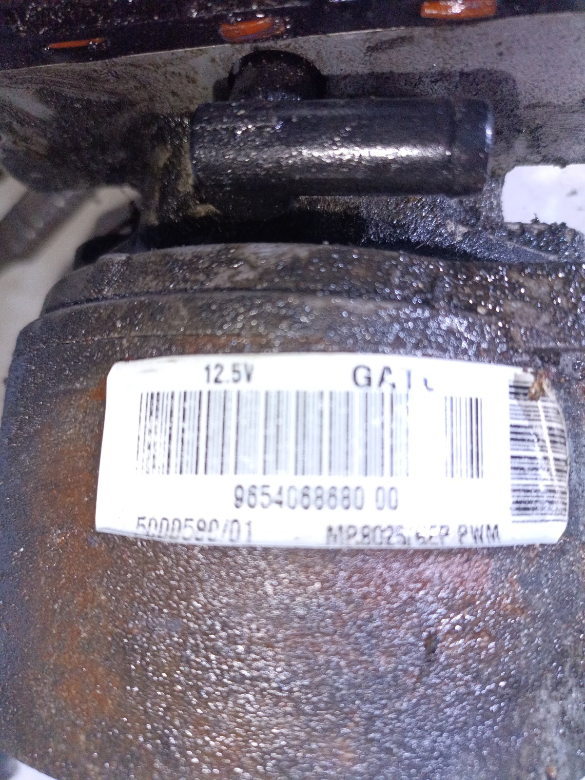

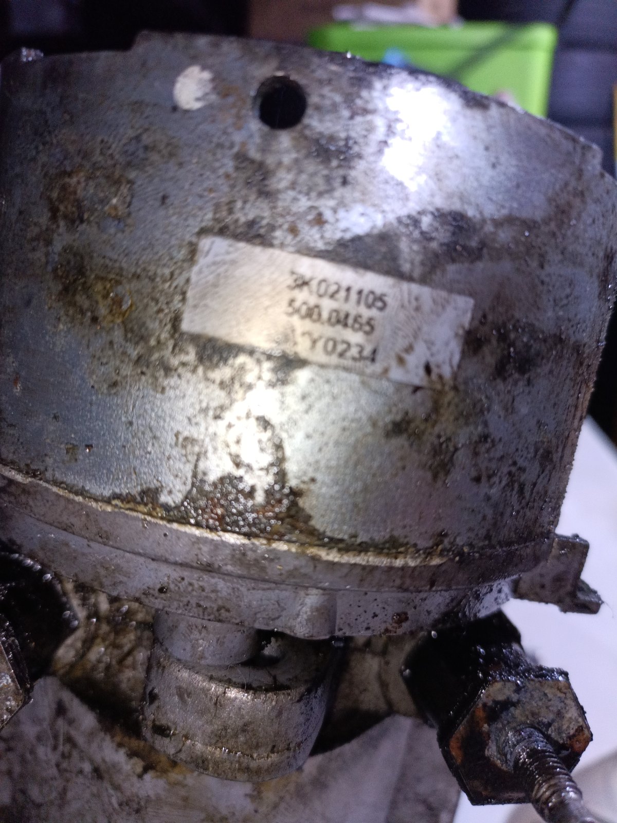

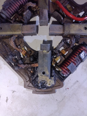

Uhm, Houston, we have a problem...
I guess I need part numbers for the BHI, I've got a partial number:
Nothing legible on the white label on the ECU:
I can get this off the side of the motor:

yep, that looks about normal :roll:
Still, it doesn't explain how it was slammed unless the boss selected down on the suspension switch?
I think your best option is a good used one in the UK and swap the electronics over (the motor and valve blocks are mostly the same) or import a brush set from Turkey.
I have a new spare but you ain't getting that :rofl2:
I might have a half decent spare in the garage (let me check on Wednesday) and a known good one on a spares car as an absolute last resort (as I'd like to keep it inflated for now).
x 6945

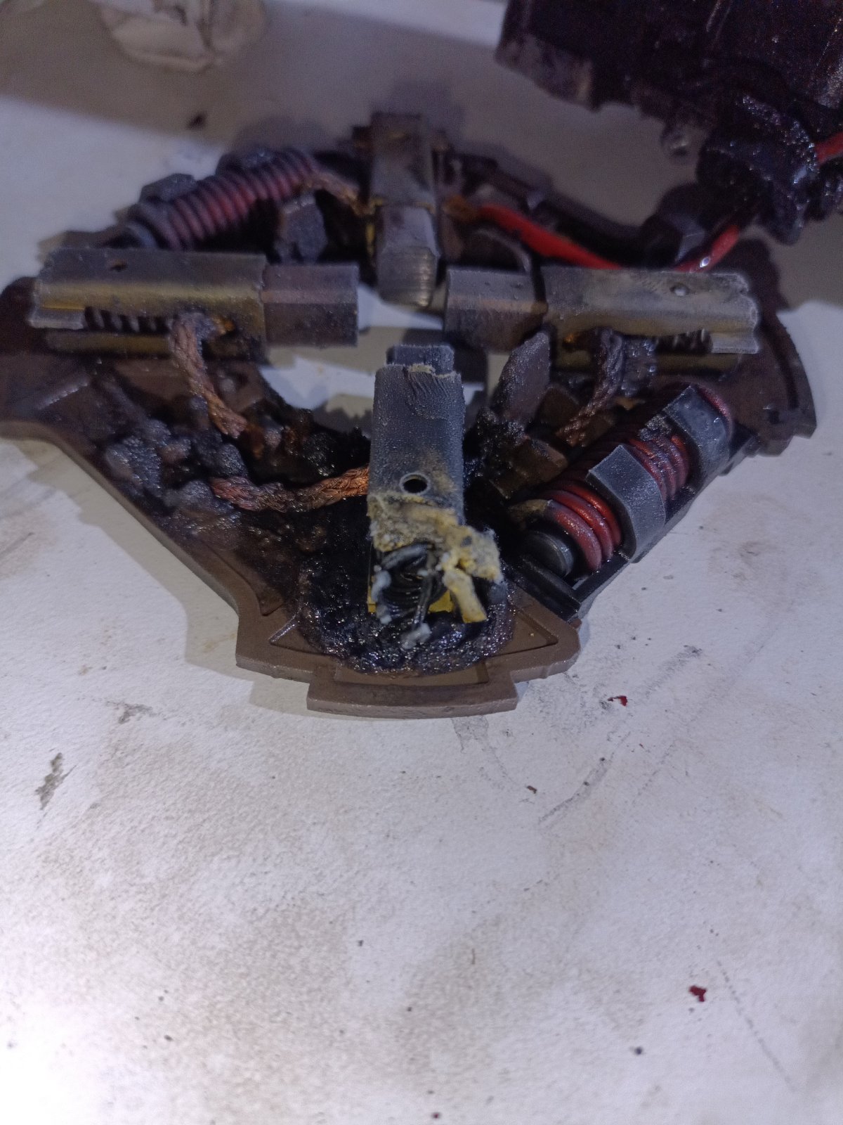

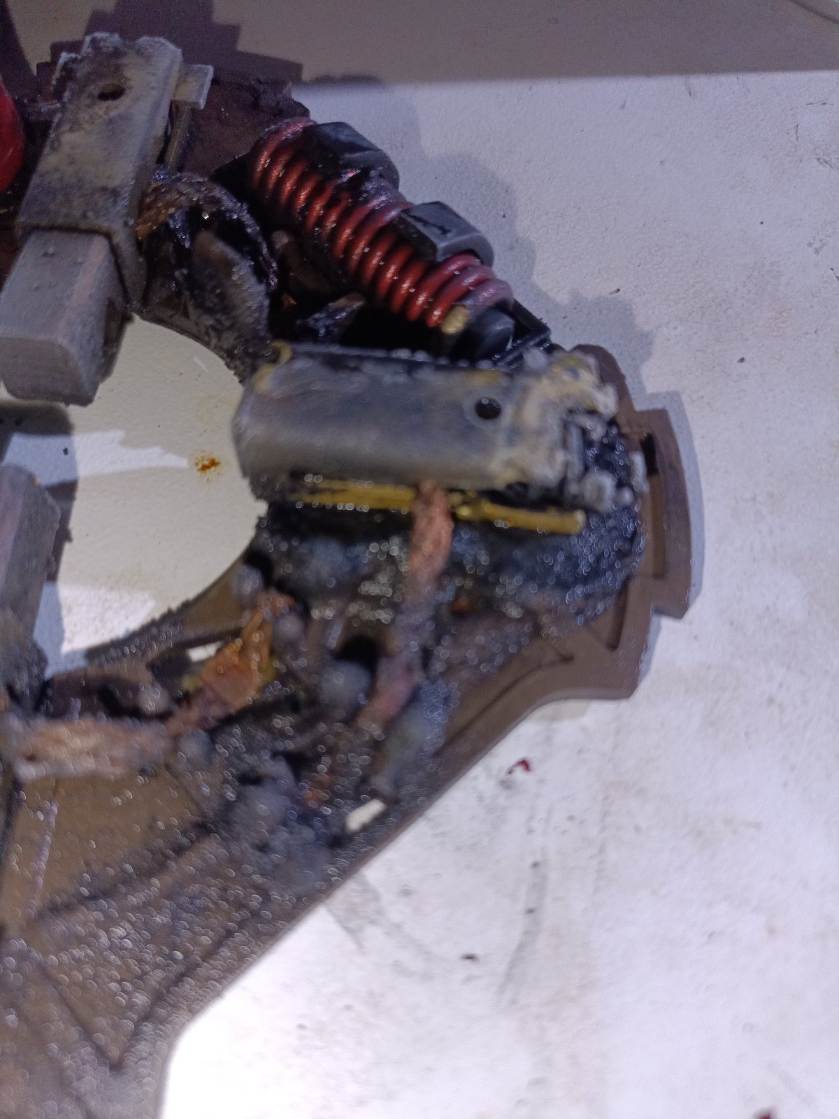

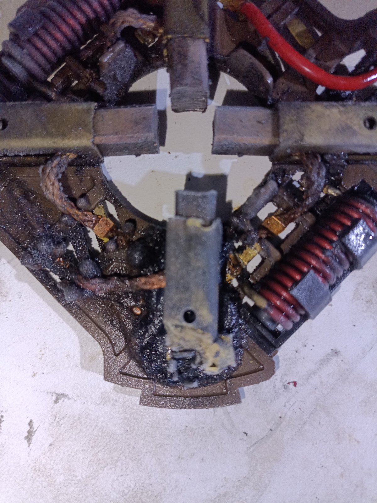

Re: C5 (X7) 3.0HDI - suspension pump brushes and height sensors
That brush looks well eaten away!

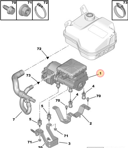

(1) New OEM BHI (will need configuring), part: 5277K5, £1961.84
Standard Exchange BHI (will need configuring), part: 1680916580, £1285.52
The new OEM ones that are pre-configured are no longer available, but at least you have the part numbers for second hand ones - but bear in mind, depending which vehicle they are off, may also need configuring.
