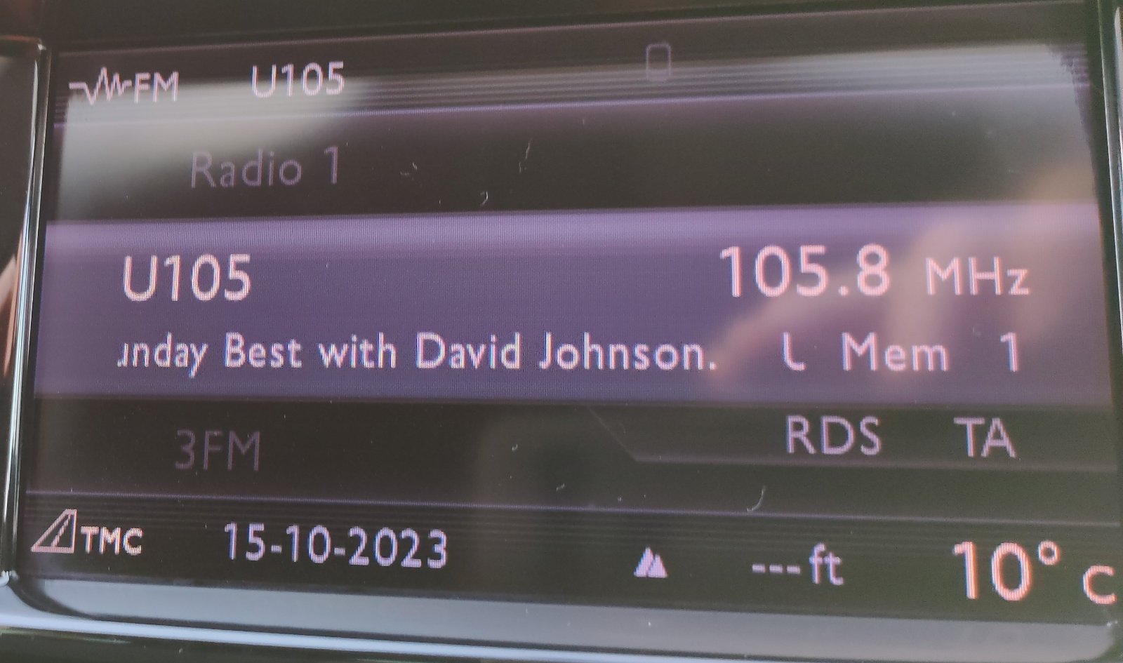

The issue is that the RNEG/MyWay Colour screen doesn’t display the time on ANY screen (Radio, Phone, Trip Computer, or Sat Nav).
The time is only visible when I go into the settings to adjust it.
I have tried a full reset, retuning to other stations (BBC ?/ RDS ?), plotting a route in the Sat Nav, etc, and nothing displays the time.
I’ve also ticked and unticked the sync time with GPS setting.
As it’s a petrol manual model I don’t think there’s space for the time to be displayed in the Fuel Gauge section of the Instrument Panel.
The Date and altitude, TMC, etc are displayed ok at the bottom of the screen.

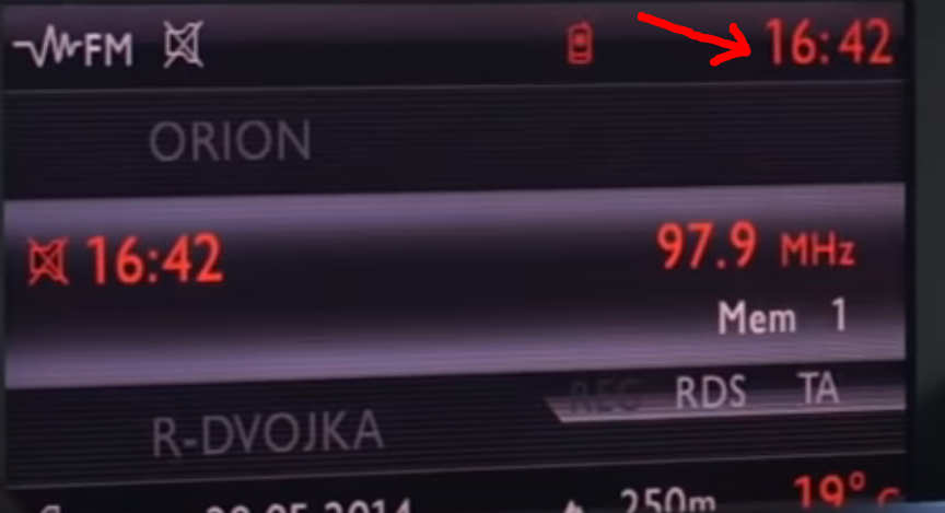

Can you put a screen shot up - the time is supposed to be at the top right of the display.

Yeah, I've seen other screenshots and the pictures in the manual which showed the clock location.
That's what made it's absence all the more obvious.

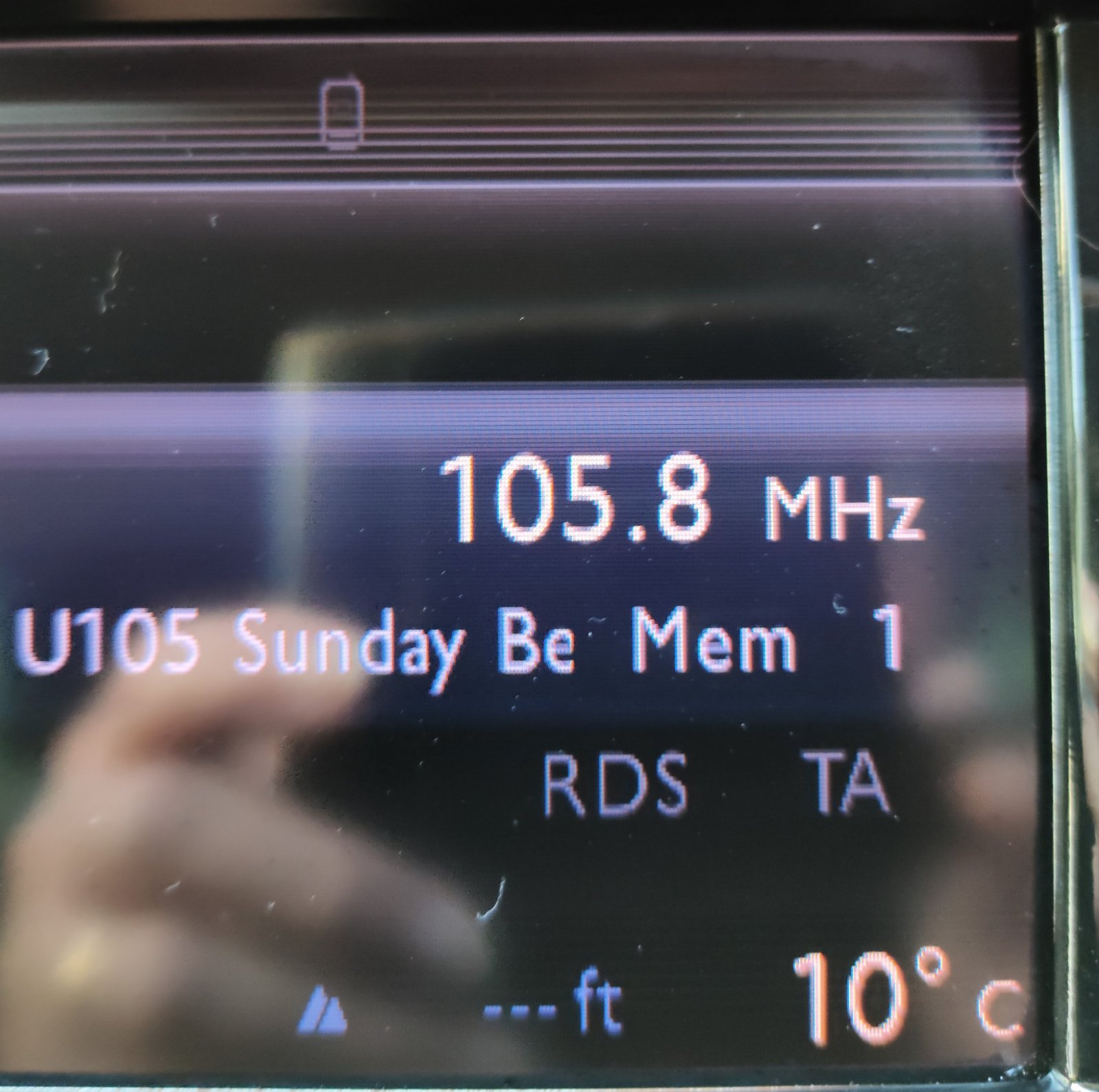

Please see two photos. I just turned the radio on for these and didn't start the car or anything, so it wouldn't have had time to get a satellite fix.
My phone isn't paired with this device either.

It may be the theme you have but that top horizontal banner that is missing the time looks 'lined'. Can you try changing the theme and see if those lines remain. I'm wondering if it's a graphics chip error and would like to rule that out.

Unfortunately changing the colour of the display didn't show the clock.
The lines aren't displayed at the top of the screen in the top three colours, but they are in the last two.
I'd have thought that if it was a graphics issue then the Tuner Band (FM), station name, and paired phone wouldn't be displayed then ?

Yes, I wanted to see if it was an obvious graphics chip issue or a screen issue. But in this case I can't see that it is either. The only thing that I can suggest that cause anomalies like this are a software glitch, incorrect configuration of the telematic unit ECU (via a diagnostic tool), hardware or a wiring / connection issue (may be worth checking at the back of the head unit to ensure all the connections are properly attached) - but don't do this with the vehicle battery connected and if disconnecting the rear connections, always follow the BSI Reset / Battery Disconnect / Reconnect Procedure, then remove the quadlock first before the other connections and reconnect in reverse order (quadlock last).
