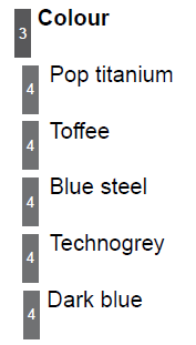

It may be the theme you have but that top horizontal banner that is missing the time looks 'lined'. Can you try changing the theme and see if those lines remain. I'm wondering if it's a graphics chip error and would like to rule that out.

Hi Marc.
Unfortunately changing the colour of the display didn't show the clock.
The lines aren't displayed at the top of the screen in the top three colours, but they are in the last two.
I'd have thought that if it was a graphics issue then the Tuner Band (FM), station name, and paired phone wouldn't be displayed then ?
It's definitely odd, and a nuisance not to have time displayed in the car.
We might need to resort to buying a small stick-on digital clock.
