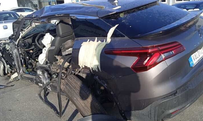

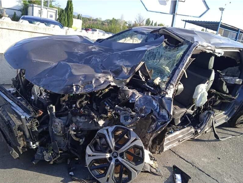

Bit of a nasty prang on this one....
The actual IVI system is manufactured by Magneti Marelli and Harman I believe in several variations depending on trim level.

Re: C5x issues
From here the wheel centre emblem looks perfectly ok….but that is about all.
