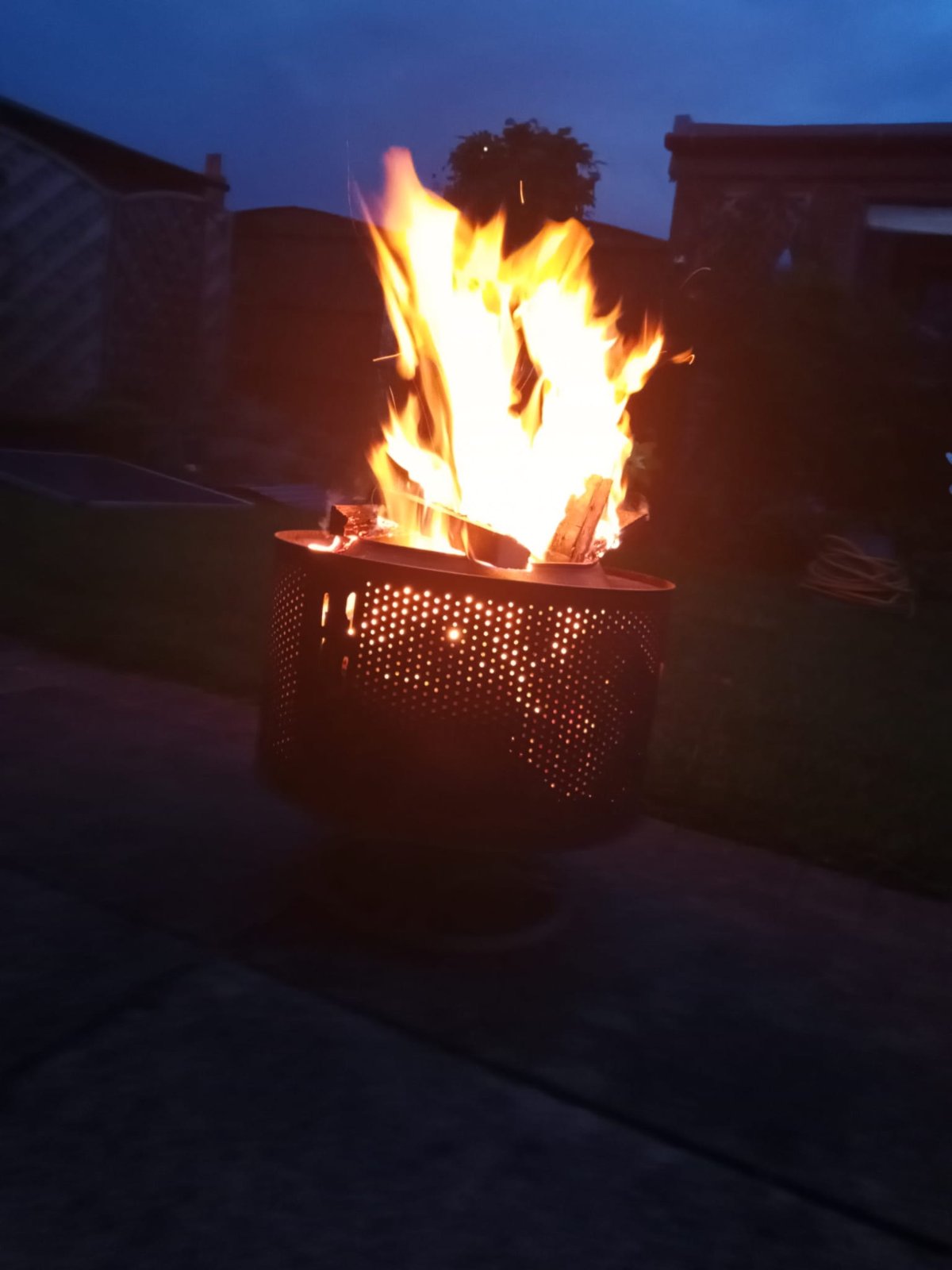

Unread post by MattBLancs »
Old drum makes a good fire pit if you're feeling creative
Washing machine drum with pulley reversed to make a stand

Re: Mid Friday afternoon and..........
Don't you find that soots up your washing though Matt? :-D
Hard to tell what's "sooty washing" and "soot that was washing" after a go in there! :-D
