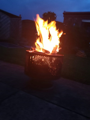

Old drum makes a good fire pit if you're feeling creative
Washing machine drum with pulley reversed to make a stand

Don't you find that soots up your washing though Matt? :-D

Hard to tell what's "sooty washing" and "soot that was washing" after a go in there! :-D
