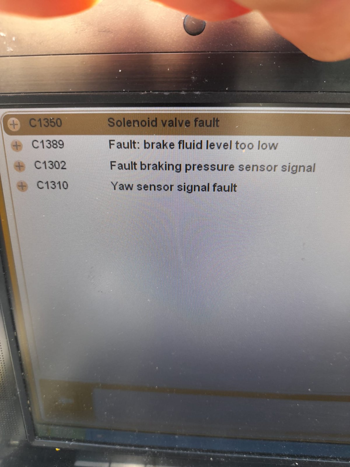

My wifes car has been standing for a year i have finally got round to looking at it, these DTC's have come up when i got it started i wanted to check the wiring for the yaw sensor but can not find it anyone have an idea where it is located in a 2013 Citroen DS3 1.6 eHDI Thank you.

Have got a bit further with this i had access to the AS/ESP pump and ecu i took the plug to the ecu off and water poured out what are your thoughts on if i dry the plug and the pins it goes onto and plug it back in is there a chance it could work again with no faults.
Thank You Stephen.
Thank You Stephen.
- Posts: 12576
- x 1485
Re: DTC's after the car has been standing for a year 2013 Citroen DS3 1.6 eHDI
If there's no corrosion there's a good chance, but only one way to find out!

an update i have got more DTC's now
