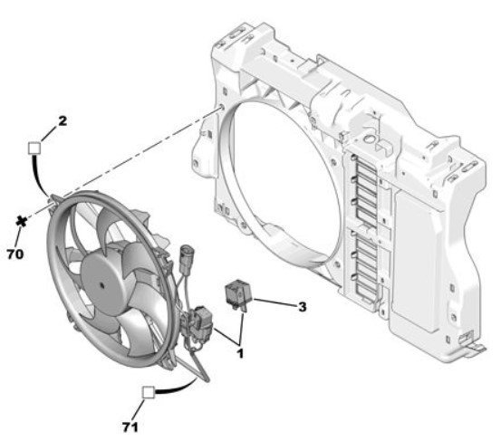

I think it maybe something attached to the main fan assembly but not sure??
I cant find anything about the relay online in order to buy one???

The cooling fan relay (number 3) should be located on the fan cowling. It can easily be tested with a multi meter so dont just go replacing it without getting it checked properly.

I was looking to find item 3 (cooling fan relay) online but cannot seem to find this?? Has anyone got a link to one so I can source it if needed.
