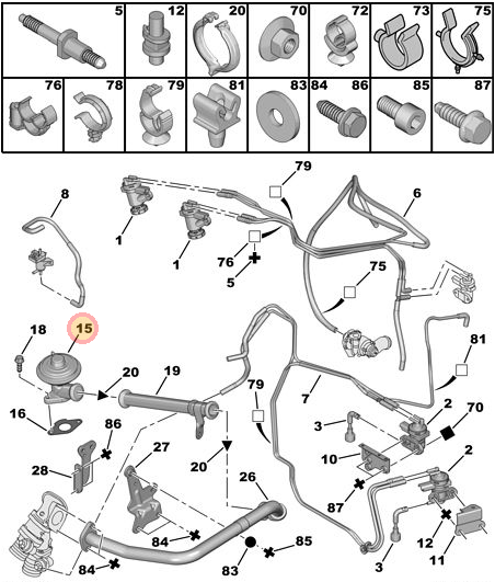

(15) EGR Valve, part: 1628XP (no longer available from Citroen)

Are number 3 and 5 the wrong way round?

Rp0thejester wrote: 24 Sep 2023, 19:22 Are number 3 and 5 the wrong way round?
Not to my knowledge - it's just viewed in the diagram from the back of the engine.
