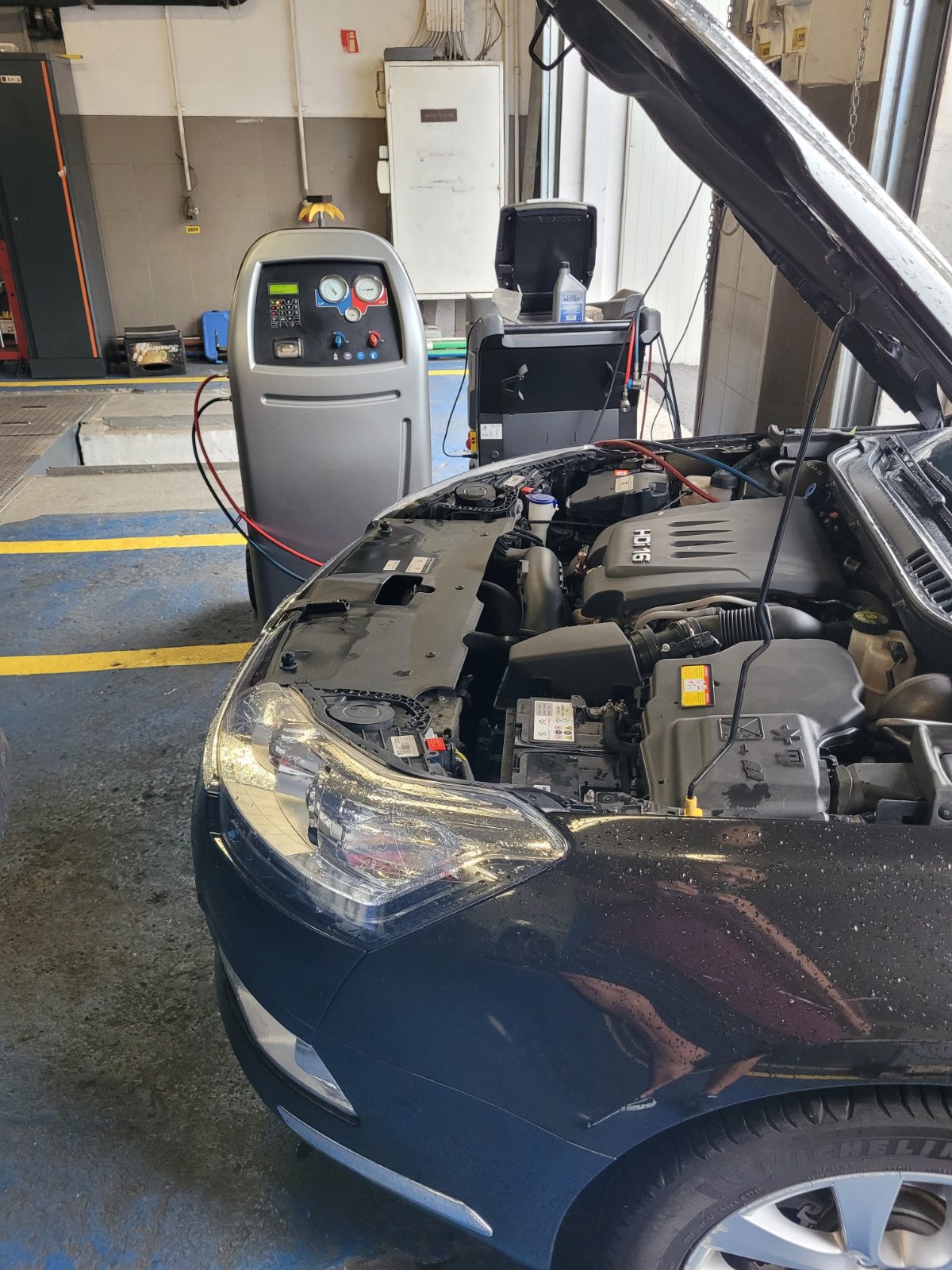

Today I've just refilled my AC system at a dedicated aircon shop:
with the following results:

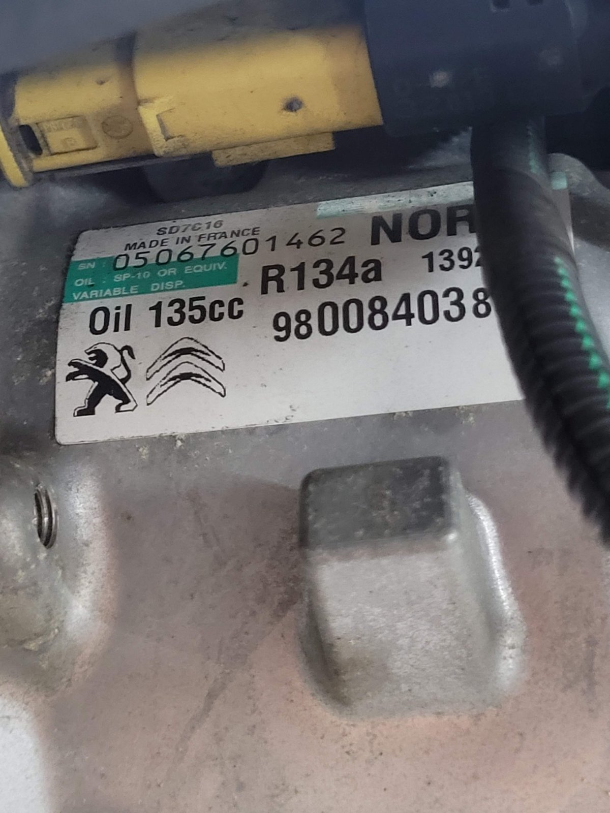

and I was intrigued by the fact that the oil quantity is just 26 ml - even though on my AC compressor it states clearly 135 cc:
I've shown them the picture, but they refused to fill that quantity of oil, saying that the recommendation of the producer of the AC refilling machine is to use 25 ml of oil at each 500g of refrigerant.

Re: C5 X7 refrigerant and oil quantities
When the refrigerant is removed (or leaks), most of the oil remains in the compressor, and can only be removed if the compressor is flushed. So when refilling the system it is normal to only add a little oil to compensate for any lost with the refrigerant.
spiriad
- Posts: 3
- Joined: 15 Jul 2023, 19:36
So should I consider that the procedure was done properly then?
- Posts: 11012
- Joined: 09 Nov 2005, 22:03
- x 1481
Yes, it seems correct.

On any A/C machine i have used in the past any oil that comes out with the refrigerant is separated into a little bottle on the side or back of the machine. You empty it before you recover or some of them have a marker on them so you can see how much oil comes out. You just refill the amount that came out. You dont normally see more than a couple of teaspoons come out.

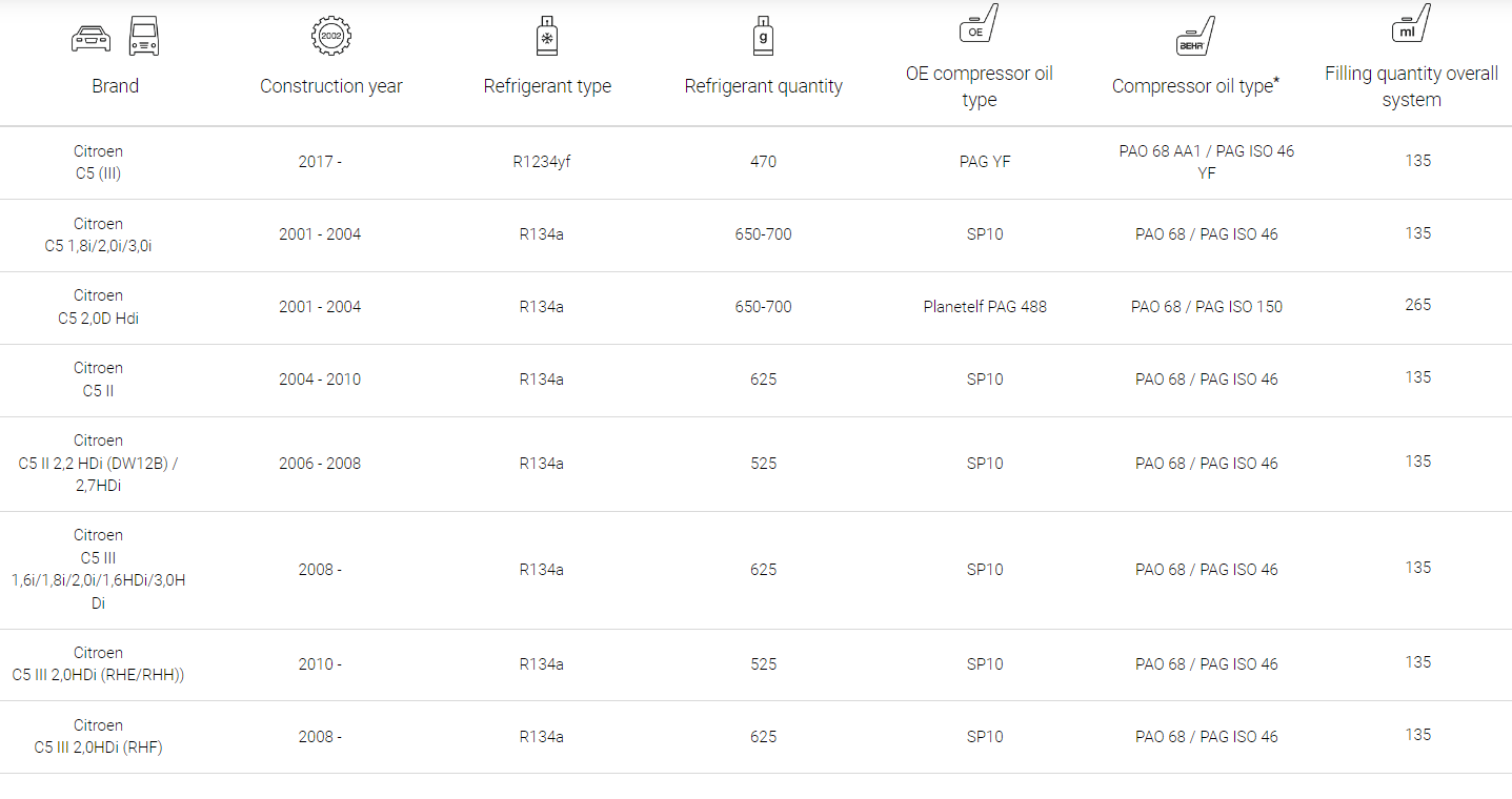

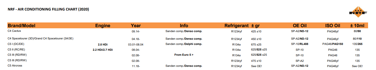

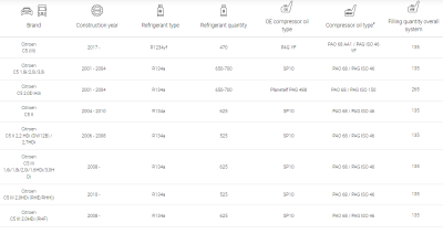

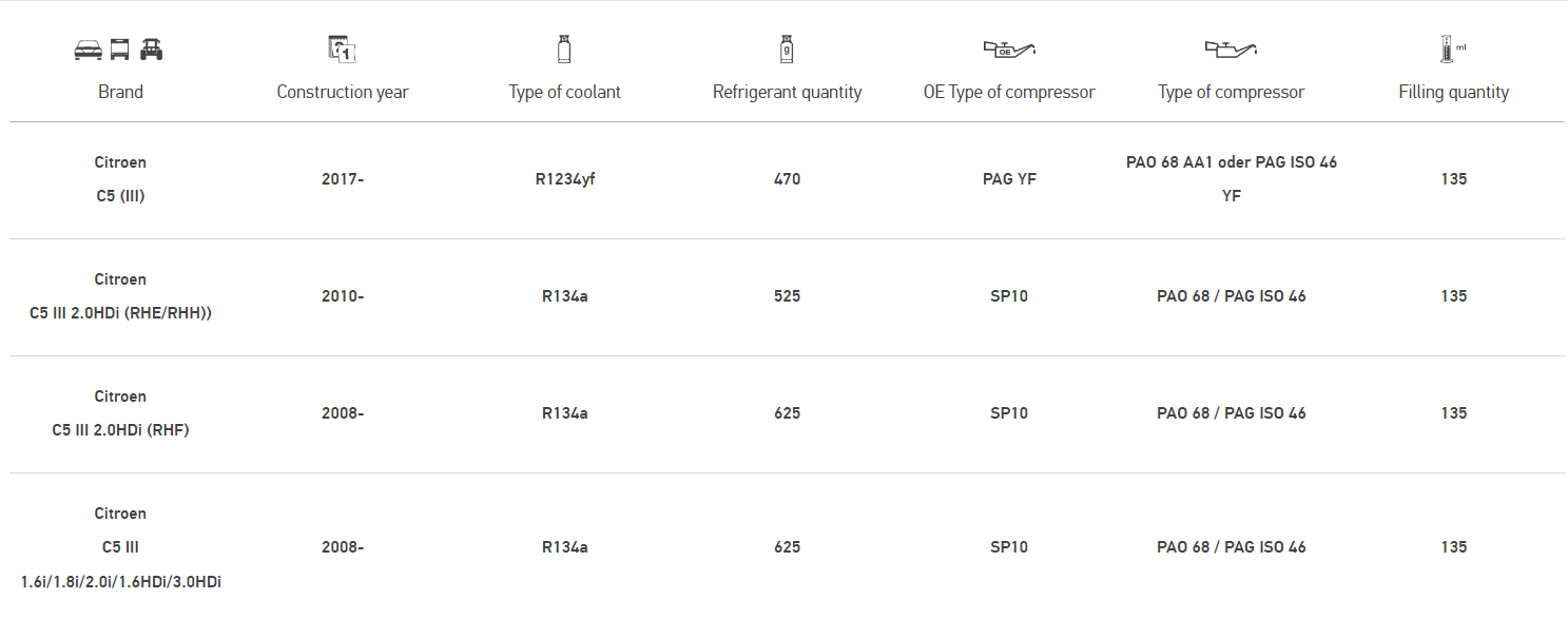

However I've checked 3 sources: And it's not clear what quantity is needed for 2014 2.2hdi: 525g or 625g?C5 X7 Euro 5 Engines (all Types): 525 grammes
The problem is it depends on what make of A/C equipment is fitted to your car. Some years ago I went to a friend to get the A/C topped up on my Xantia, and the label had come off the compressor. There were three possible options (according to his list), each with differing refrigerant quantities. If you take a look at your car you might be able to find out which A/C compressor is fitted, and from that you could work out the quantity it needs.
OnlinePaulC5
- Posts: 2757
- Joined: 06 Jun 2023, 15:26
- x 722
In the engine compartment or under the bonnet there is often a sticker saying which refrigerant is used and possibly the amount.
- x 6950
Refrigerant for the C5 X7
- Euro4 (except DW10BTED4) 625 grammes
- Euro5 (all types) 525 grammes
- Euro4 (DW10BTED4) 525 grammes
