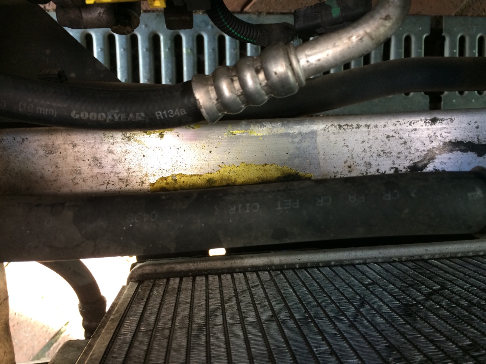

Think I’ve found the problem. The bottom hose appears to have given up.
It looks like wear and tear compounded by the overcharging of the gas.
You can see the fluorescent oil on the cross member just underneath the leaking pipe.
I suppose I should be thanking my lucky starts it wasn’t the condenser or pipe work behind the dash. :-D

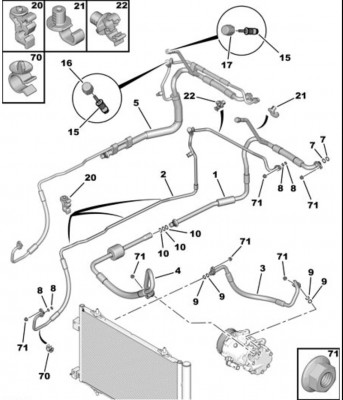

Next question.
Would anybody know what the part numbers are for the four “O” rings on the pipe please?
I don’t suppose they come with the pipe.
I can supply the VIN number.
Thank you.

Re: Air con again!!
Ok, so can you let me know which o-rings you need from which diagram then I can advise of part numbers.
Just refer to Table A or B and tell me the item number.
Table ATable B

O rings are number 9 on diagram A. The hose is number 3.
x 6947
Re: Air con again!!
Ok, give me a second...
So the O-rings are part 6460V0 and are £1.03 inc. VAT each
The Hose is part number 9677930480 and is £78.67inc. VAT
Note these are all zeros not letter ‘O’s
All available to order from Citroen.
