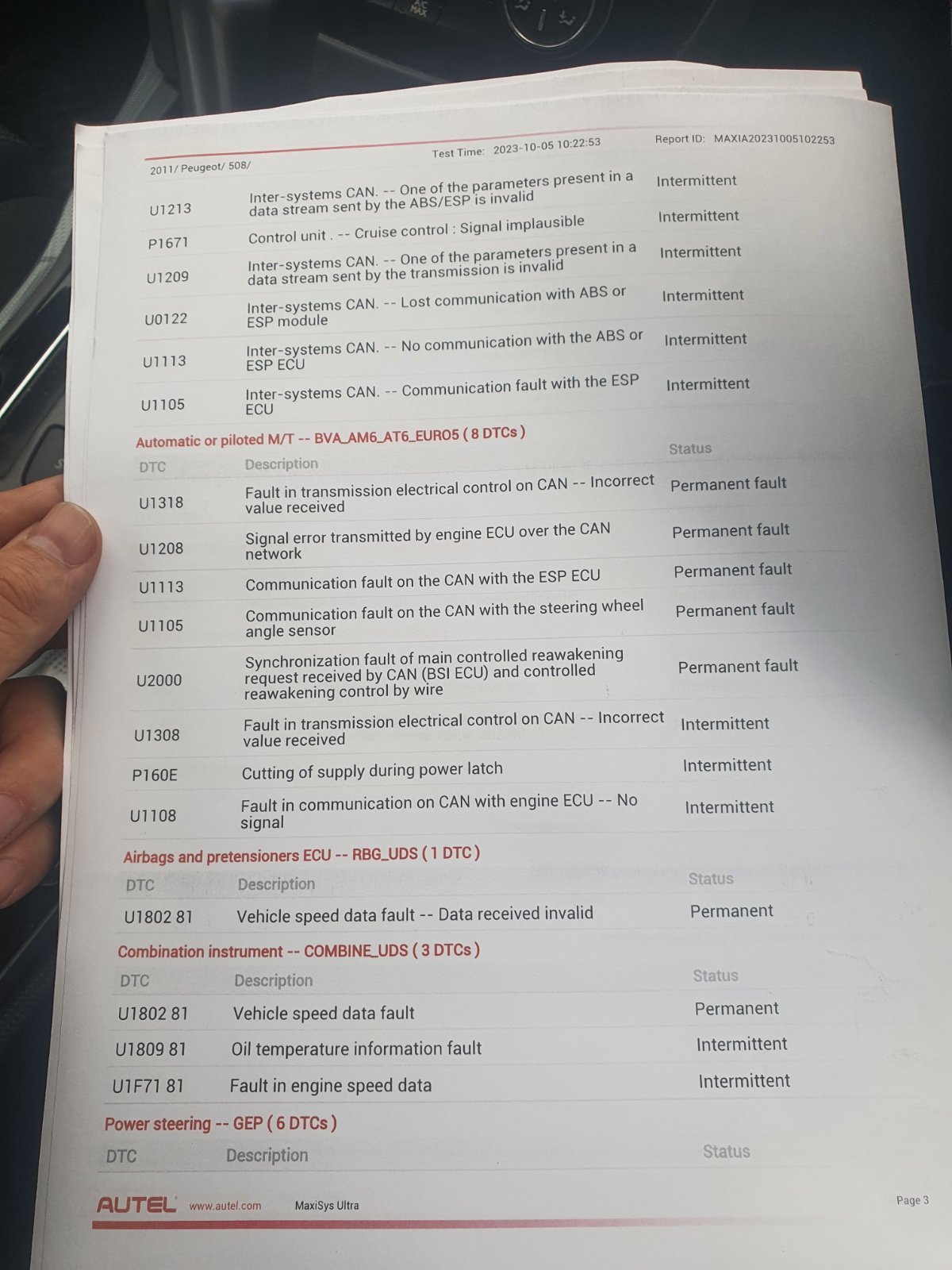

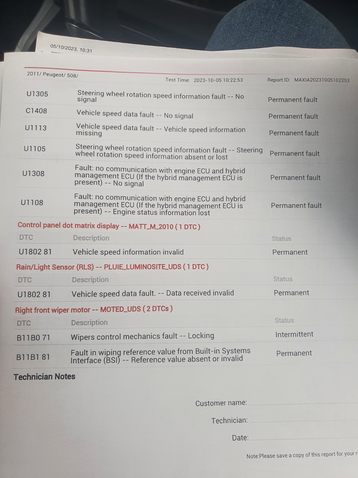

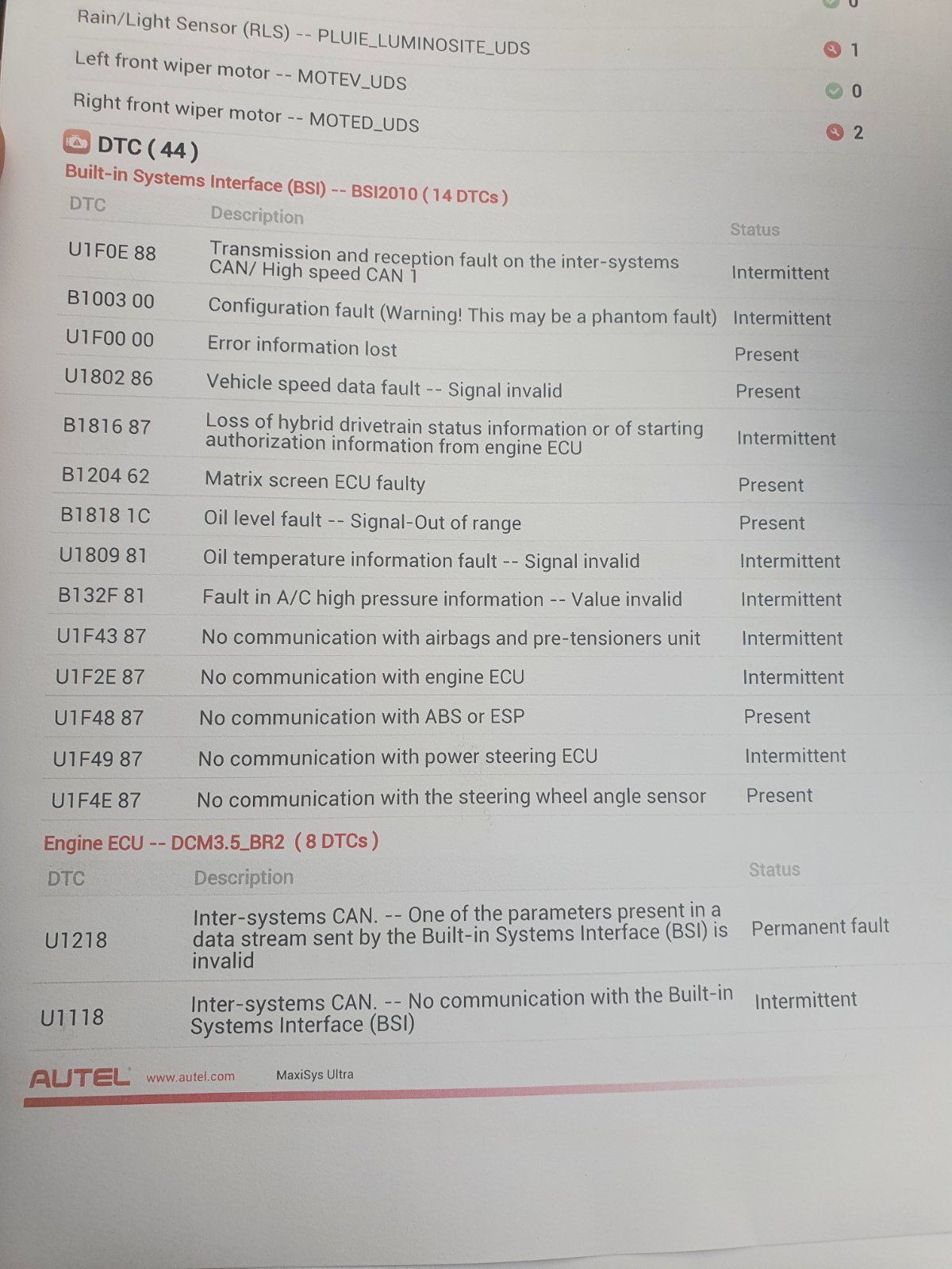

Visited my mechanic, he said that after fuse box change he managed to get down to these faults :
B1003 00
U1209
U1802 81
Vin is VF3**************[VIN obfuscated, can be read by forum staff]
I have driven car home and it came up with usual ABS/ESP/Hill assist, Gearbox fault, Engine fault, also Speedo does not work and rear parking sensors dead.
Thinking to change ABS sensor - with a hope that it will get Speedo working and at clear abs/esp/hill assist faults.

Fusebox has been reconfigured - no changes whatsoever. Garage representative says,that most likely problem is in abs pump as communication for the faults are going through it. These guys are specialising in Citroen and Peugeot, but previously it was them to say,that fuse box will solve a problem and gave me quoted £800 for it(baught second hand and got it fitted for £100).
Is it worth to give it a try and change abs pump?

Unfortunately without detailed investigation there's nothing I can suggest, because you have CAN network comms faults. That could be communication on the CAN wiring or the BSI or another system like the ESP ECU.
The issue is the CAN network links all these systems so knowing if it is the CAN wiring itself somewhere or one of the main ECUs like the BSI, the ESP or the Engine ECU that is either itself faulty or is sending faulty data it is receiving....
If it was me, I would be taking it straight to the dealer for a proper check - they are likely to have the experience of this sort of thing and proper diagnostic tools for troubleshooting, as well as access to technical resources in France the indy won't have.
They also would of ripped you off on the fuse box in any case, as the engine fusebox from the dealer brand new is only £405, or £365 if the supplies and management protection unit inc. VAT. and I can't see them charging £400 to fit it.
