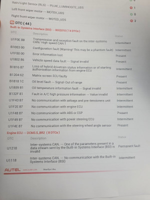

Visited my mechanic, he said that after fuse box change he managed to get down to these faults :
B1003 00
U1209
U1802 81
Vin is VF3**************[VIN obfuscated, can be read by forum staff]

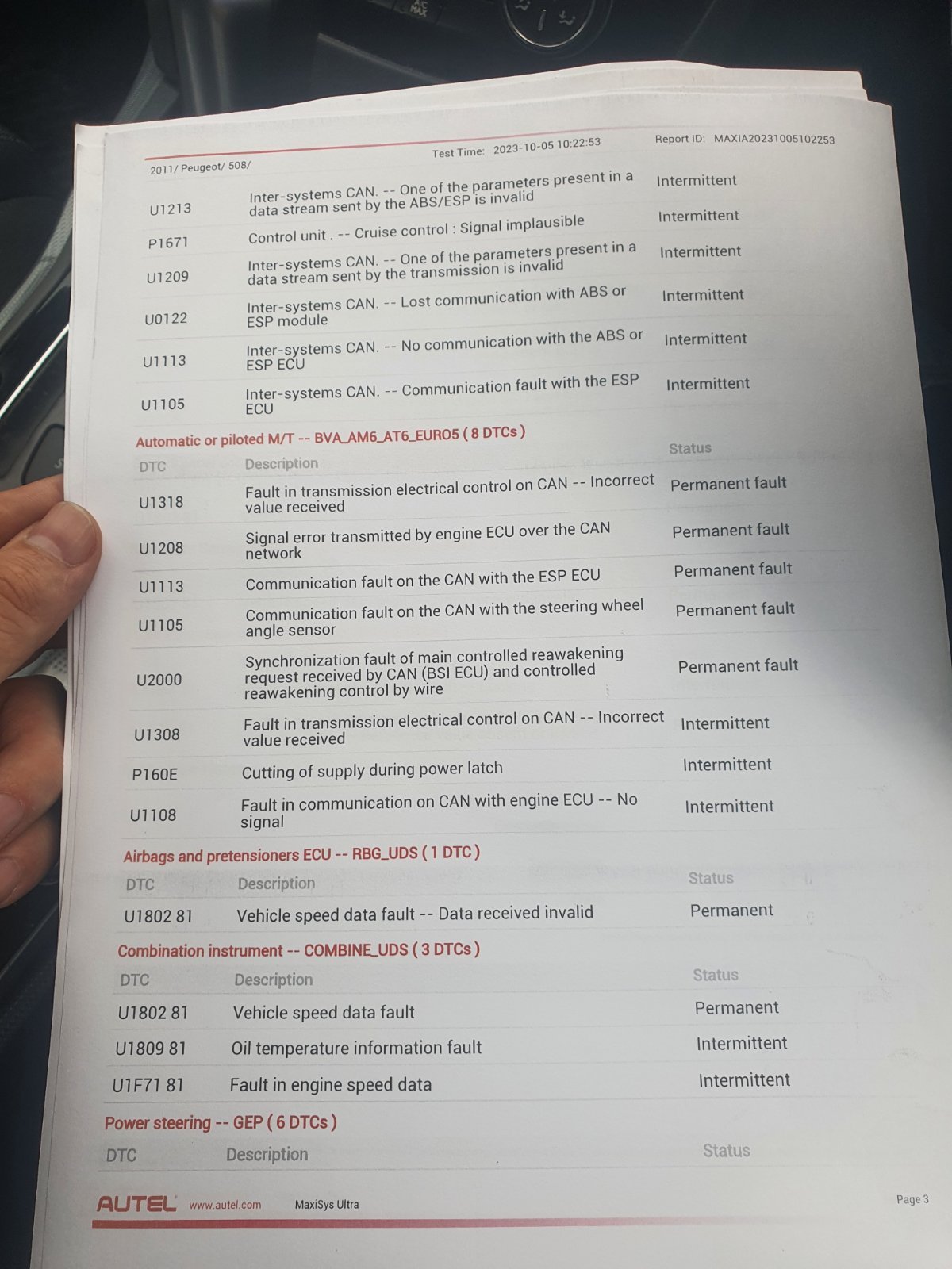

I have driven car home and it came up with usual ABS/ESP/Hill assist, Gearbox fault, Engine fault, also Speedo does not work and rear parking sensors dead.
Thinking to change ABS sensor - with a hope that it will get Speedo working and at clear abs/esp/hill assist faults.

Ok, I think there is another issue. Your 'mechanic' may not be aware that on this vehicle the engine fusebox MUST be configured. It has configuration options that need to be checked and set for the vehicle to work correctly. That is likely why you are getting this first fault - as it is not configured!
B1003 00 is a general configuration fault. No further info available.
B1802 81 Vehicle speed information not valid fault (This will affect multiple systems from the dashboard, seat belts, lighting etc.)
U1209: Fault: absence of communication with the automatic gearbox ECU : Data invalid
So the absolute first thing I would do is to go and get the replacement engine fusebox correctly configured.
I can help with the options to be configured, but it is going to take me some time to go through your vehicle specifications and the configuration options and select the correct options for your vehicle, so will take me a few hours.

Unfortunately without detailed investigation there's nothing I can suggest, because you have CAN network comms faults. That could be communication on the CAN wiring or the BSI or another system like the ESP ECU.
The issue is the CAN network links all these systems so knowing if it is the CAN wiring itself somewhere or one of the main ECUs like the BSI, the ESP or the Engine ECU that is either itself faulty or is sending faulty data it is receiving....
If it was me, I would be taking it straight to the dealer for a proper check - they are likely to have the experience of this sort of thing and proper diagnostic tools for troubleshooting, as well as access to technical resources in France the indy won't have.
They also would of ripped you off on the fuse box in any case, as the engine fusebox from the dealer brand new is only £405, or £365 if the supplies and management protection unit inc. VAT. and I can't see them charging £400 to fit it.
