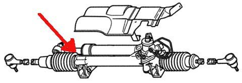

I am struggling with a steering rack boot.
------(Right hand side/LHD drive V6 Activa)
The boot has popped of (at red arrow) and I cannot work out a way of reattaching it .... I thus cannot secure it with a new ligature.
Does anyone have advice about the best way to do this job ?
Getting my hands in there seems imposable !

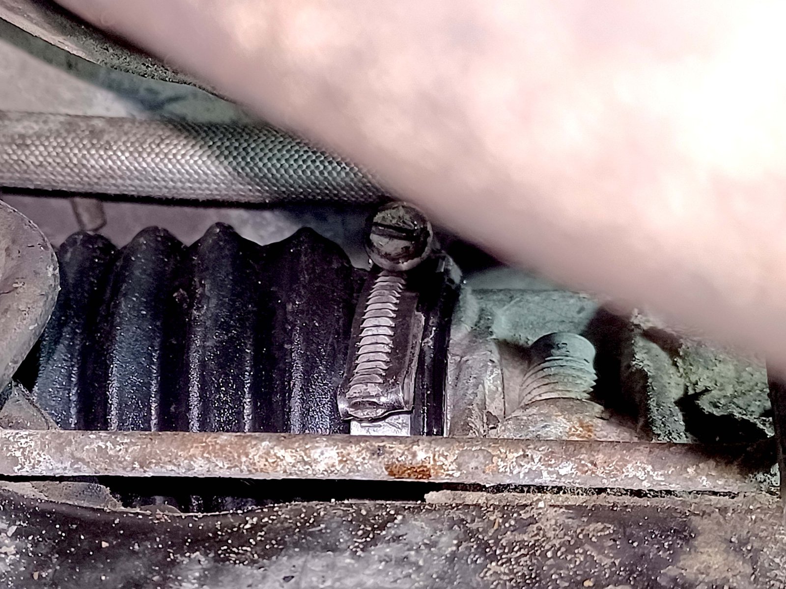

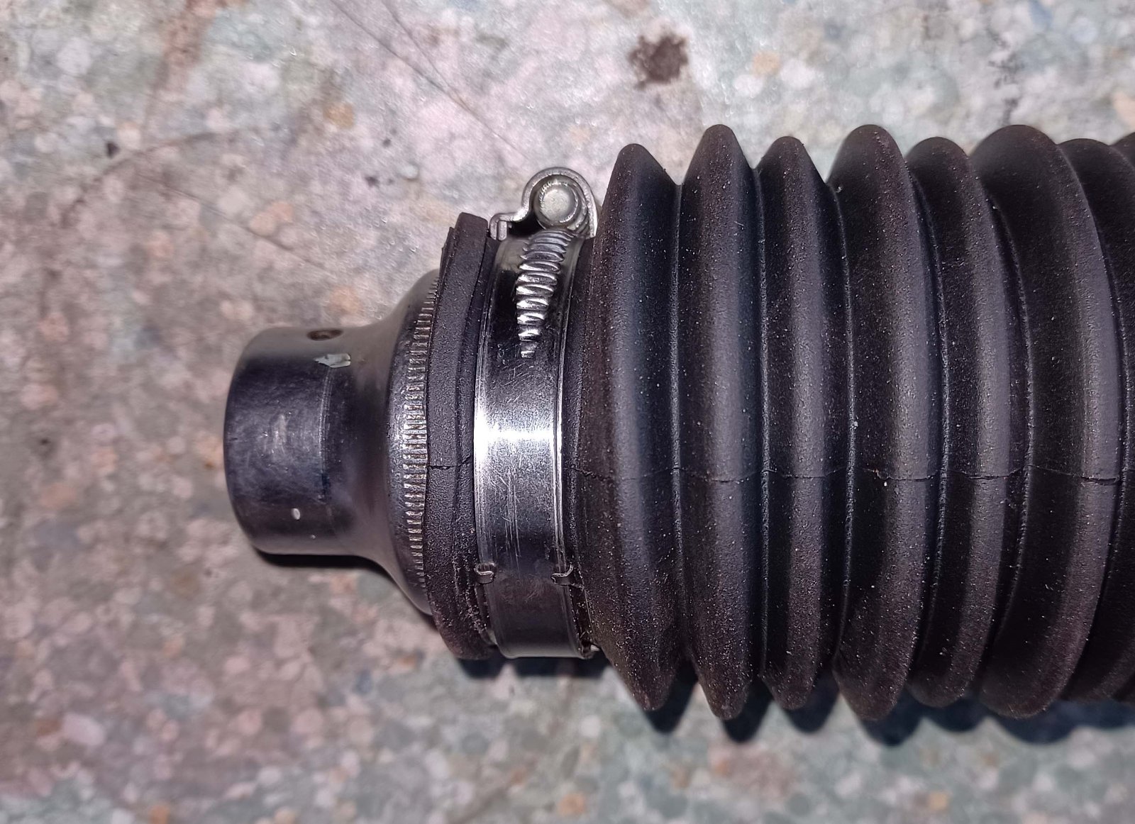

Update:
Attempt No2.... This is the method using a same size socket, a matching boot and the same type of jubilee clip.......this shows how tight it can grip.
I gripped the socket in my vice and pulled the boot as hard as I could, it did not come off (nor did the socket launch itself at my face.....that "errr moment of danger came after the experiment ! )
and this the same on the car......I am showing the boot at full steering lock so max stretch.
I will leave it like this all day to test/see if it slips off and maybe "set" the rubber boot (if it does such a thing)......
I will fold the "tail" of the clip out of the way of the boot later to make sure it does not catch and damage it.
