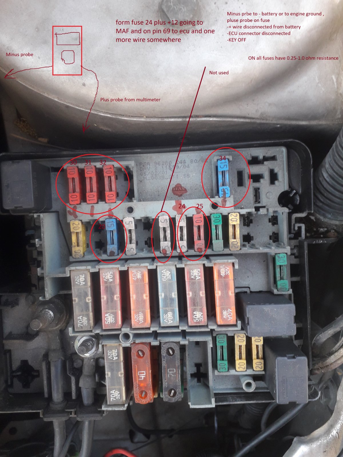

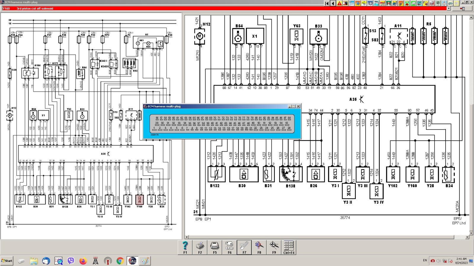

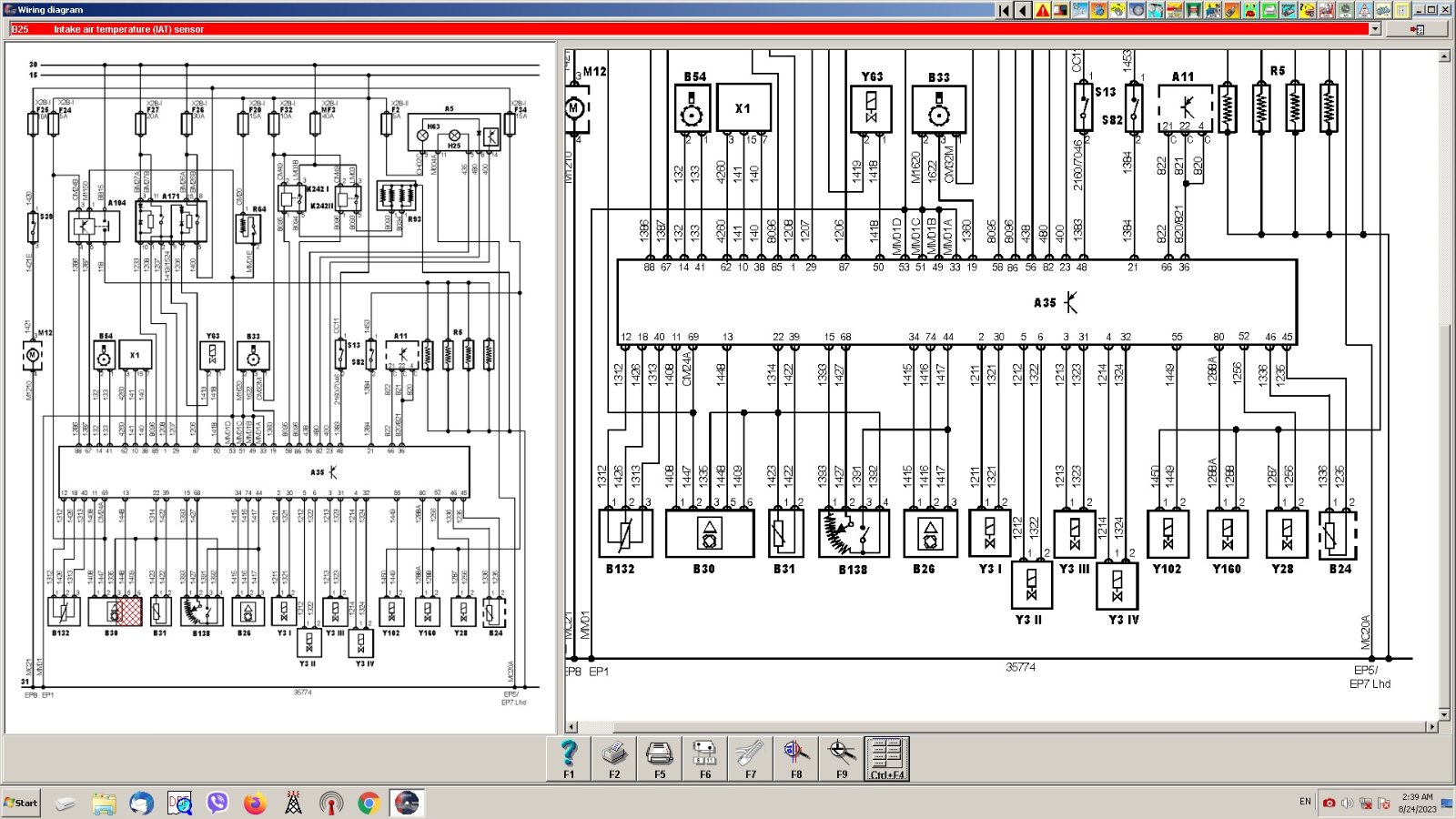

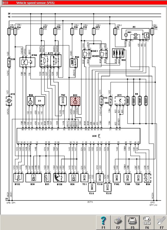

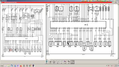

One more thing when engine is off (key is off position) and I check installation from Autodata +12v from fuse to sensor is Grounded some how from multi meter when put - probe on minus on battery and + to no2 pin on sensor is 0.25ohm like short ,
then I go furthered and check,

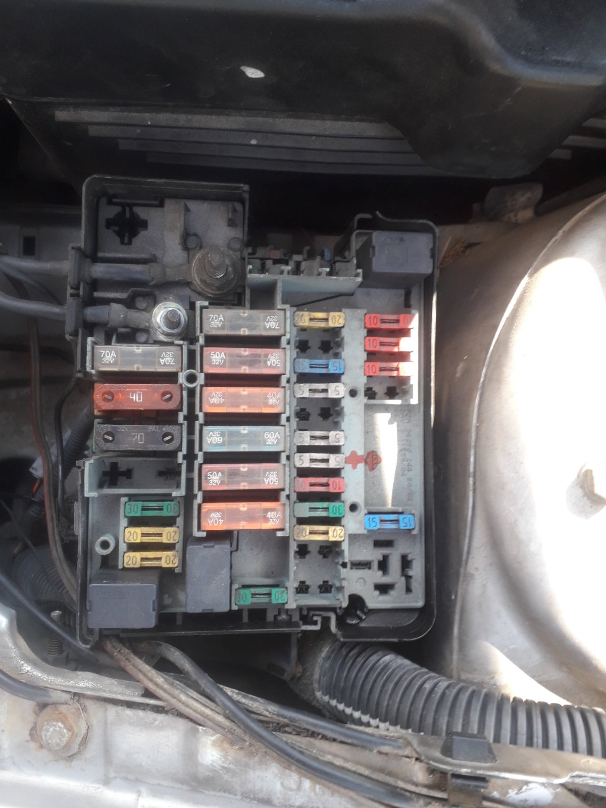

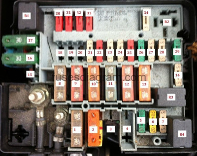

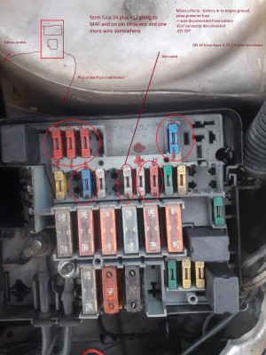

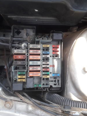

Disconnect + from battery And also DISCONNECT ECU connector and measure minus probe from multi meter on - of battery and + probe I go to fuse on engine side (check from photo and find short on some fusses like 0.25 ohm to 1.5 ohm between - from battery to this fuses,..

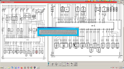

For me this looks strange because I see that on KEY OFF the pin 86 on ECU is only grounded by autodata ,all other + I thing by diagram must NOT be shorted to Ground ?!?!? Any help if someone knows next steps to do ,
Its loook like somwhere is short to + form GND
If someone have some better diagram of car can post here please

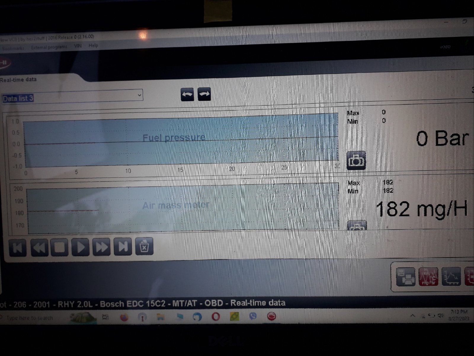

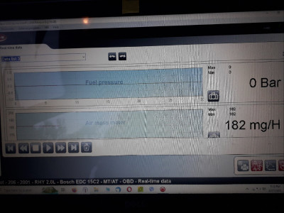

Only remain one thing when engine is off
Maf showing 182 mg /h need to be 0
Eny help welcome .....
Without egr disconected still maf going to p0101 max flow , and on idling 670 to 700 mg must be around 500mg ,
Is it possible to do some calibration of the sensor ,
