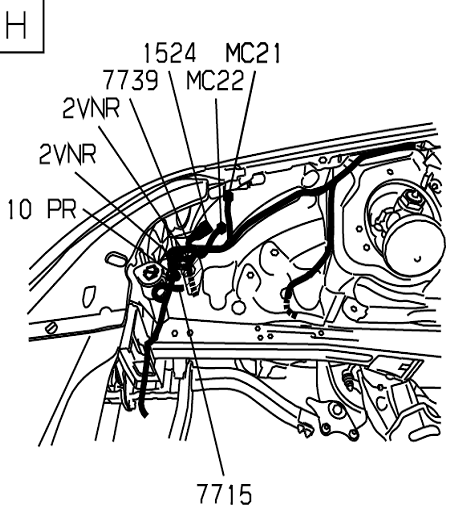

Is the pump operating / making a noise?
Check fuse G39 in the cabin fuse box.
Check Fuse F01 in the fuse box at the battery outlet.
Check the Supply Cut Off Relay (1524) as shown below:
