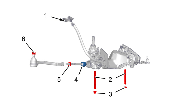

I have some play in my inner tie rods on my Citroën C5 Aircross. Do someone know the tightening torque for the inner tie rod on this car?

Here you are:
IdentificationDescriptionTightening Torque
(1)Nut (Electrical harness / Body)1,2 daNm
(2)Studs (Steering mechanism)0,75 daNm
(3)Nuts (Steering mechanism) (*)12 daNm
(4)Steering rods7 daNm
(5)Locknut (Adjusting the steering track rods)6,7 daNm
(6)Nut (Steering ball joint) (*)6 daNm
(*) Always to be replaced whenever removed

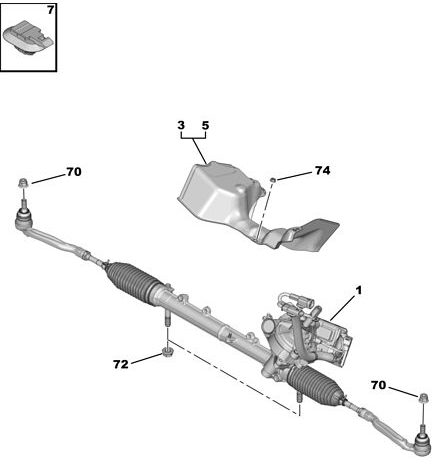

I can't seem to find the anti rotational tool anywhere to counterhold the steering rack shaft. Do you know if there is a flat spot on the shaft where a wrench can be placed?
If that's not the case I'll try to counterhold with a pipe wrench and wrap some rubber tube around the shaft for better grip.

You'll be the best judge of that having one there to see, but here's the rack:

Hard to see with the boot in place. I know that other makes that have flat spots on the steering rack shaft place it on the drivers side of the rack. Luckily my driver's side is also the one which is the bad one. I'll update this post when I do the job so other people know if they can use a spanner to counterhold😁
