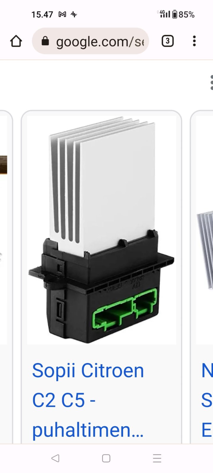

I put attachment pic, what was replaced when car got to service last week.
So I think that unit is already changed. Can there be something else?

Re: Citroen C5 air condition problem and engine fault
If you buy a cheap one then it's common for these to not work. Get a decent branded one.

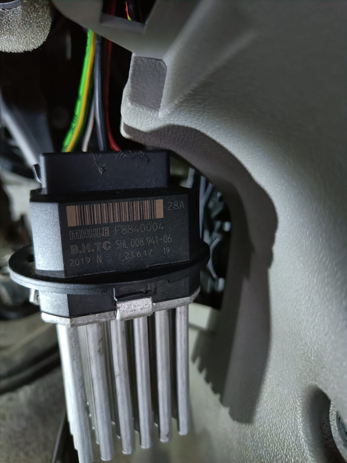

Here's the pic what was changed. Does it look genuine?
It wasn't changed by me but in Citroen's brand maintenance company here in Finland.
Unfortunately I don't have the error codes, but the repair guy now thinks its something to do with webasto.
Opinions?
Ok, so you didn't mention that before. I can't help you with the Webasto additional heating system as we don't generally have it over here.
