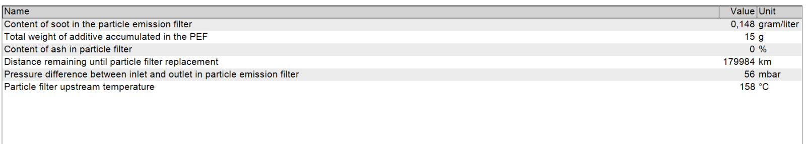

Second one is DPF, I change already EGR valve (mapping done) as it was showing that is not working, that`s gone. Also DPF differential pressure sensor is changed. Unfortunately i still have fault:
P1490 - Particle emission filter, overloaded
- Permament
P242F - Particulate filter clogged
- Permanent
Any ideas? I should change steering wheel sensor and DPF ?

luk_wro
- Posts: 3
- Joined: 05 Aug 2023, 19:28
Re: ESp and DPF faults C4
ok i do some test using delphi and it show that ash in dpf is 0%. Its possible or its some mistake?
