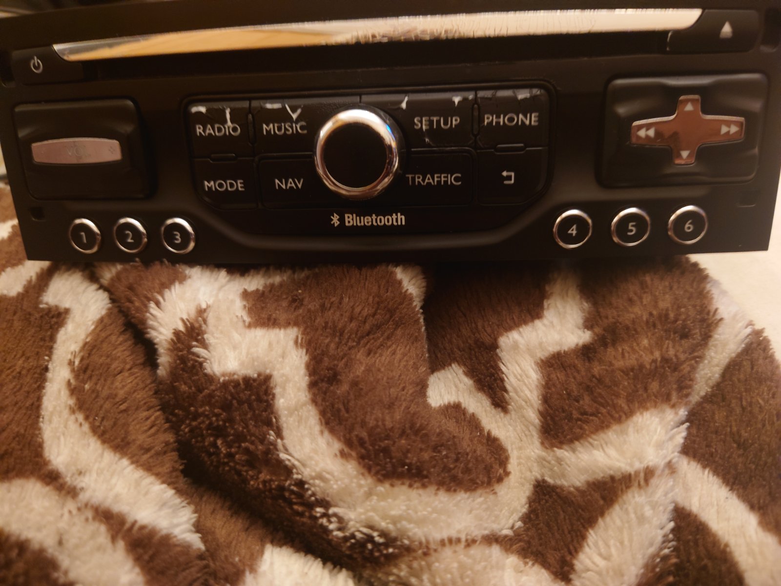

Hi, I wonder if anyone can help.
My radio stopped working, along with, nav, parking sensors etc. The slot makes a sound like it wants to eject, every 10 seconds. The screen is also blank. I've tried a reset by pressing the eject for 10 seconds, the screen moves forwards and then back once.
I've checked all fuses etc and nothing.
I've searched this and other forums, found other people with the same issue, but I can't find a solution.

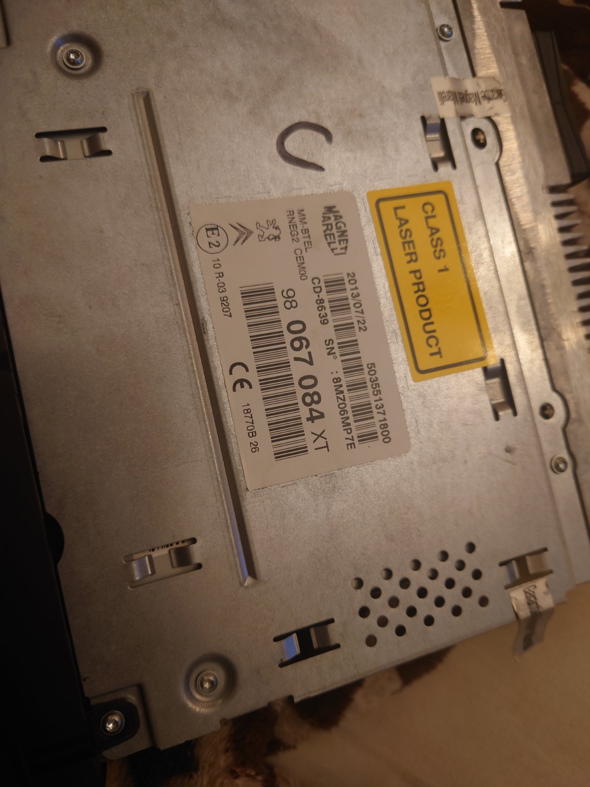

Opened the unit up and removed the SD card, diskgenius on my pc shows 3 partitions. Two about 1.5 GB and one at 7gb. This last one shows damaged.
Could this be my issue?
I can view all the files. I tried cloning, but the cloned one also shows the third partition as damaged.
Is there a way of obtaining a copy of the SD card, or the files online somewhere?
Any help would be greatly appreciated....it's doing my nut!

It's likely the MicroSD card has or is failing. This can also happen if you have upgraded the firmware to V2.86 and it has not installed correctly.
I wouldn't suggest you do anything with the partitions in Windows, because the system uses a different operating system and you can easily corrupt the files and partitions as Windows leaves system files on the media.
There is one partition with the user files and also the vehicle configuration data that if corrupt, damaged or missing will leave the system unbootable like you are experiencing.
Do you know the current version of Firmware that was on the system? If not, you may have no choice but to try and use V2.86 to recreate the partitions and operating system. However, if you have not been able to take a backup of the use configuration partition using Mirascripts, then there is little chance of doing so in its present condition.
I suggest you replace the MicroSD card for a new one and install V2.86, but be warned this may still require a dealer visit to configure the unit with the vehicle options like parking assistance, language etc., which can't be done using Diagbox. The ECU will go into secure mode and needs dealer level connected access to restore the options.
