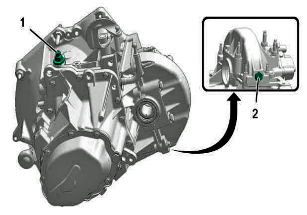

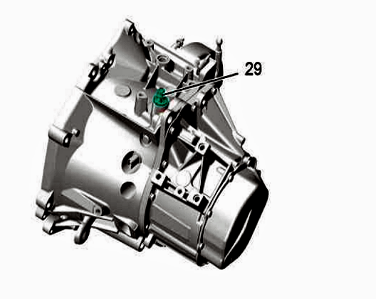

These boxes are "sealed for life" as stated by Citroen, but quantities of oil stated below will be for a new gearbox prior to having any oil in it. After draining, capacity will be 1.8 litres. You will have to completely drain it and refill it though, as there is no measurement check
Oil is filled by the air vent hole (29)
Draining / Refilling
(1) Vent hole.
(2) drain plug.
Remove the cap (2) to perform the draining.
Oil capacity gearbox empty: 1.9 ± 00.15 litres.
Oil quality: ESSO 75W80 EZL 848 or TOTAL 75W80 H 6965.
