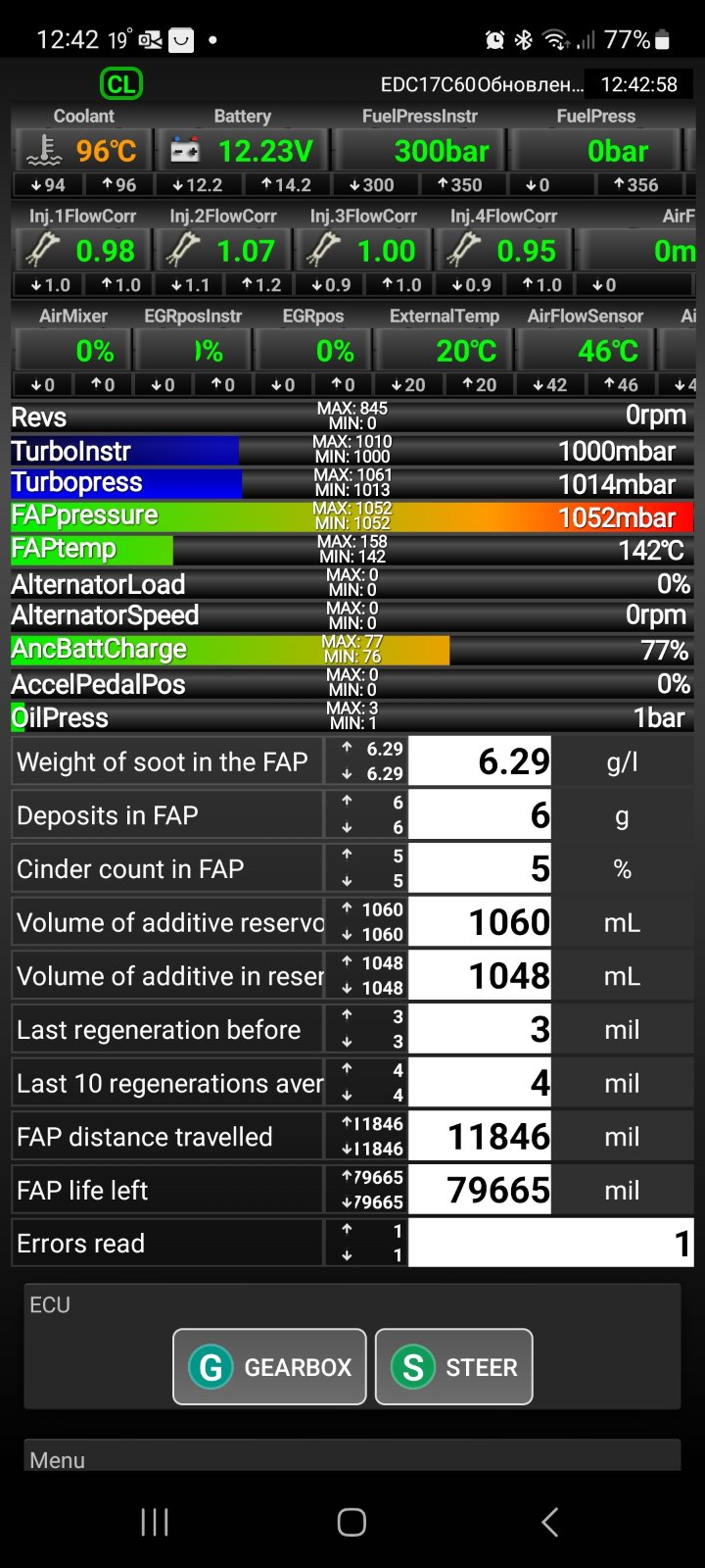

I recently bought Citroen Grand Picasso 2015 1.6 diesel with a "normal" autobox. The car drives ok and I don't have any issues.
I got myself an OBD device with FAP Android app just to see what is going on there.
For some reason, the DPF pressure sensor is showing a weird value that is too high. I went there to see if there is something wrong with the sensor, but I could not find it. From the internet, I learned that it should be just above the alternator, but there is nothing there. No pipes, no plug, no sensor. I did not have a chance yet to raise the vehicle to trace the pipes from DPF to sensor. Start-stop feature stays turned off at all times. There is no error codes or messages on the dash. Recently add 7 liters of Ad-blue just to keep it topped up. Battery is over 70%. The car did 106000 miles

Hello, thank you very much for your reply.
I don't drive too much. For last 2 weeks car been mostly stationary. I drove few times on the motorway (under 50 miles) and localy to get some adblue.
The pressure according to that program is higher that turbocharger pressure.
Car drives without any issues and is quite agile if you put the foot down.
According to Citroen website this car has 2 recalls pending. I will see what Citroen dealer will advise tomorrow.
Is it possible to locate the pressure sensor without jacking up the car?
I forgot to mention that pressure stays constant at all times

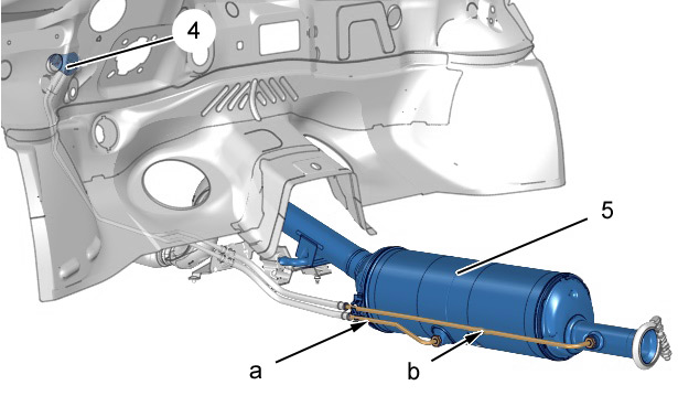

The particle filter has upstream (a) and downstream (b) pressure sensors for which the pipes for each are shown below. The sensor itself is located in the engine bay.
See what the dealership says, but I suspect at this mileage they will advise on a filter replacement. You can have them deep cleaned. There are places that can do this, but you will need a professional level diagnostic tool to advise the engine ECU that the filter has been replaced if you do opt to clean the existing one. I doubt the FAP app can do this.

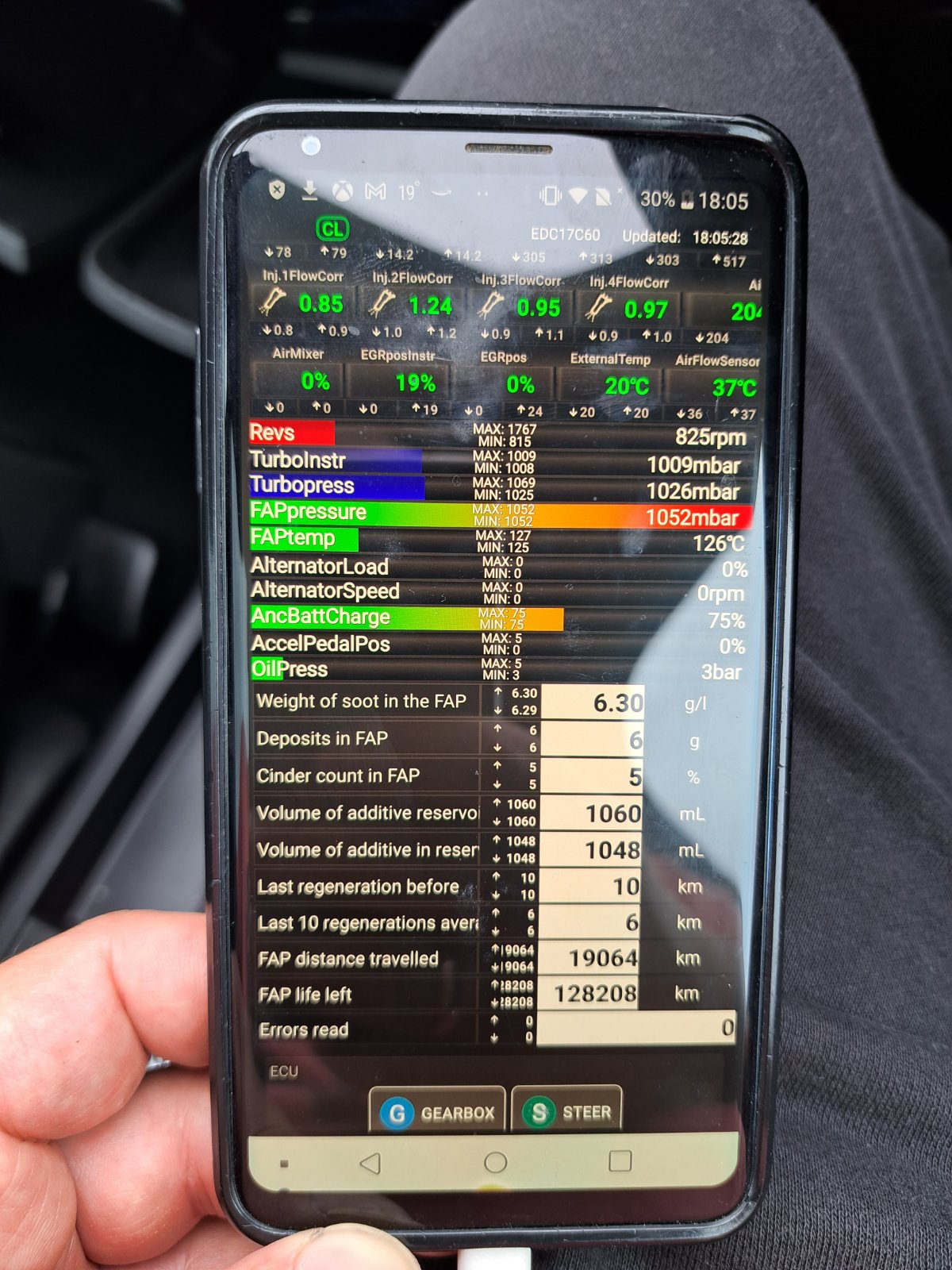

Would you say from the height of your experience that pressure is way too high for the car to start? Given the fact that pressure is always constant could it be that someone somehow changed the program in the car to trick it not to show any fault codes?
Something tells me that something is really not right here either with my diagnostic method or the car itself. I got about 2 weeks left to return the car back to the dealership I bought it from....

There's only one sensor, it's differential. It's on the firewall behind the battery somewhere. I wouldn't trust values from a device like that - if the car is happy, leave well alone!!

Thank you very much, Richard. I am just worried that's all. I browsed internet for DPF problems and it seems that 35-50 mbar is when people start having problems. Mine shows over a 1000mbar and it always stays the same regardless if car is running or not. I will see how much dealers diagnostics cost and what they say about pictures above. Also start-stop is off permanently and impossible to turn on. Again 0 codes.RichardW wrote: 21 Jul 2023, 22:40 There's only one sensor, it's differential. It's on the firewall behind the battery somewhere. I wouldn't trust values from a device like that - if the car is happy, leave well alone!!

Hello Everyone.
Just to wrap it up:
When the Fap pressure is unreasonably high, but the car drives OK (there could be an error and there could be no errors) it means that the deferential preassure sensor is:
1)Defective
2) Unplugged
3) Broken wires/corossion
In my case the sensor was unplugged and after plugging it in everything went back to normal. Preassure is perfect and filter in in perfect working condition.
