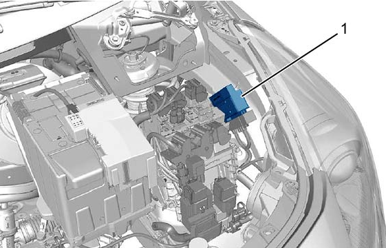

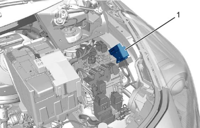

Check for signs of corrosion on the connector of the 3 relay switching and protection unit. If this shows signs of corrosion, replace it.
When faulty this can cause activation of the headlamps and wipers after ignition is switched off and the BSI goes to sleep.
Having said that, you should really get a diagnostic done so see what other faults are showing then post them up.
