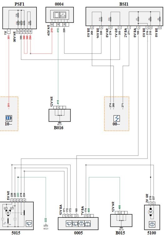

Looking at the diagram it looks like a pretty basic circuit, It doesn't look like the BSI has anything to do with the wash/wipe control apart from suppling the power, its a single power supply so as its working on full speed i would initially rule out a BSI or fuse issue. Looks like the motor has some sort of speed control circuitry internally. You really need to get to the motor electrical connector & see if you are getting switching signals when the switch is operated to the lower speeds. if you are getting these i would suspect a motor fault.

I'm just relaying that I know another person who had this issue - tested the motor for power and was only getting 12V on the fast speed, nothing at the other speeds. Reset the BSI a few times after cleaning the contacts on the motor and it all worked.
Wires 170 and 216 are 'unknown', but I'd certainly have a check at the connections at the motor plug identified as 5015 in the image below and make sure they aren't contaminated:

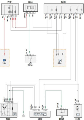

Yes, thats a mk2 diagram. I guessed it was mk2 as it is a 2015.
If it happens to be a late registered mk1 then that will be even more basic as its not even multiplexed.

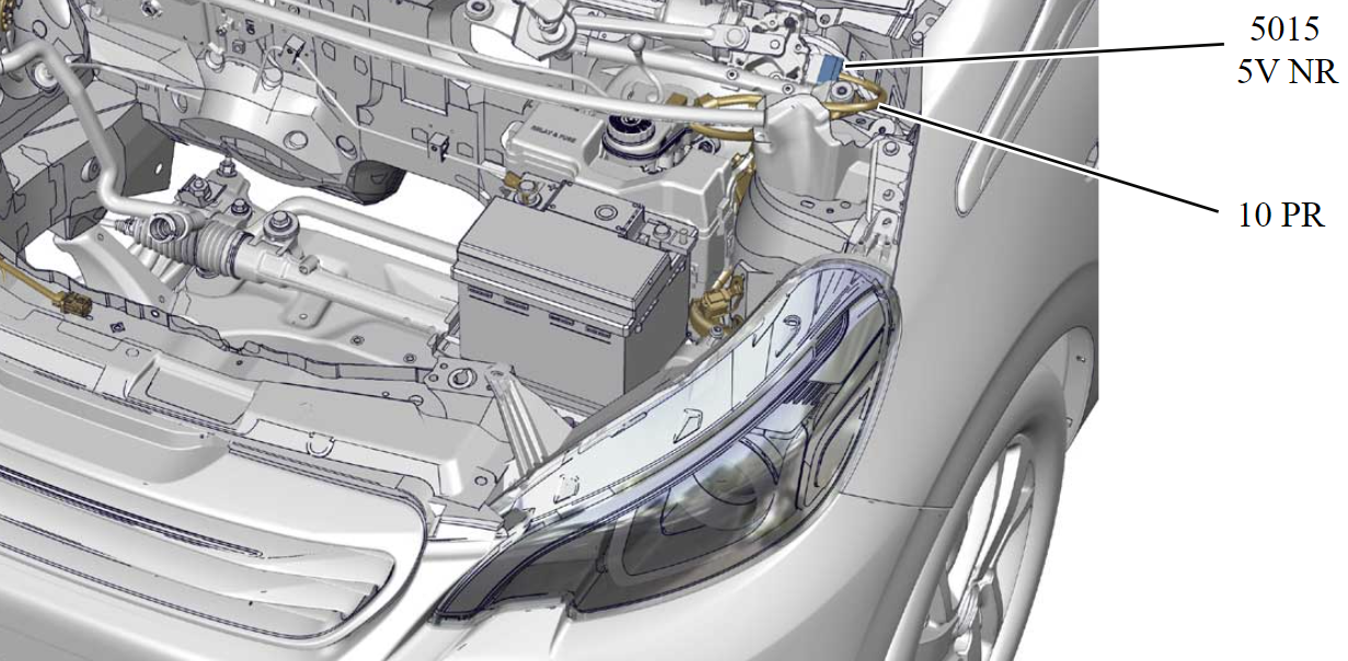

Yes, I just checked the diagram again. Just added a picture for location.
