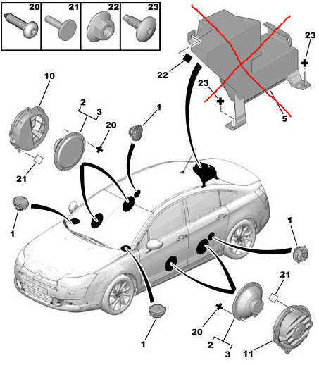

Re: c5 x7 speaker sizes
(1) TweetersJay-Bruce wrote: 12 Jul 2023, 23:25 Simple question, looking for the locations and sizes of the speakers in our X7?
(2) / (3) Speakers
Note: You don't have the HiFi option, so won't have the deeptone speaker shown at (5)
You probably won't have the additional pair of tweeters in the rear doors. just the normal speakers, as these were likely part of the HiFi option.
There are no dimensions provided for the speakers, so you'll likely have to whip the door cards off, to get to the speakers themselves.
Be aware that the main speakers are held into the speaker enclosures with 4 bolts, but the speaker enclosures themselves are rivetted in place, so will need drifting out to remove - so unless you are replacing with a speaker that will be compatible for the enclosure / fittings, you may have to replace these too.
