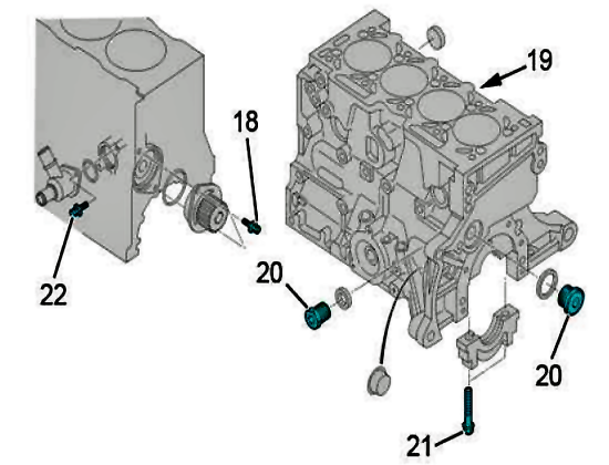

Here - it is 20 N.m
This is the conversion:
Newton metre (N•m)20
deca Newton metre (daN•m)2
kilo Newton metre (kN•m)0.02
deci Newton metre (dN•m)200
centi Newton metre (cN•m)2000
milli Newton metre (mN•m)20000
micro Newton metre (?N•m)2 E+7
Newton millimetre (N•mm)20000
| Reference | Designation | Tightening procedure |
| (18) | Bolts - Coolant Pump | Tightening to 2 m.daN |
| (19) | Knock Sensor | Tightening to 2 m.daN |
| (20) | Plug - Lubrication System | Tightening to 2,5 m.daN |
| (21) | Bolts - Crankshaft Main Bearing Cap Casting | Tightening to 2 m.daN |
| (21) | Bolts - Crankshaft Main Bearing Cap Casting | Angular tighten to 49 ± 2 ° |
| (22) | Bolts - Coolant Inlet Manifold | Tightening to 0,8 m.daN |
