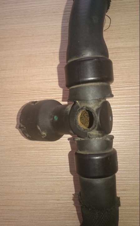

So I've notice a bit of a dribble on the T piece at the joint that holds the thermostat sensor and distributes the water around the engine.
The part 1351KT seems like it is only sold is a complete hose set, although I only need the T piece.
Seems this is a known issue and will only get worse with age.
Here in Australia it will cost me around AUD$300 from the EU (sold in EU for around EU130 plus shipping / taxes).
A second hand one is likely to have the same joint issues.
I'll look at getting it plastic welded and see if that solves it at least for the short term.
I'm toying with just replacing the T piece with a 25mm equal stainless steel Tee (AUD$7) or 22mm plastic Tee ($AUD2) with a couple of hose clamps / a rubber hose joiner to the engine and finding somewhere else to put the thermostat sensor (probably into the aluminium fins of the radiator for max heat transfer) or machining a screwed fitting into the stainless steel Tee to suit.
Anyone have any other suggestions / other work arounds / after market tips ?
407 hdi 2.7 leaking thermostat t piece 1351KT - options

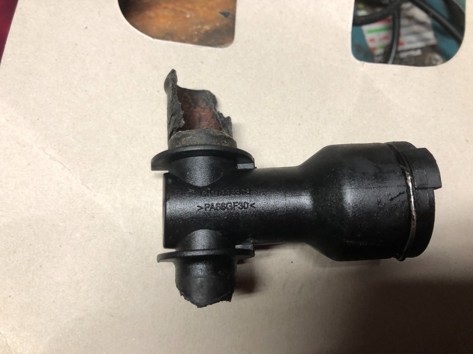

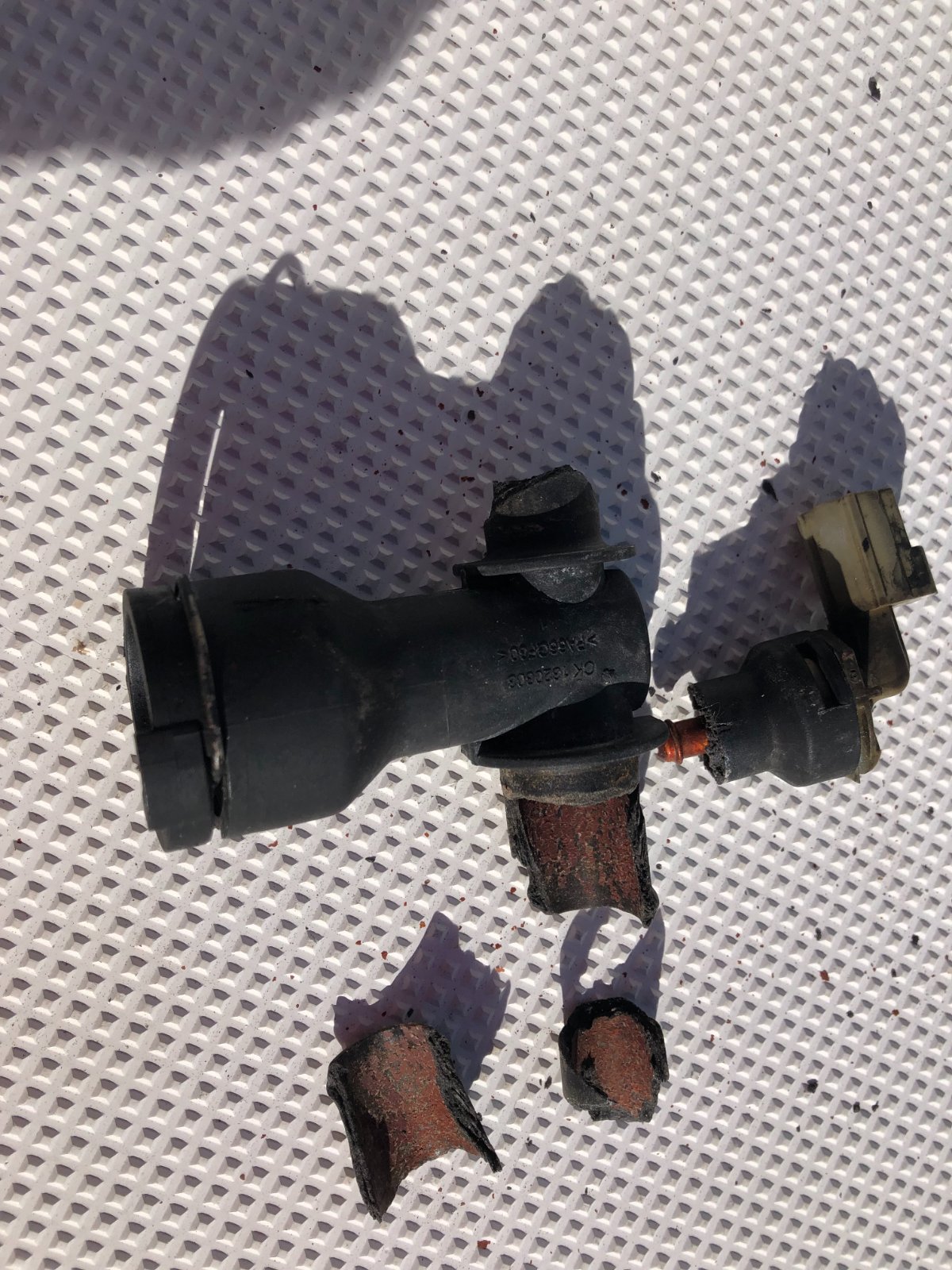

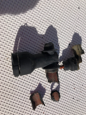

I cut the plastic retainers (why did they not just use spring clamps ?) off the old pipe to see if I could reuse them only to find a) thermostat broke offand b) the rest of the plastic was so brittle that it just fell apart when I pulled the pipe away.

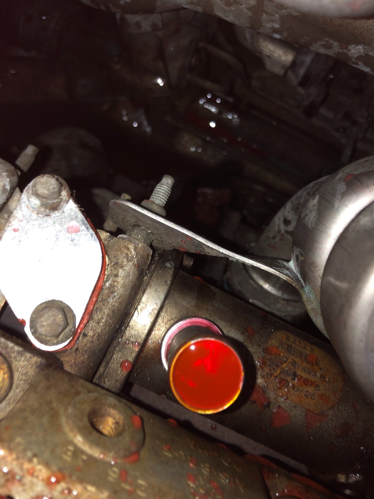

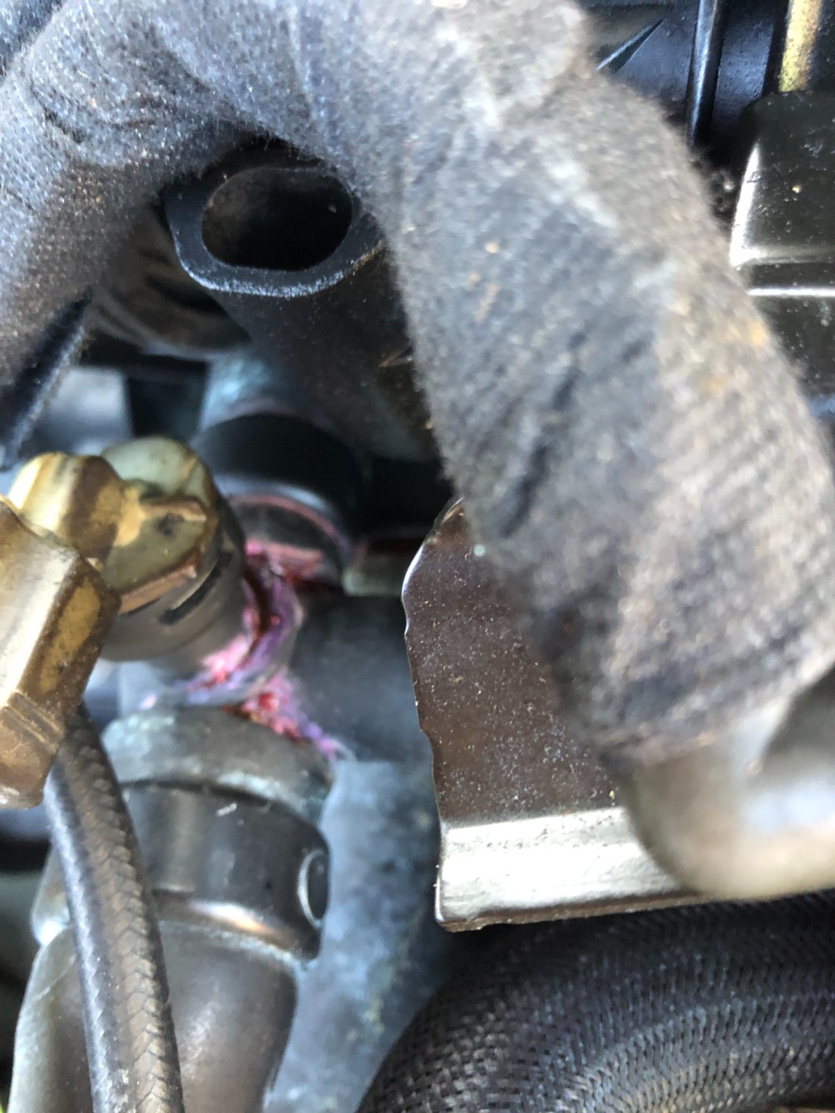

It took around 2 hours to fit - most of the time was spent trying to clamp onto and open the rear EGR cooler spring clip which is nigh impossible to reach / get any sort of pliers around.
I finally found a small set of adjustable pliers that would fit and not get pushed up against the fire wall, and then promptly lost them behind the engine somewhere.
At least the new 1351KT pipe comes with preloaded spring clamps that you just fit and snap the yellow retainer off.
