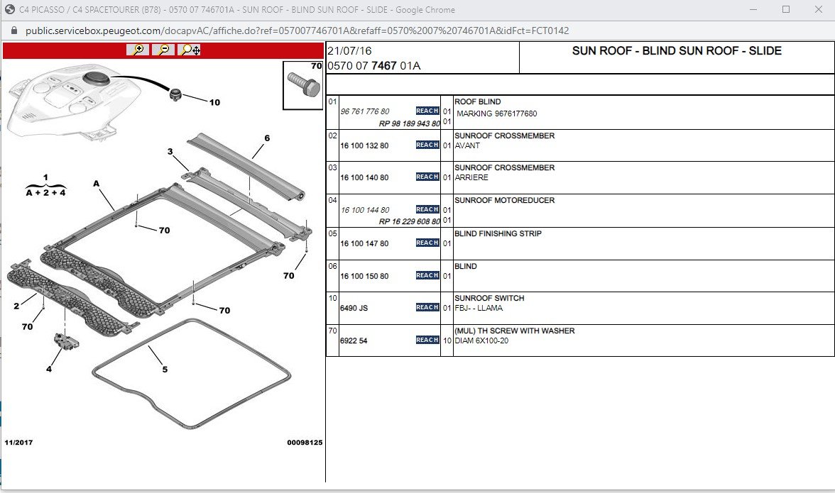

Re: Panoramic Roof Blind Motor
Appears to be in the front console part:
£267.65 from Citroen!!
No idea how you get to it, you probably have to dismantle all the visors to get to the motor, I might be able to find a procedure later.
I'll put the latest procedure in the members resources section Richard. Unfortunately this requires removal of the headlining and some trim to access the components.
@Gioconda: I'll provide a link here when I've composed it.
