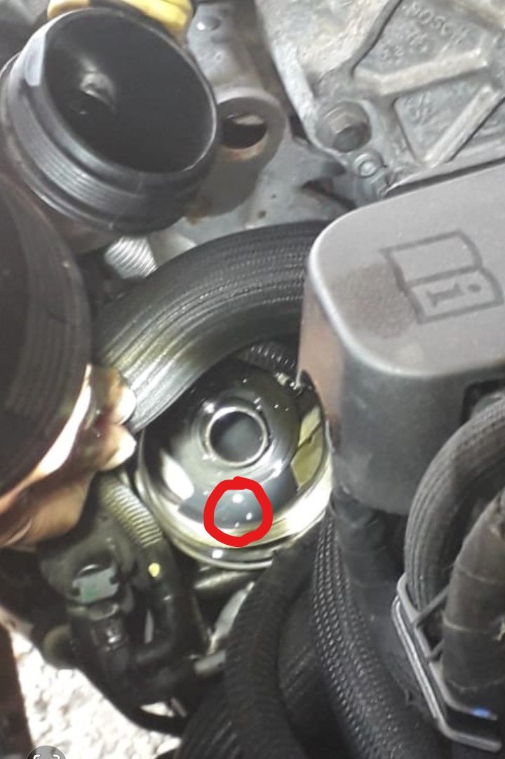

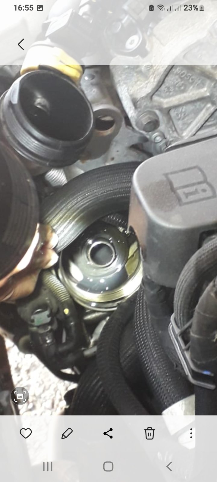

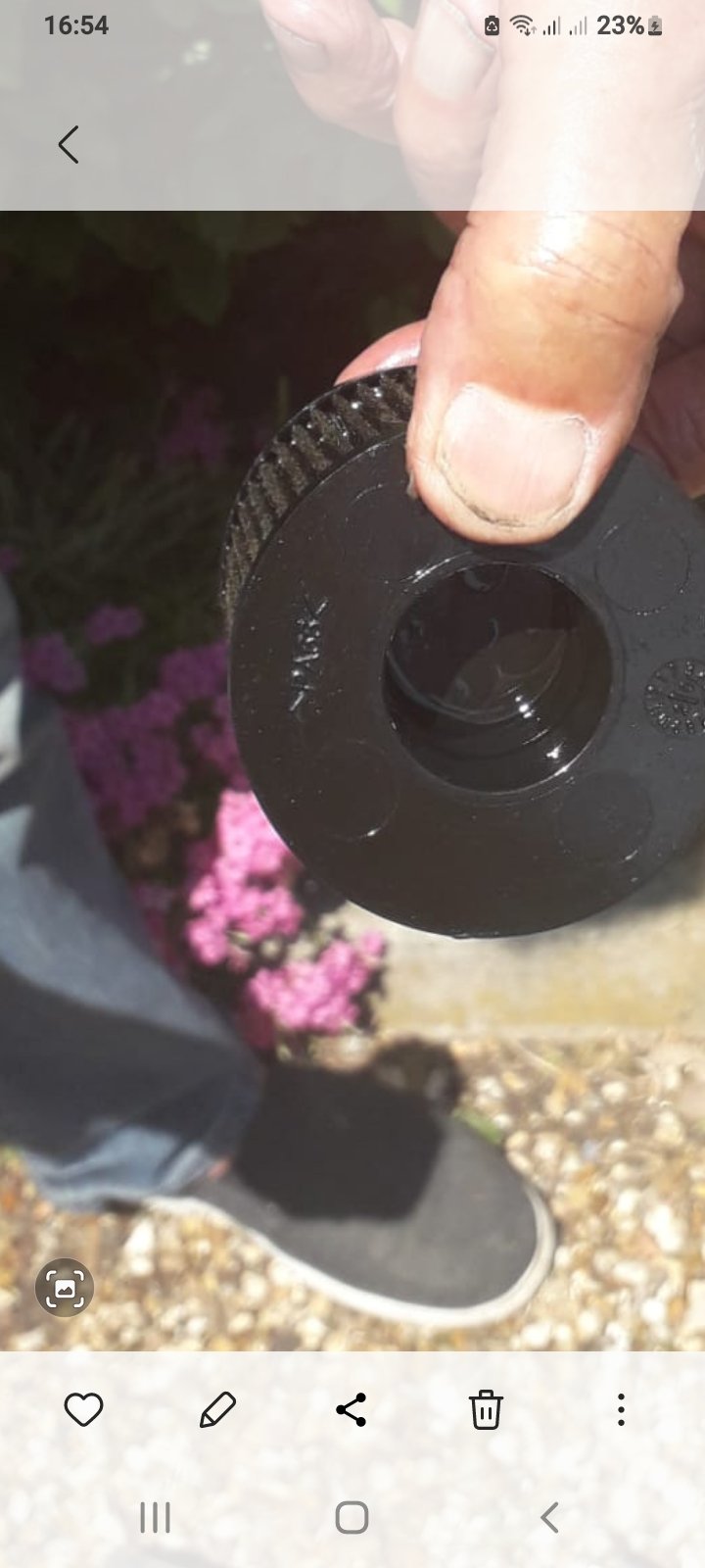

Well, one again i removed the oil filter and lo and behold after a very close inspection i discovered that part of the old filter had broken away from the filter itself and had stayed in the filter housing thus blocking off the location hole .
Thanks to wheeler who spurred me on to take a closer look this morning.
So i did have the right filter but am amazed that a part had come away from the old filter , i note that the new filter does not have the part that stood proud and broke off or came unglued .
Problem solved .

Re: Oil filter problem
The filter with the lug/seal is not too much different to the one on our 1.6 hdi Cactus. I think the idea behind it is when when the filter cover is being undone, the filter moves out with the lug and oil in the housing drains down the hole to minimise the mess when the filter/cover is removed. When the new filter is put on, I think it should be put in the housing first so the lug is in the drain hole and then the cover put on. However, on the Cactus I have put the filter in the cover first a couple of times but find it a bit tricky to make sure the lug goes in the hole. If I had messed it up though I think the oil pressure would be low
