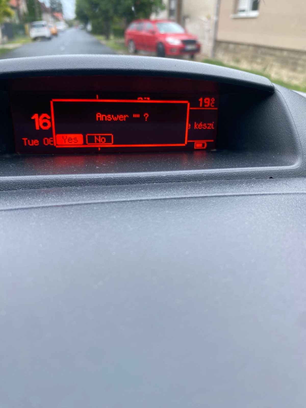

Hi guys,
The factory rd45 radio does not show the callers name, when somebody calling me. After I press “yes”, on the display I can see the name of the caller, as it saved in my phonebook….
But I dont know before, I wanna answer or not.. :))
Originaly was a rd4 in the van. I swaped it to a rd45+screen type c.
Berilngo 2010 Van.
Thanks any help!!!
Zsolt

With Iphone 11pro and iphone 13mini either not working.
Strange, during the call, if somebody call me, it show the caller’s name!

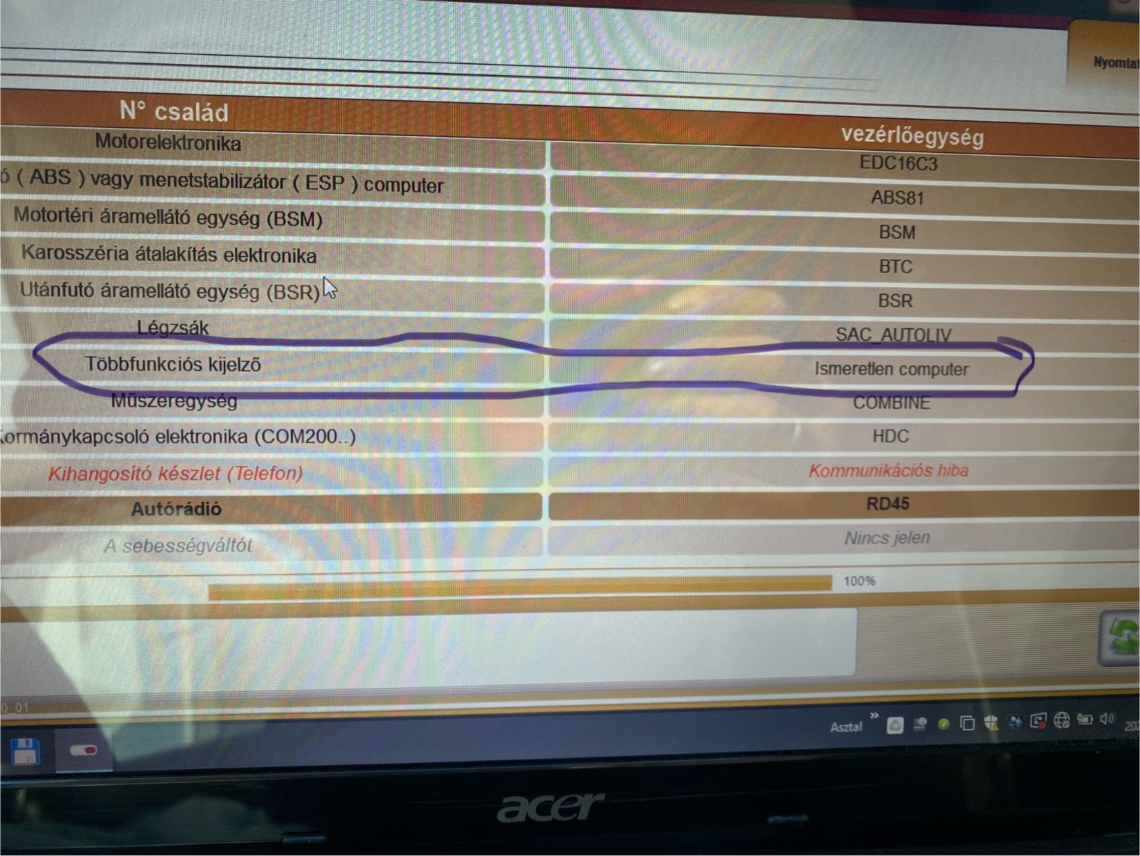

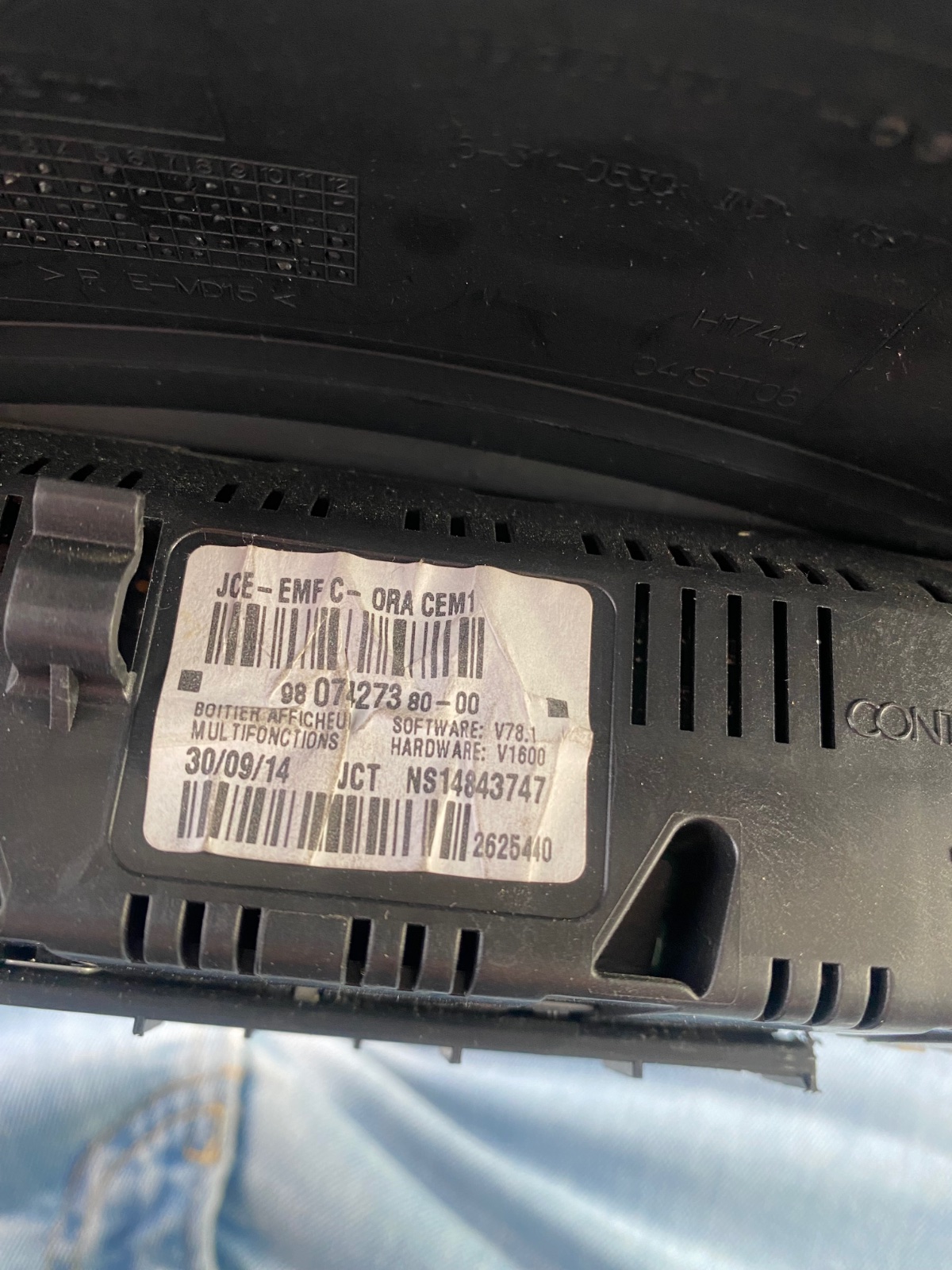

In the Diagbox, on the list of the begining, “Multifunction display- unknow device”, why is that?!
The display works great, it seems the BSI can not recognize the display. The van is a 2010 model, the second hand display is 2014, could it be the problem?
Thanks for you help… it makes ne crazy😂🤦???
shtu
Posts: 270
Joined: 09 Dec 2023, 16:19
x 81
Re: Rd45 callers name problem
Unread post by shtu »
156er wrote: 29 Sep 2024, 10:12 In the Diagbox, on the list of the begining, “Multifunction display- unknow device”, why is that?!
Because the van is old enough that it shouldn't have that type C display so diagbox doesn't recognise it properly - elsewhere you'll still see mentions of RD4 (eg in the BSI config)
When you access it in diagnostics, you will be given the chance to choose which type it is. Pick Type C Dot Matrix.
This probably has no bearing on your actual problem though, and I too suspect your phone is the root cause.
Unread post by 156er »
Thank you for your answer.
Yes, it is only rd4, I can’t see rd45 nowhere.
There is 3-4 diferent options for the display, I can chose “Type_C?”, but nothing changes.
I can’t see any options in the phone, so have no idea what else can I modify.
Thank you!!🙂
