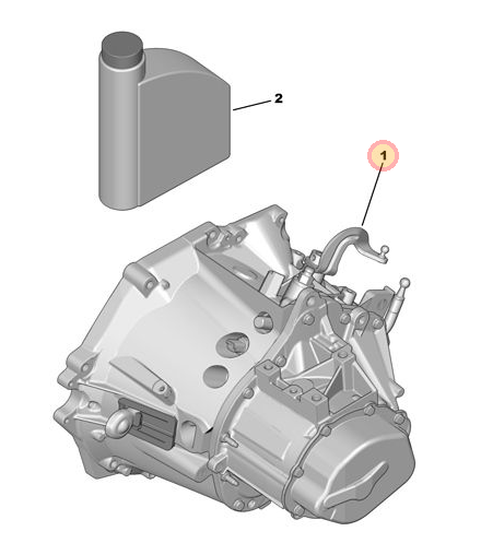

Re: Gearbox Code
Thanks for your Forum donation, here is the gearbox info:
(1) Gearbox
Original New Gearbox, CP 17X71, (Marking DP76, DP63, DP33, ET07, DP96 (ETKG)), part: 1608935280, £6920.08
Standard Exchange Gearbox CP 17X71, (Marking DP33, DP6C, DP3C (DPF3)), part: 1607745980, £2586.54
All prices inc. VAT and direct from Citroen.
The gearbox has gone through some part changes, so these are the correct part numbers.
I can find no reference to '20DP33' as of today listed on official parts, so may have changed with the replacements.
At least with these part numbers and the correct markings, you should be able to source an alternative by googling. Just enter the part number in your search engine without anything else:
