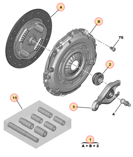

OK, so I can only help with Official part numbers and the alternatives that Citroen provide for this vehicle:
(1) Pro Clutch Kit, part: 205316, £594.42
Standard Exchange Clutch Kit, part: 205809, £315.10
Note: item (1) contains A, B and the Clutch Release Bearing (2)
(5) Declutch Fork, part: 9808513380, £60.48
(15) Clutch Centring Device Kit, part: 1606269680, £14.80
All these are available direct from Citroen and include VAT.
