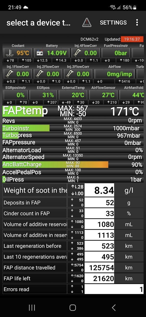

The trip went just fine. Before it, I took another go with Diagbox. I discovered another error in the Particulate additive filter section. It said that my tank for additive is empty. I have no idea why. I refilled it 3 years ago, and drove about 30.000km since then, so it couldn't possibly be empty. And I did the procedure to reset it back then.
Now, I had to repeat it again, delete all the errors, and car works fine, even observed regeneration using FAP android app. The amount is probably not correct now, but I didn't find option anywhere to enter the amount.
Still, one thing was really strange. Before the latest reset, the additive in the tank was showing more amount then the capacity.
Now, after the reset, and adding the fuel, the amount is 3ml lower then capacity of 1080ml, so pump is injecting the additive.
BTW, that capacity is also strange, for my car and engine it's supposed to be 1350ml.
Any thoughts on all this?
